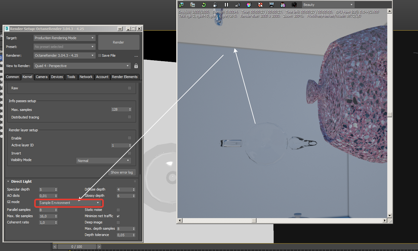

why in GI mode Sample Environment works AO !!!! previously, he was disabled ... if you don't plan to turn it off take the opportunity to get AO to 0 or to set it opacity
( simple example - I made baking texture of the wall and consider a quick direct renderer - I don't need AO and I can't turn off on beauty)

@Goldistart
Hi Goldisart,
Yep, I had already asked to developers yesterday to remove obsolete GI parameters.
Regards
Paride

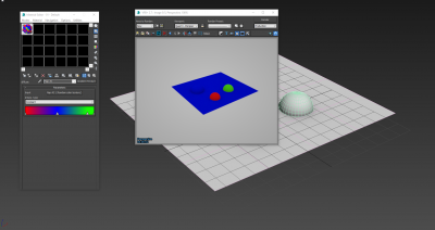

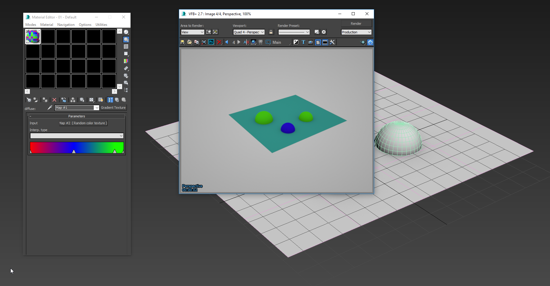

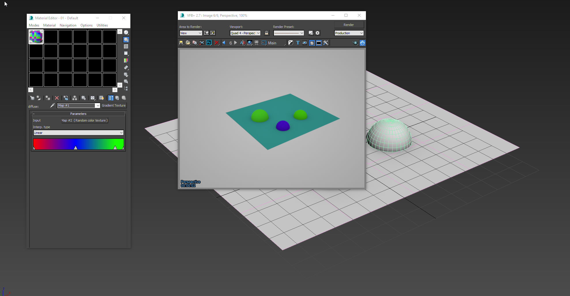

Hey
Seems like the GradientTexture node broke in this update.
If you make a material and add a gradient texture, change interp to constant.
Save the file, and reopen.
Now the interp dropdown will be blank (White)
And white is actualy "linear" see the photos.
So what i did in this test scene is.
- Open a new 3ds max 2016 sp3 file
- create a plane and 3 spheres
- create a diffuse octane material with gradient texture in diffuse slot, with a random color texture to disstribute the colors between objects.
- Set the interp type in gradient texture to constant.
- render and it looks fine. - Save the max file and reopen it.
- Now the interp type in gradient texture is blank (white)
- render without changing anything. The render is different. - Change the interp type to linear. you can now see that its the same as blank(white) This is a problem. When sending a file with a shader using constant to the renderfarm will give wrong results.
The workaround will be to add more points in the color pallet of the gradient texture to fake a "constant" look.
Attached maxfile
Cheers
-Mats

Hi stir,
I reproduce your files, gradient map does not work properly as in SA.
I will ask developers to fix this issue.
Thanks for your help.
Regards
Paride
