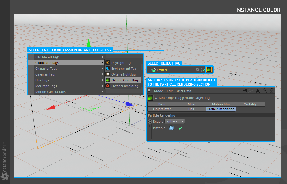

Octane Scatter object can read position from vertices of a polygon object or read from a *.csv file in matrix form. It's a 4x3 matrix with PSR data
or
Use standard particle object with object tag's particle rendering option.

Sorry Ahmet, It's a bit embarrassing because i feel so stupid but let's try it.. :oops:
I don't find a "Standard particle object" in c4d. can be Simulate>Particle>Emitter?
I don't understand where i have to load the point cloud file (.las/.pts/.e57)
:shock:
Posts: 16068
Location: Türkiye
Yes via Emitter but don't know how can you import these.

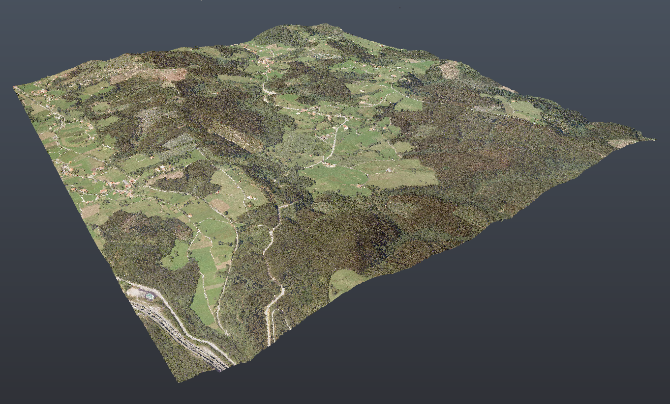

Just to clarify.
I don't use csv files because they lose the colour information (RGB) from the point clouds.
salmon
Posts: 42
Joined: Sun Jun 30, 2013 3:50 pm
as you see in the image, the colour is crucial.
why dont convert it to a mesh? Because the resulting mesh size.
Maybe meshes are the only option or
Maybe vdb format can help to use particles with colour?
