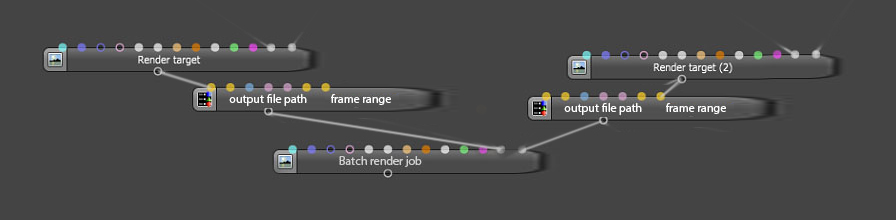

Hmm, isn't the point to make software better? If you do not make things good at start, what could you expect later?
Anyway, even considering your skepticism, node with framerange and output path placed between render target and render job will be better than current situation. Like this:

doca wrote: node with framerange and output path placed between render target and render job will be better than current situation. Like this:
[/attachment]
I guess your example is exactly the "render job group node" option proposed in the first post of this Topic ;) :
- "out file / frame range" = how the current "batch render job"already works ( "output folder" will be added )
- the "batch render job" in your example = "render job group"
But as in the node-flow these nodes are after the render target instead of before, they are more tedious to use.

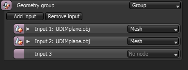

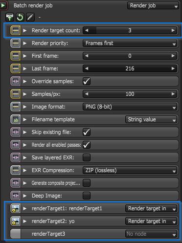

Though, I think there's plenty of room to improve them, for example:
:shock: why this unintuitive way to add inputs instead of the one already existing in the UI for the geometryGroup node ?
Ideally we should have 3 buttons : add input, remove input and edit inputs(open a checkable list of existing targets).
Same thing for editing the Job list in the "render job group node" .

I like this idea of the buttons to add /remove/ edit... way simpler in regards to adding removing nodes; especially with the edit list.

possible improvements :
In the "Render job group"
- add a third button "edit list" giving access to a checkbox list of all "render jobs" in the scene. This is important for quick connection of lot of jobs.
In the "Batch render job"
- replace the "target count" by the same feature as in "group job": 3 buttons "add" "remove" and "edit list"(quick connection of lot of RTargets).
- need better arrangement and sections for the pins, seems kind of a random list at the moment,
also sub script node for logical group of pins (e.g. all format relative) would reduce the number of visible pins in the nodegraph editor.
- replace "override resolution" and "resolution" by "resolution percentage" defaulting to 100%.
- "render priority": "frame first" , "render target first" seems confusing,
what about "render sequence": "per frame"," per render target" ?
The render job graph is just a Lua script graph sitting on top of the render job graph Lua API, allowing everyone to write his/her own render job implementation. Lua scripts can't create an arbitrary GUI in the node stack editor, but only input linkers, i.e. what you are asking for is currently not possible. What is wrong with the setting the render target count for the batch render job graph anyway?
