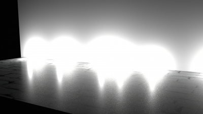

Another weird thing: Hot pix.removal should be set at zero.
Latest OctaneRender for Blender. Windows 10, i7 quad 3.7GHz, 16GB, 2xTitan.
- justavisitor
- Posts: 242
- Joined: Sat Oct 05, 2013 5:34 pm

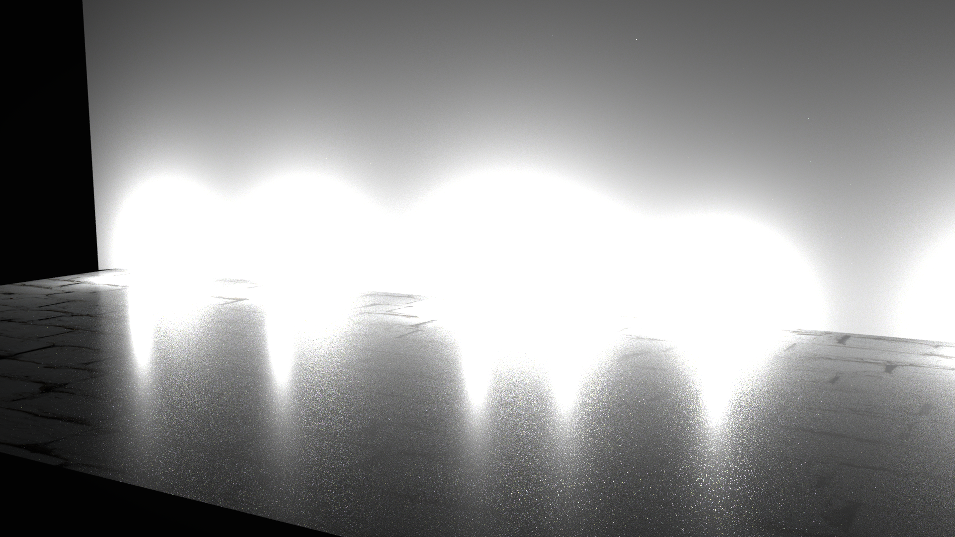

Hot pix. removal at 1.0 (default) and 0:justavisitor wrote:Another weird thing: Hot pix.removal should be set at zero.
However, there's a price to pay in perceived sharpness when you reduce Hot pix removal.
But for animations, for instance, it can be set at zero for frames with many fireflies and increased slightly when details are more important.

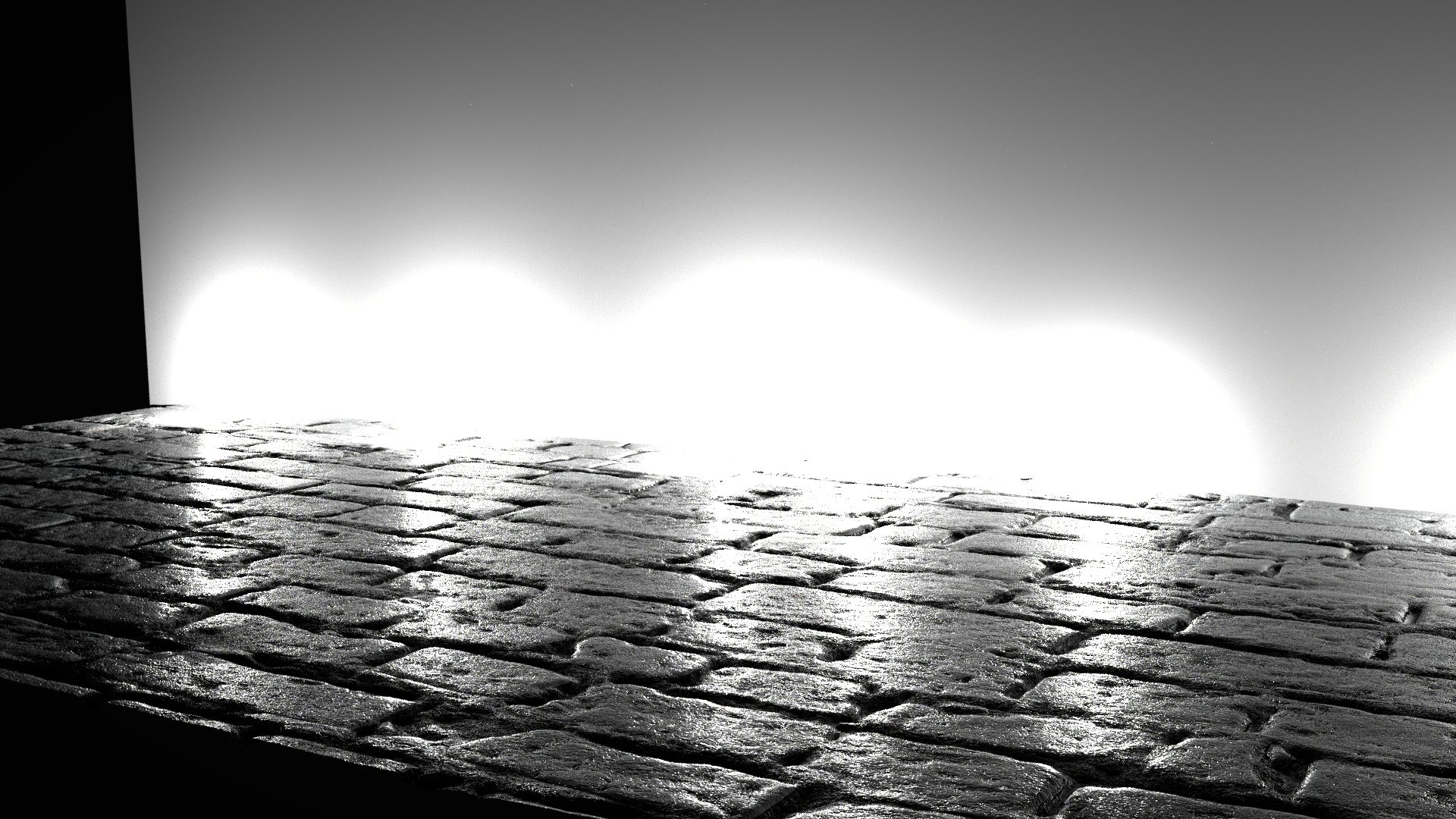

Hmm still having troubles creating this effect. I'm starting to think that it's the textures used instead of the geometry. I doubled the number of lights and increased their power to 1000. I also moved them so that they are very close to the surfaces. The floor surface I'm using a painted brick texture with displacement. On the wall I just have a simple white glossy texture with spec set to 1. If I disconnect the displacement I start to see the fireflies.
But if I add the displacement back in they mostly go away and the flat glossy wall doesn't appear to get very many of them, which is strange?
Can you share the texture with me? Here is the blend I'm using, although I can't share the brick texture as it's commercial.
Oops, forgot to add that both images were rendered to 500 s/px.
Jason
Jason

I don't have textures in these projects - but what you're saying (and showing) regarding displacement is definitely interesting, I'll look into that.grimm wrote:Hmm still having troubles creating this effect. I'm starting to think that it's the textures used instead of the geometry. I doubled the number of lights and increased their power to 1000. I also moved them so that they are very close to the surfaces. The floor surface I'm using a painted brick texture with displacement. On the wall I just have a simple white glossy texture with spec set to 1. If I disconnect the displacement I start to see the fireflies.
About reproducing fireflies; I think the 'easiest' way is to have an object, like a person, in a dark room and then point two or three lights at it like in a photo studio - one strong light from the back, a strong light from the side, and, optionally, a less strong fill-light or just a reflective surface from the opposite side. The fireflies get much more visible if you use colored lights.
But perhaps displacement is the cure.
EDIT: Regarding reproducing fireflies: I'm beginning to think that the complexity of the scene might matter: I tried setting lights on characters in two scenes yesterday: Setup A only has two persons in it, three lights and no environment. Fireflies disappear quickly as I turn down Exposure and increase number of samples to 4-5k. But in Setup B, I have the same characters in a setting with multiple 'centers', each of which with its own lighting, and in that scene I need 10k samples to get a decent image. This could seem to be consistent with kraken's first image in this thread; he's got a large, complex scene with several light sources, and his fireflies are really extreme (I didn't even know what he was talking about at first, I thought the fireflies were some kind of cement structure on the wall).

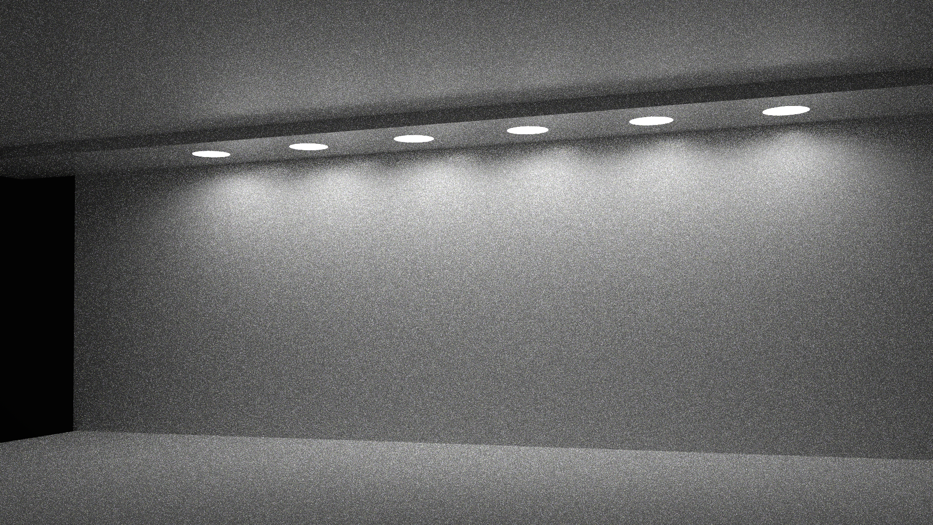

Hi justavisitor,
Looking at your images, I don't think you are having a problem with fireflies, but just noise. Fireflies are usually 100% saturated white pixels. It's probably why you needed to set the hot pixel setting to 0 and as you have seen, when it's set to that it starts to blur the image. Which would start to remove some of the noise. I did another experiment with small lights that were recessed into fixtures. The first image I rendered to 500 s/px with the pathtracing kernel.
I'm not sure that what we are seeing here is hot pixels or just heavy noise. In this scene every surface is glossy except the floor which is diffuse. I then switched to the PMC kernel which is much better than PT for this kind of lighting and again went to 500 s/px.
The noise now is significantly reduced.
So what kernel are you rendering with? Are you using blackbody or texture emission? Are your lights a single plane or do they have a structure?
Here is my example scene, where I use a simple ico sphere and texture emission for the lights. The textures on the other surfaces are just the standard glossy or diffuse textures.
One thought I had was that you could render your scene with more light and then darken it in post. This is what movie directors do all the time if they want to control the noise in a scene.
