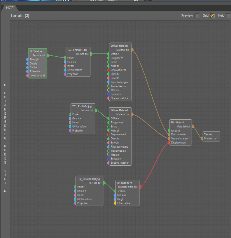

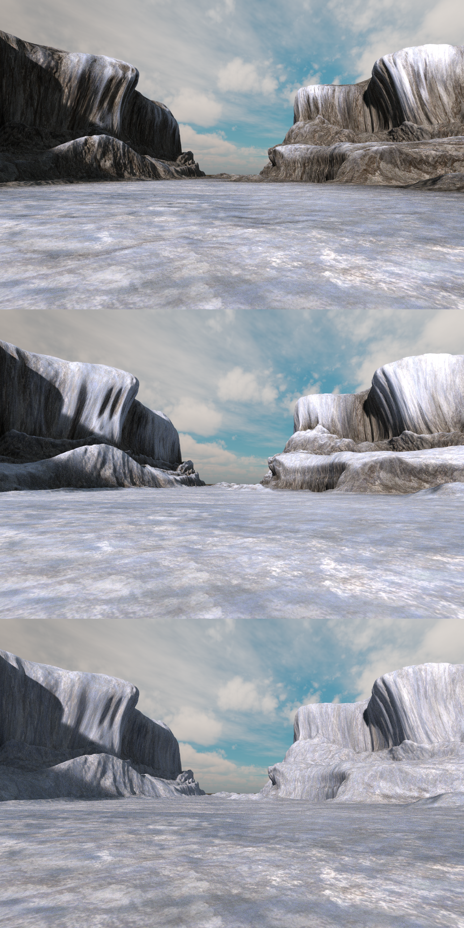

Just in case someone else comes across this thread searching for Terradome3 in Octane, it is well possible.
This mix is still a WIP, but so far I got it to behave pretty well on "snowy mountains" as well sand over other terrains using a mix material and a dirt texture.
Amount of dirt texture will behave the same as Blend in Colm and Traveler's Iray node.
Hope others find this helpful
