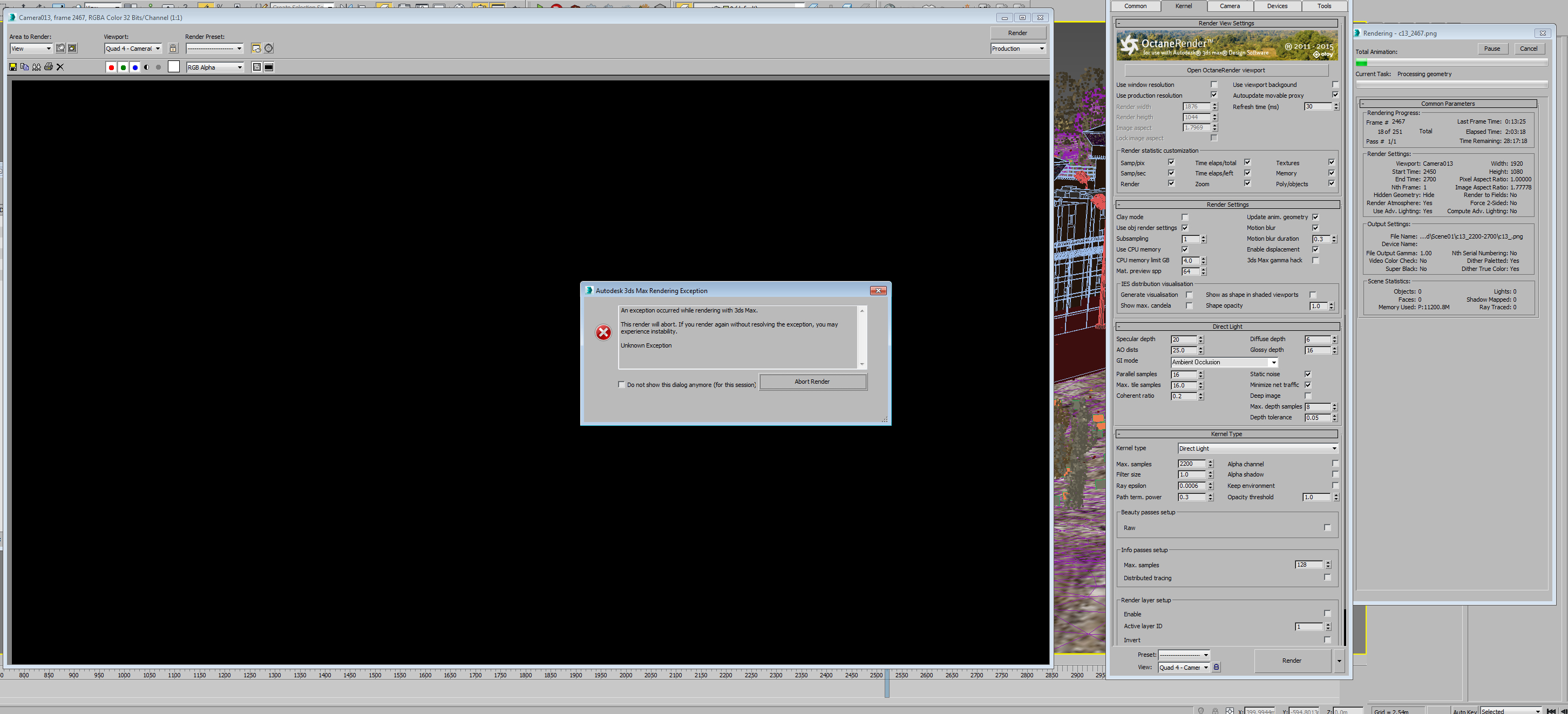

coilbook
Posts: 3162
as soon as I read your message I got this. before it would freeze up like it is almost finished rendering a frame, When i closed the window max just closed. We never had this before
