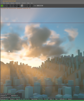

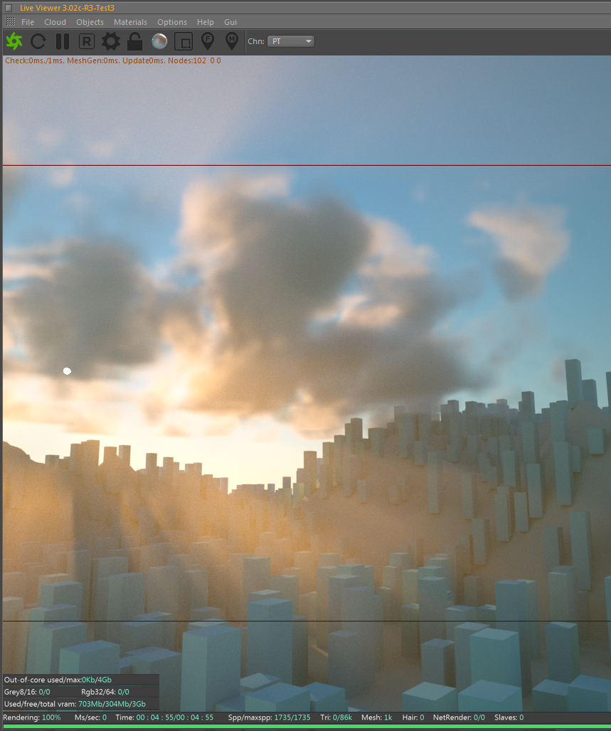

That's greatly working on me. See sample scene. Pay attention to medium parameters. Set thickness as big around scene bounding box or effect distance.
If you need more dense volume so make the thickness smaller and medium scale higher.
Thanks Aoktar. I can see it working.

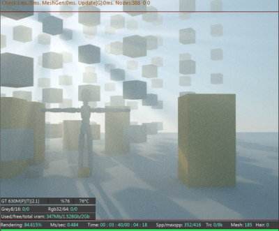

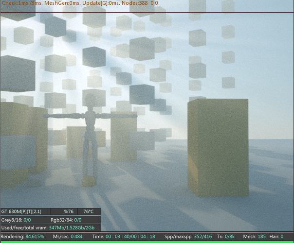

Another one. It has a few different tryouts by daylights.
