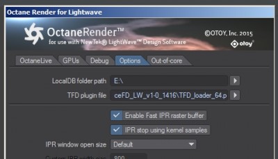

I pointed to my TFD plugin in the options panel.
I have noticed that in the options panel "Enable Fast IPR render buffer" is greyed out so I cannot change it. - not sure if that matters.
I am fairly new to Lightwave and very new to octane (after years of using Maya, then C4D for payed work, I have chosen Lightwave for my indie film due to cost) so it may be something simple that I am missing, but I have followed the few sparse instructions that I was able to find online (in this forum thread) and still have no luck with volumetrics in octane.
I am running TFD 1-0_1416 - could this be an issue since octane was compiled with 1414

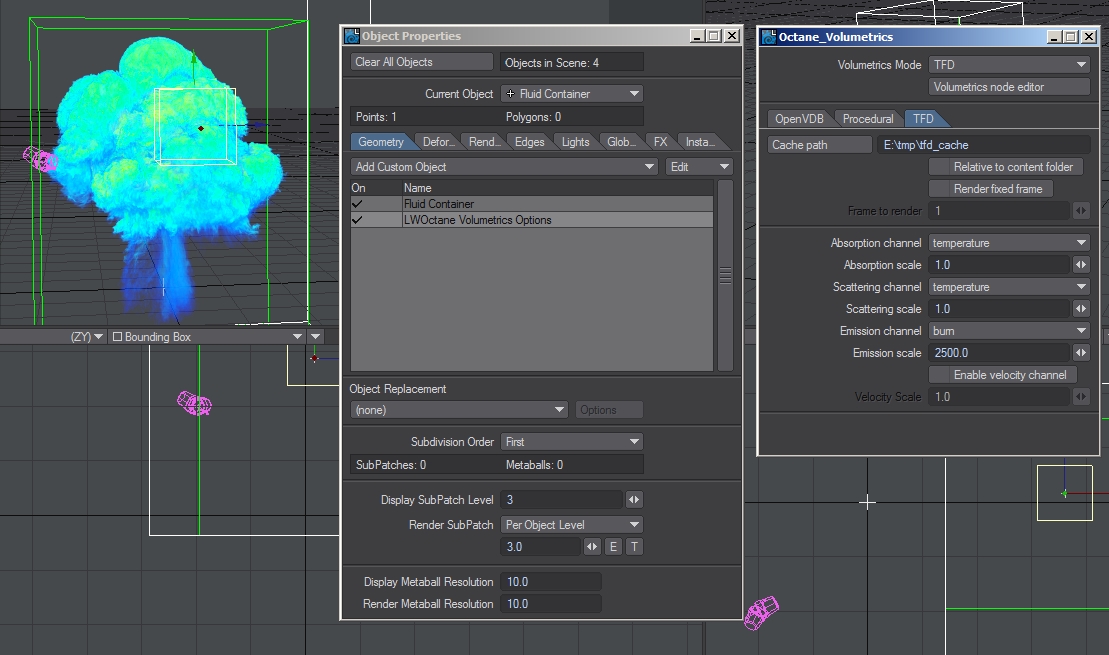

I added the Octane_volumetrics custom object plugin to the TFD container object - changed it to TFD, set the cache path, I linked the volume medium to the volume custom object node.

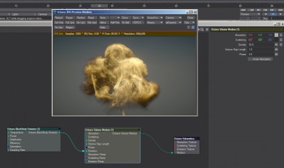

Well, work with TFD in LightWave and Octane is fairly easy.
First you need to configure in the plugin options panel the path to the TFD plugin.

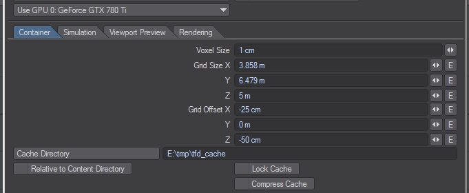

Later you need to compute the TFD simulation. The plugin is going to use the TFD cache files to extract the volume information, so you must set a known path to store the cache files.

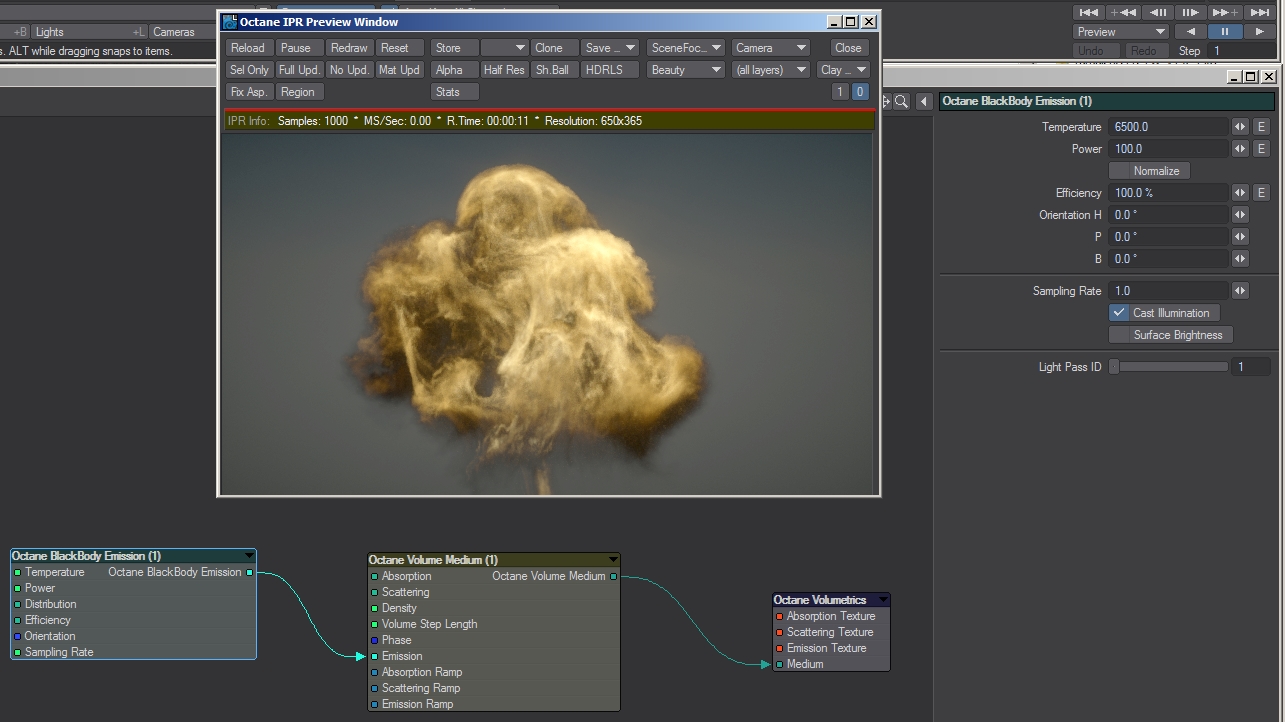

Once computed, you can add the Octane_volumetrics plugin to the container object, set the volume mode to TFD, set the simulation cache path and configure the grids information. The key here is to understand tha the black body emission node while working with volumetrics is going to get the color temperature from the emission grid, so the emission grid must be scaled to store values in a range of 2000 to 7000, than can be used as color temperature.
Finally you only need to edit the volume material, using the volumetrics node editor. Be aware that the "Normalize" option in the blackbody emission node must be always disabled while working with volumetrics.
