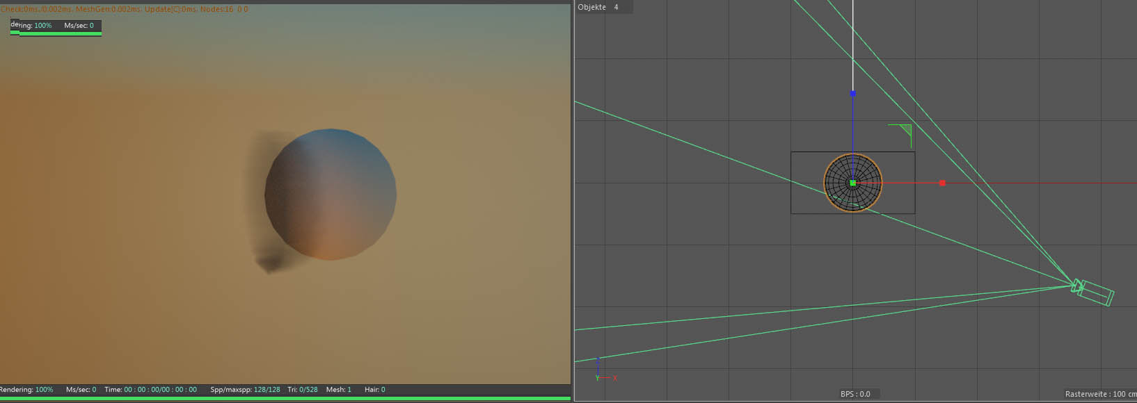

you're welcome. I have changed volume object for having two different behavior. 1-Volume generator 2-Vdb loader. I think old setups are corrupted due this. I'll check it.dinf wrote:Hey Ahmet,
thanks alot for Beta 2!
The linked example file called houdini-explosion.zip contains a C4D file without a VDB volume object.
Instead, there is the (new, experimental?) standard volume object with a noise loaded.
Is it interesting to load the Houdini VDB sequence or parts of it up to the web?
If so, what would be the reason Otoy does not?
Nevertehless, thanks for the demo file. Seams to be a standard explosion setup, with no transfer of velocity vector data for motion blur.
About the new volume object: one simply drags any object below the volume, is that right?
If so, is there a way right now to center or position this object in the "domain"?
Mine will always move to an edge.
Vdb sequences are very big for quality outputs. So i haven't consider to upload it. Someone can re-simulate via houdini scene file.
I couldn't get the last question. Any images?
- Attachments
- a1.jpg (23.96 KiB) Viewed 6995 times
Hi aoktar,
i guess this is wthat he meant. I got the same behavior here. I know, disabeling the sphere will make it invisible. But the Fog seems to be centered at the edge of the FogVolume
The editable sphere is a child of the Fogvolume.
Daylight, camera, nothing else done in here.
Thanks for this awesome feature anyway
Have a nice day,
Chriz
