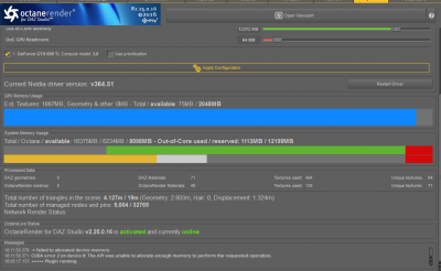

OK, put in my GeForce 650Ti. Set the out of core to just over 13gb. Started with bed prop. The G3F, then her hair, Then G3M, Then his hair, and boom. Rendering after each addition. Got the render engine failure again. Checked the 4 boxes you told me to. Attached is a screen shot. Explain this BS please. I know my 650Ti GPU is good.

That is a totally different Octane error to what you reported above. This Octane error is saying you ran out of VRAM. You've got 16GB CPU VAM, but allocated 13GB of that to out-of-core - try dropping out of core to 4GB. Regardess, a 2GB card might simply be too small for a scene that size - given DAZStudio and Windows will use a lot of that 2GB.
Also - you have Displacement mapping on that render. Try removing those maps - if the displacement amount is too high it will cause Cuda errors.
Paul
