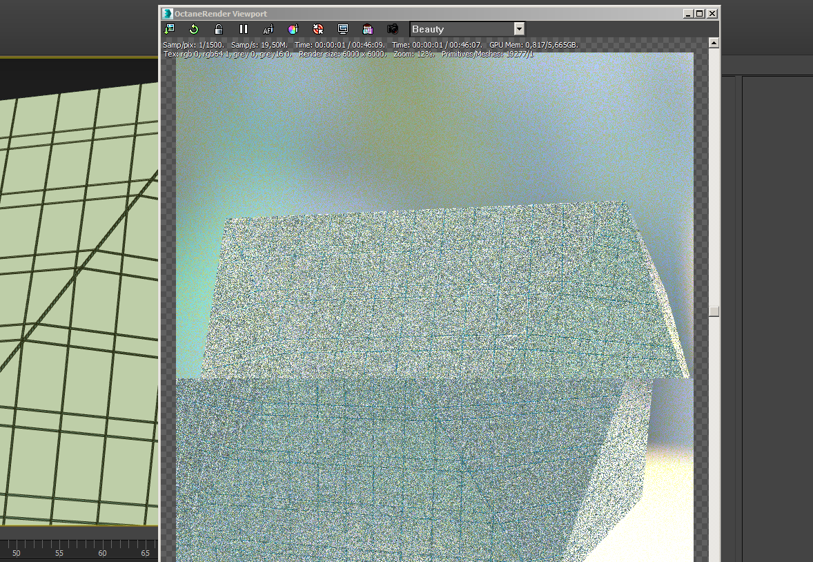

last 3D max crash when I translated 6000х6000 picture from octane viewport render in 3Dmax viewport
So, if I understood correctly - a crash only happens sometimes only when you transfer the image from Octane render-viewport to 3ds Max viewport? If yes - it may be something related to the workaround I was forced make to overcome the 3ds Max bug where it screws up the alpha channel sometimes. I will check it on Monday and make a quick-fix release after I find the reason. The scene where it is reproduceable is welcomed - 'cause I never had such a crashes when I tested this workaround before this release... So may be scene-related somehow...
Goldisart
Image-tearing when you e.g. rotate the view is expected in current version - this is a sacrifice to improve the interactive rendering responsiveness and render speed in this mode (among other improvements in this regard in this version). I could eliminate image-tearing but it will decrease a responsiveness and render speed slightly.
The thing is: if you want to always get a whole image in every frame during each on-the-fly scene change - it needs to be done synchronously, blocking the GPU rendering threads for a while every time a whole image is copied into the Octane viewport (that is - many times per second). In this case the GPU rendering will be interrupted several times a second, the rendering will be stopped for a time the image is copied, and you will see a repeating decreases of a GPU usage on a GPU usage graph (saw-like graph)...
So, just decide what is more important for you. If this image-tearing really drives your nuts - I can eliminate it in next release but it will cost some Octane viewport responsiveness and render speed decrease in Octane viewport mode...
Goldisart
