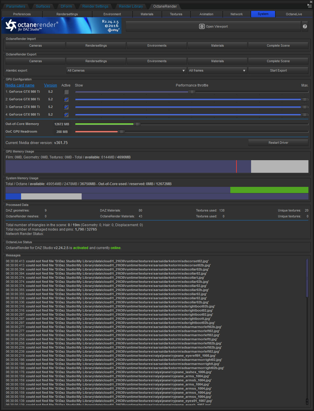

For what it's worth, your G3F test scene in particular fails to work for me, regardless of Daz Studio version. In my older 4.9 beta (the last one right before they released stable 4.9), It looked for everything in "D:\Daz Studio\My Library\data\cloud\..." which is nonexistent on my setup. Simply failed to load any of them (even though I have the same files in my standard, assigned runtime directory). Daz Studio itself loaded the materials from my external (non encrypted, if that matters) runtime just fine, though.
Interestingly, in 4.8, for each object referencing a new location, Daz Studio itself pops up the "Could not find file:*" prompt, asking me to locate it in said runtime. Daz Studio itself is looking in "D:/User Library/runtime/textures/*" file path.
4.8 test scene load.PNG (5.5 KiB) Viewed 13842 times
Which seems really odd, since Windows uses '\' not '/', the only part of that path that actually exists (assuming the prompt merely displays the wrong character) is "D:\User Library\", and once I locate the first texture, it has no problems until it gets to a new object looking in the same nonexistent folder. I suppose the last one is somewhat expected, since I don't think it ever occured to Daz to program anything flexible enough to actually remember your last runtime location used or anything until quite recently. That would make too much sense, honestly. OcDS loads same set of errors, regardless of version, with same nonexistent location, so the absolute path appears to be saved with the scene, regardless. I could see why that makes things tricky with sharing materials and such.
Ah, this was tested with v.2.24.2.5 of the plugin for both Daz Studio versions, for the record.

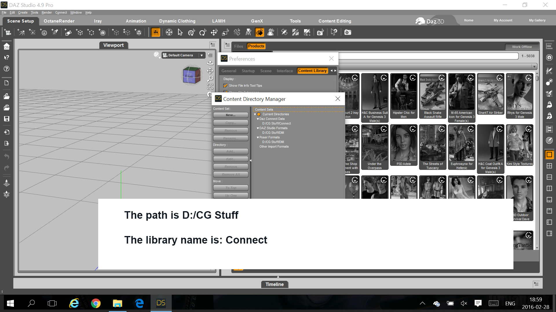

I checked with my laptop to see what I would get there when I use a complete random path and library I certainly never used before.
Then I created a Test Scene "Vase" from Genesis 2 Starter Essentials:
The path used for the textures when creating the scene and saving the duf was:
D:\CG Stuff
The library name was:
Connect
D:\CG Stuff\Connect\

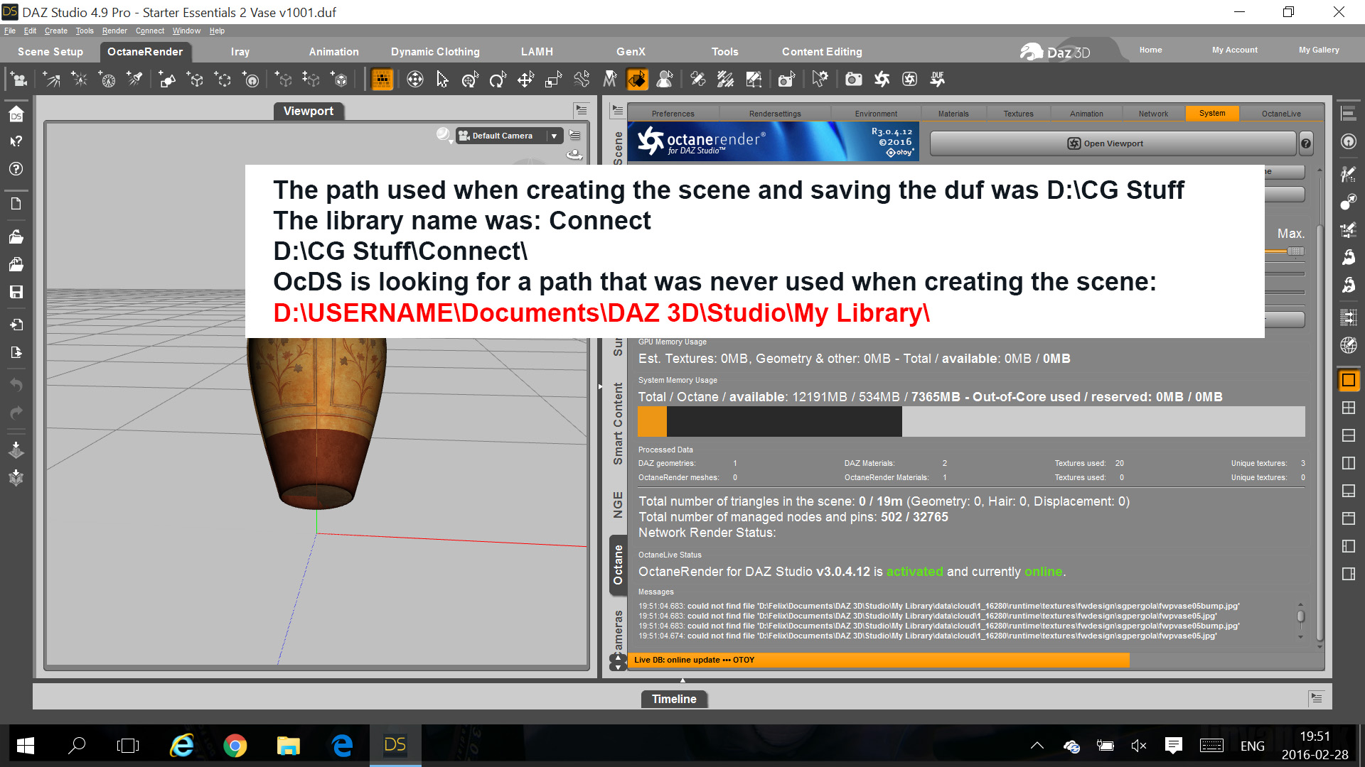

When loading the scene OcDS was looking for a path that was not used when creating the scene:
D:\USERNAME\Documents\DAZ 3D\Studio\My Library\
On my first test I was not so sure where the D:\USERNAME\Documents\DAZ 3D\Studio\My Library part was coming from because my actual path actually was similar while only the library name was different.
Now it seems at least clear that both the path and the library name I actually used were not referenced.

As per the bug report, dzApp->getContentMgr()->findFile() is not working, so the plugin is defaulting back to dzApp->getContentMgr()->getDefaultContentDir(), and that second call is what is returning the foldernames that you are seeing.
Paul

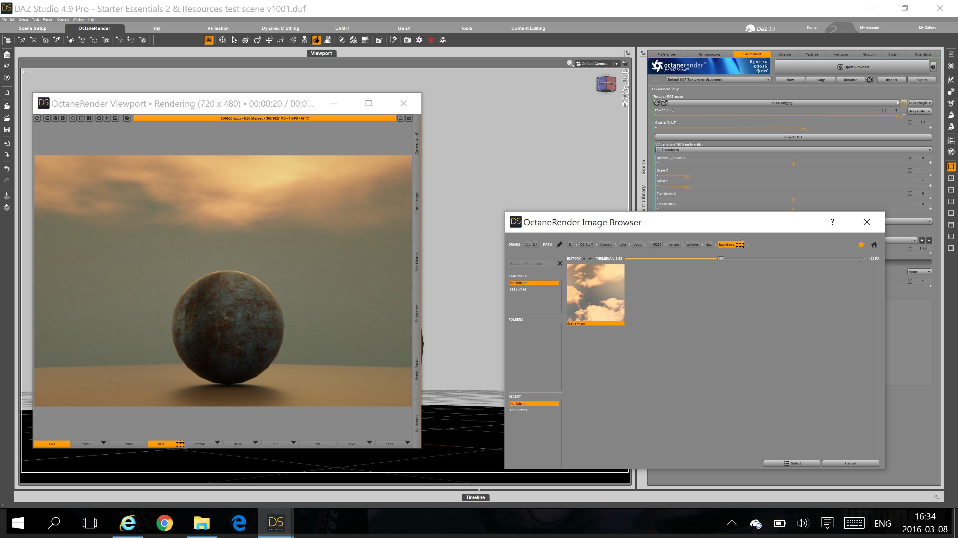

The build below implements the work-around suggested by Daz3d to resolve this issue. It works in my testing, however it will require a more thorough test by users to ensure the fix does not break something else. Pls let me know your findings.

I read trough the post on the DAZ3D developers forum. It seems currently library and base directory definitions for DAZ Studio are in the process of receiving some updates.
Thank you very much for already providing a work-around!
As far as I was able to test the scenes that loaded with materials missing now load properly.
Tested with:
- DAZ Studio General Release 4.9.0.63 - content installed with DAZ Connect
- OctaneRender_for_DazStudio_3_0_6_16_Win64
steps performed:
- loaded test scenes posted in this thread on laptop. -> scenes that did fit VRAM did all load with textures.
- created a new test scene based on Genesis 2 Starter Essentials with texture locations in DAZ Connect and resources directories
> textures did load
test scene with Starter Essentials 2 and resources
I am currently out of town and only have access to a laptop with 2GB VRAM.
Please others help testing...
Starter Essentials 2 & Resources test scene.zip
.duf Starter Essentials and Resources test scene in .zip
(33.18 KiB) Downloaded 315 times
