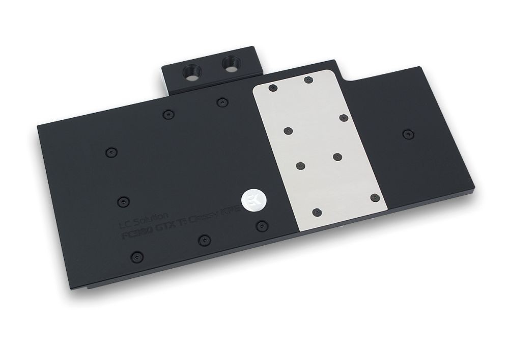

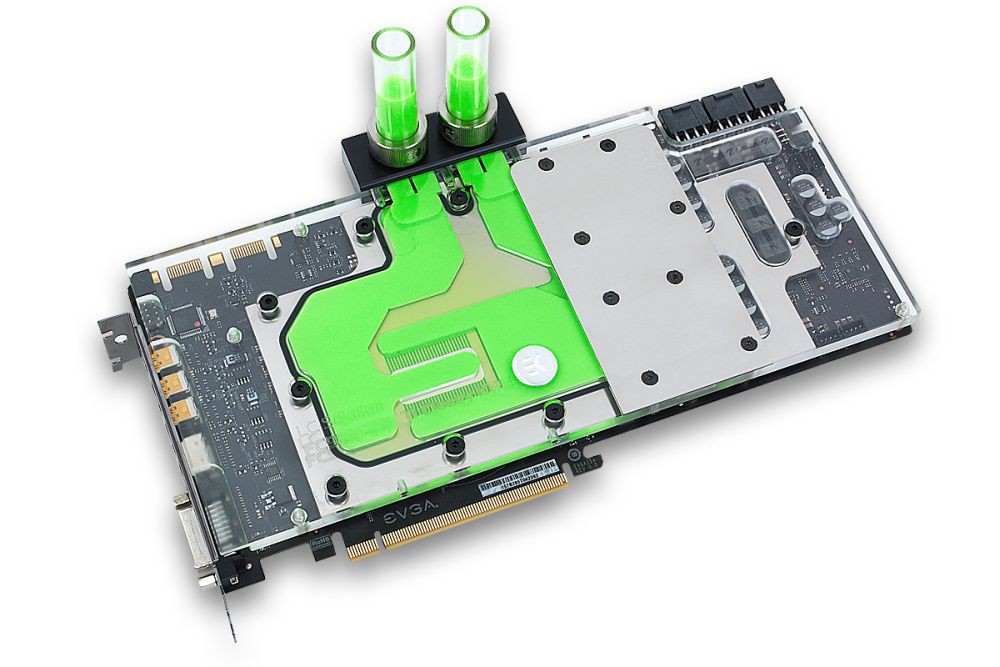

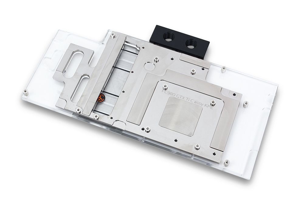

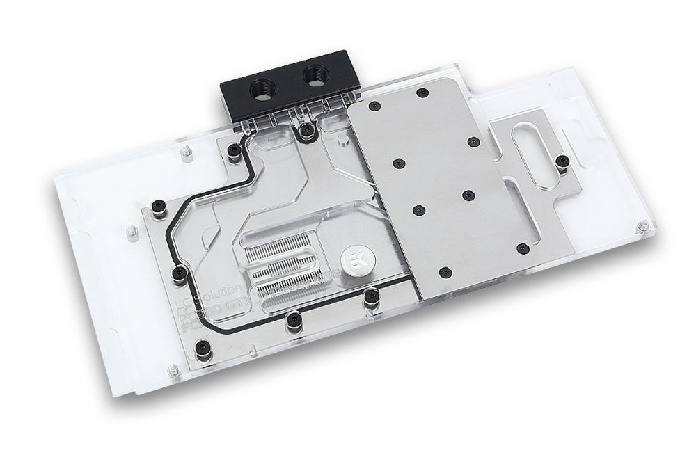

on thing to note =) by hardmoding GPUs to single slot You loose all warranties =) as You cutting out one conector..
if that would be not up to Your taste, You can look for K|NGP|N edition 980Ti (as it has all conectors in a single row) & waterblock from EK - this would allow to to get single slot solution much mroe simple & still keep all warranties.
however..GPUs do not fail that often & if done right that single slot mod is not so risky =)
latelly converted 4x GPU & they work without any issues what so ever.
here's the waterblock (attached bellow)
but..those GPUs might be hard to find as EVGA sells those in limmited quantities =)
