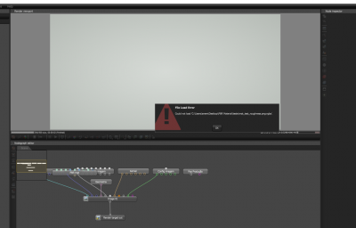

Thank you for upgrade this essential script, but im having problem to load all maps to create each material. My workflow is using Pixplant to export all the maps and then import to octane (if you guys have another suggestion to create in a quick and easy method, please advise me : )).
But when i load the first map, right after "ok" i receiving a messsage that the "_roughness" cannot me loaded. I´ve attached the print for the error and created the same material in different ways to see if the map is generated with any problem, but after change some configs in map doesn´t work at all.
Sorry for asking more help but i really need to understand what is happening.

Hi anereton,
the script assumes that all the maps shares the same file format of the albedo map.
If you create the Log window from the Windows menu, you can see that also the Displacement map is not loaded before creating the material: I can add a more evident error message, or think at a way to skip the file format
ciao beppe
ciao beppe

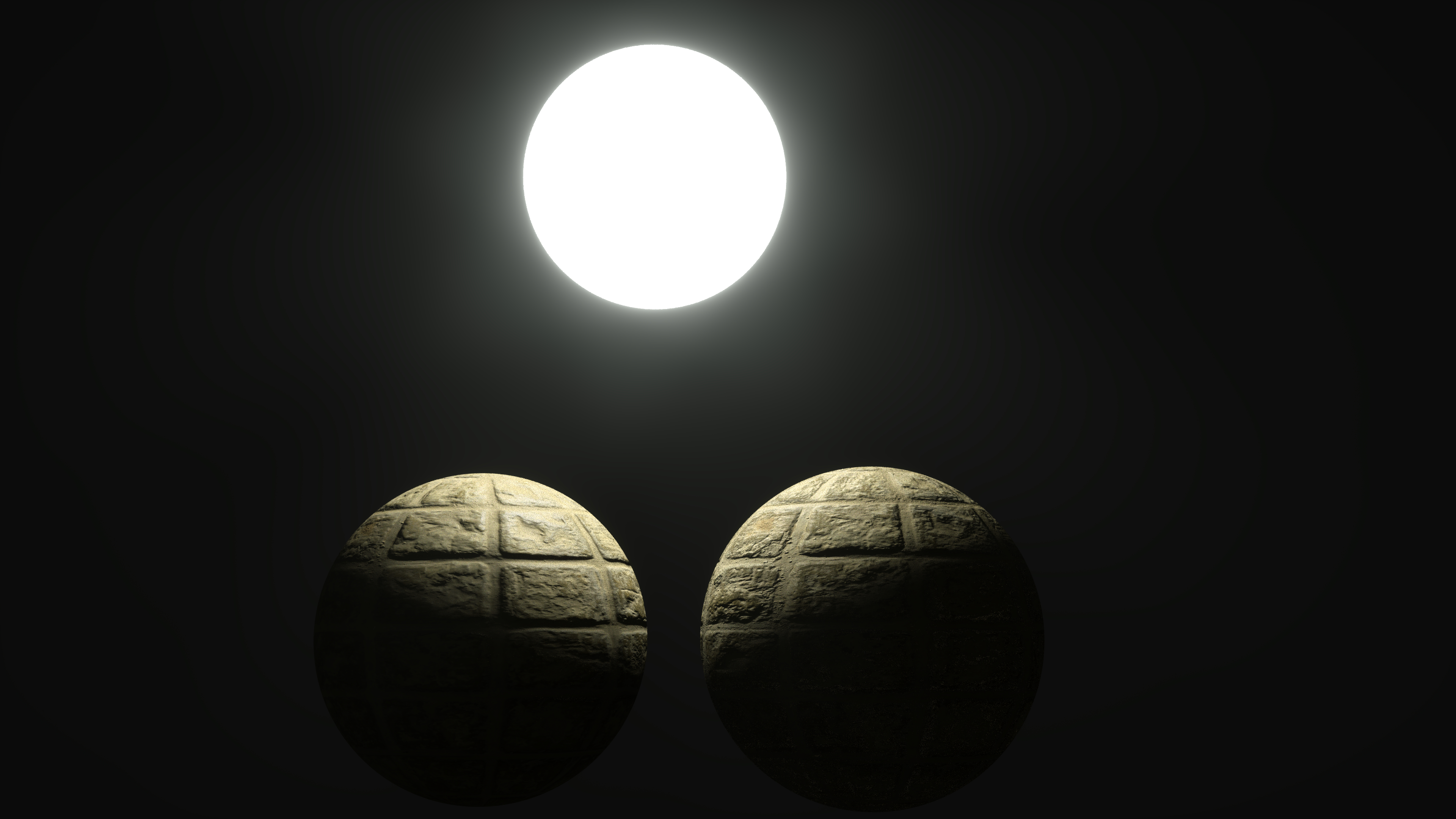

Here is a head 2 head battle with a texture emission diffuse, stopped render at 50 (fifty) s/px, @res of 3840 x 2160:
PBR to left of me, Glossy to my right
Here I am, stuck in the middle with you..

Hi Notiusweb,
since this is only the discussion about the script that is based on QUIXEL_PBR shader from LiveDB, my suggestion is to post your questions in the original discussion:
viewtopic.php?f=9&t=51470
Anyway, if you look inside a material created with the PBR setup, you can see the difference in the node structure, especially for the Specular node.
How can a complex mix material look the same as a single glossy? Or I have completely misunderstood your point?
ciao beppe
ciao beppe
