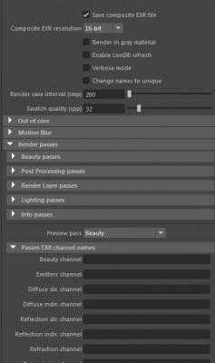

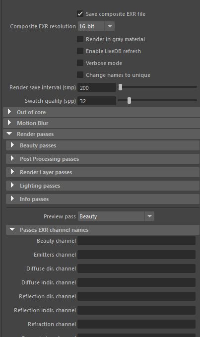

In case you didn't see it, 16 bit EXR and custom naming for composite EXR passes are supported since 7.19 version of the plugin... and this 16 bit float option seem to use some compression.
In practice these 16 bits EXR are around 50 times smaller than 32 bits wiht no noticeable quality difference.
But it comes with 2 restrictions:
- there is no default name for the passes custom names, so if you don't give a name for each passe they are not rendered.
- non composite EXR are still 32 bits only
EDIT: EXR custom defaut pass name now have default.

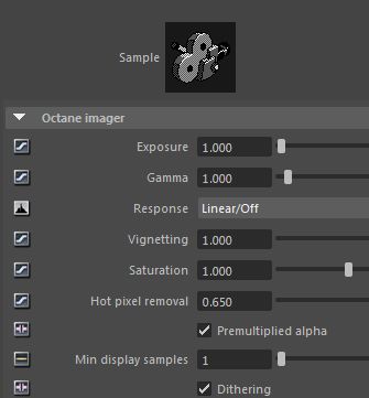

cea wrote:23) Alpha - bug?
EXR images with alpha/RGBA (haven’t tried other formats) has white edge around RGB that should be “cleaned up” with premult - but photoshop etc. is a pain in this area (I’m not a compositor so, but something like that). RGBA should be used straight and not have to be premulted with the alpha to work properly.
After I have noticed this I tried the Photoshop plugin (which don't work so well with versions below 3.0 alpha, right). And there is a premult option on import. So this is not an issue if you use the plugin, but for comp / image software (I can't think of any than photoshop, but anyways) where it's hard to used premult vs. straight it would be a nice to have the option from Octane directly from the Render Settings.
Not totally sure what is the problem here but I see 2 possible answers:
- to have clean alphas make sure to disable "keep environment"in render settings.
- Make sure if you need straight alpha to disable "premultiplied alpha" in camera setting, and if you need premul alpha to enable it.
