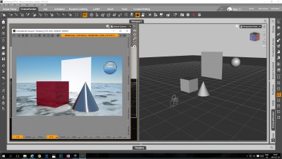

I tried to create a test scene with actual geometry using basic primitives.
Test Scene setup:
use the provided hemisphere with the inverted baked camera to look at a test scene with actual geometry.
Therefore I tried to create a simple test scene with a
- 100m ground plane
- cone 1m
- cube 1m
- display plane 3m
- sphere 1m

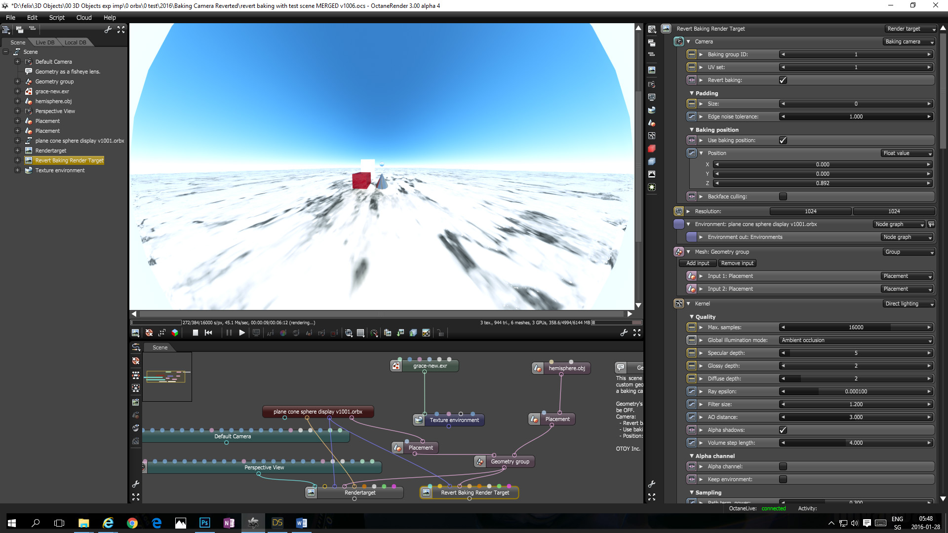

The test scene viewed from the "Default Camera" in the OcDS plugin viewport.
Test Scene Layout v1001

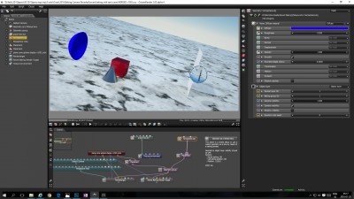

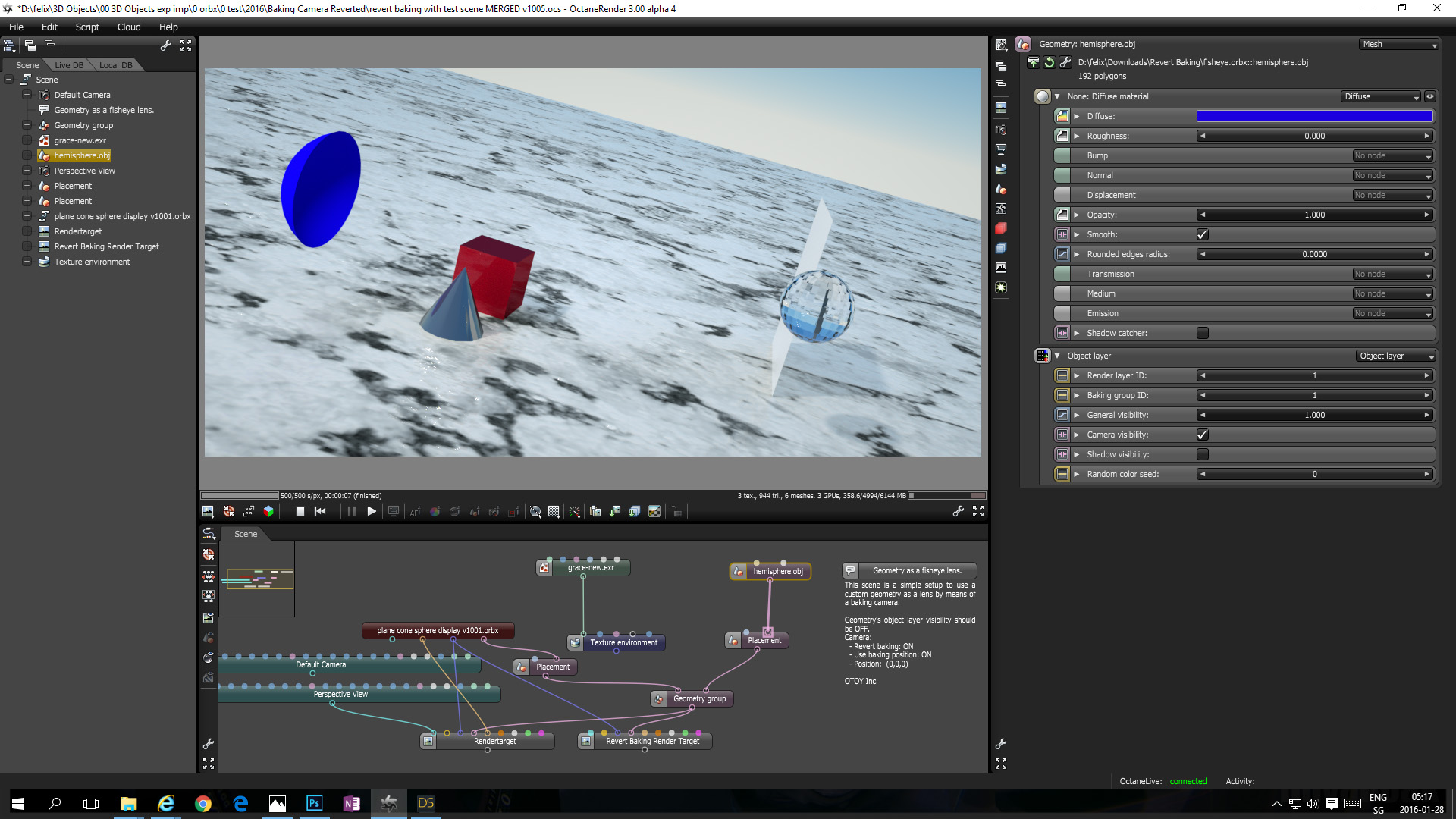

Test Scene imported in OR standalone
I exported the test scene from OcDS to OR standalone and imported the provided fisheye.orbx to the scene as well.
A placement node was used to move the primitives test scene 2m back and 1.5m down so the cone and the ground plane do not intersect with the hemisphere .obj of the fisheye.orbx
The provided hemisphere .obj of the fisheye.orbx seems to be similar like a sphere cut in half.
To make it appear in a perspective view of the test scene I colored it blue and toggled camera visibility on.
Perspective view Standalone - Hemisphere colored blue and Camera Visibility ON

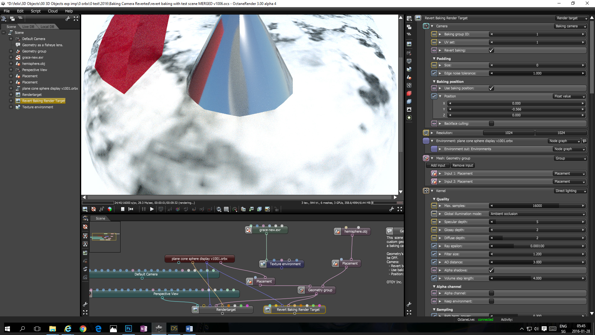

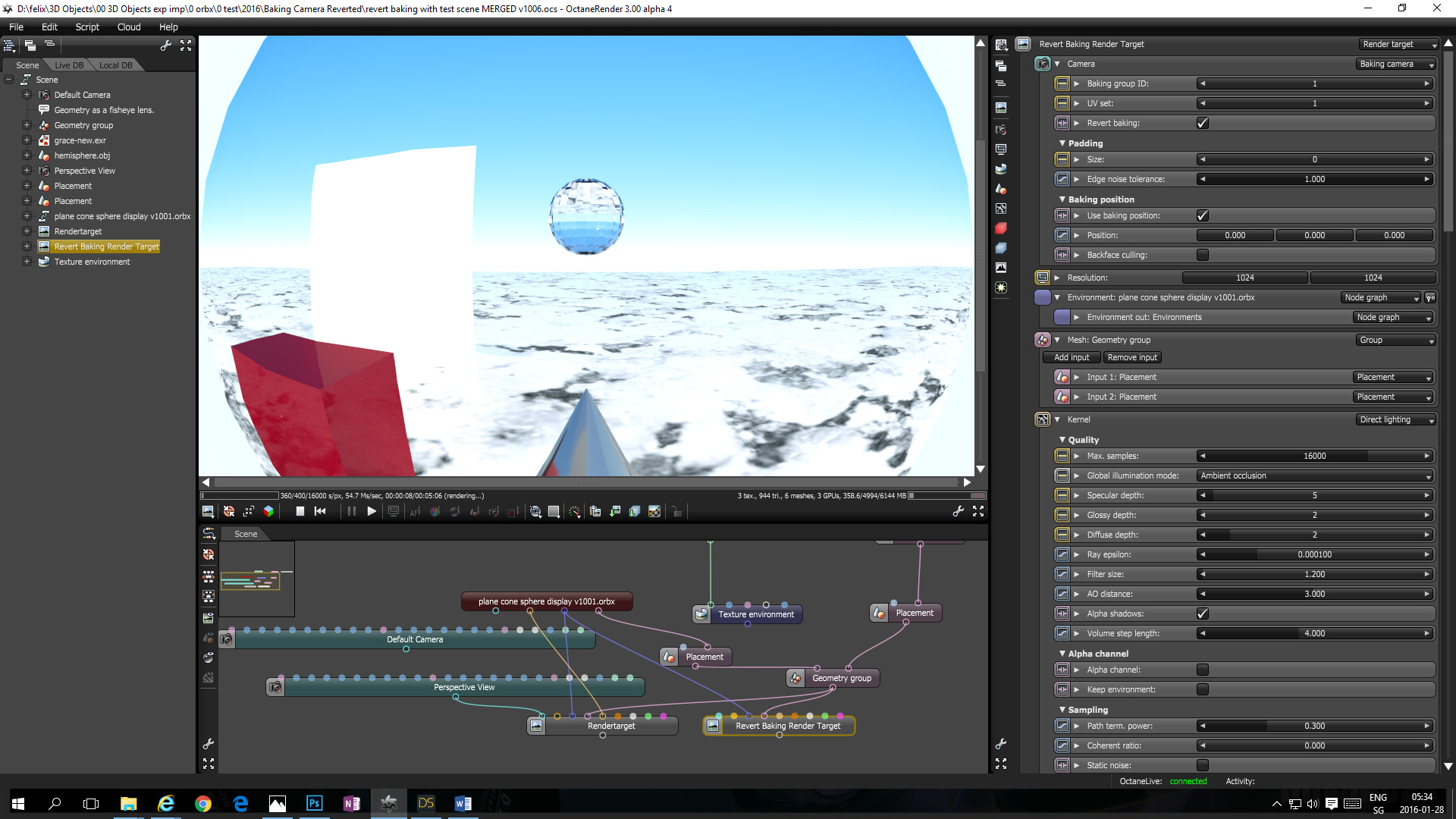

Test scene viewed trough the provided fisheye hemisphere:
This is what you get with the default settings with baking camera reverted activated:
Hemisphere Baking Camera View v1002

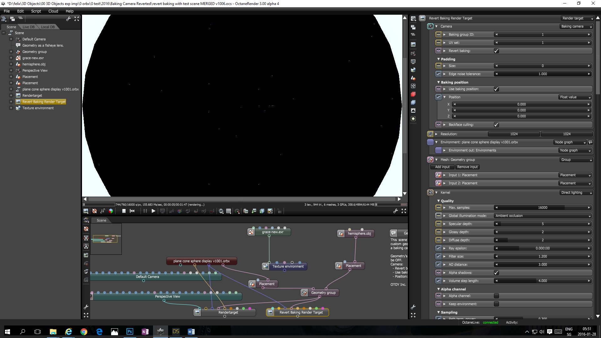

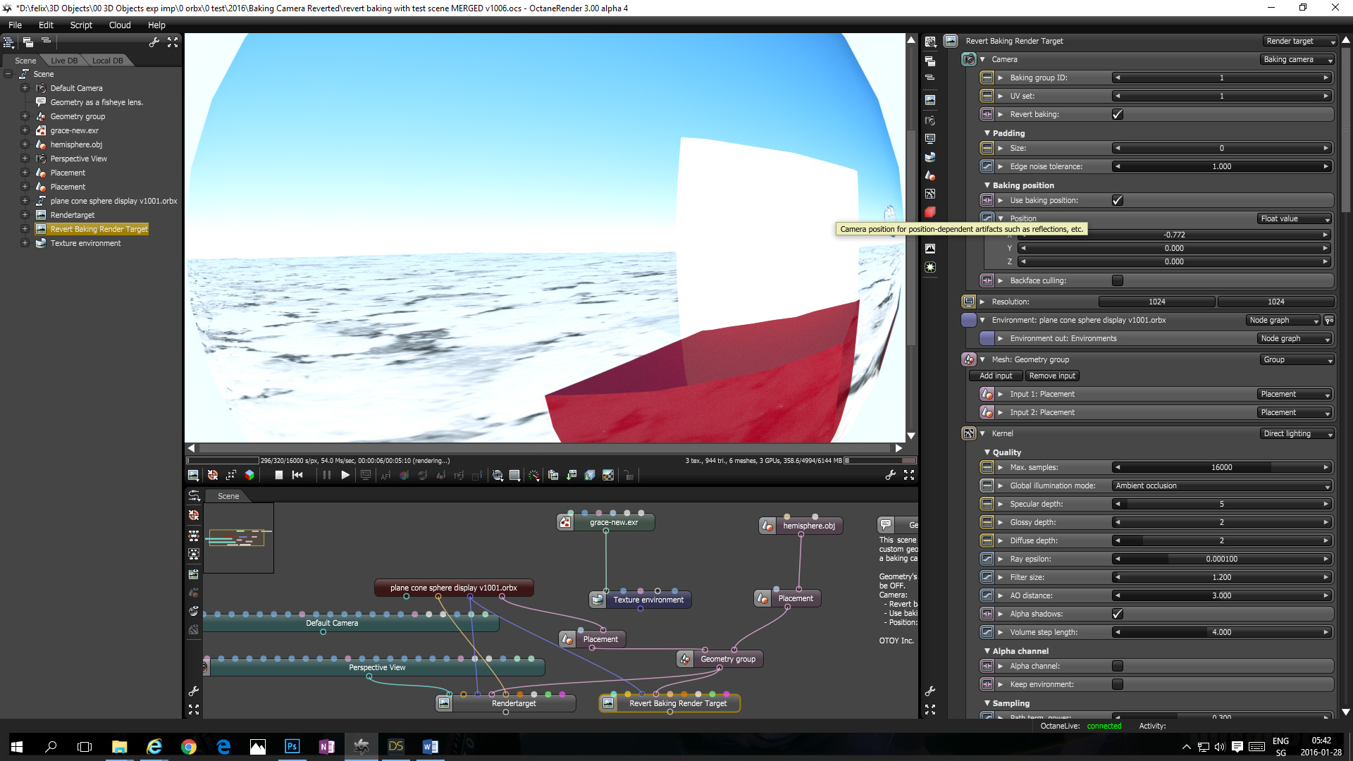

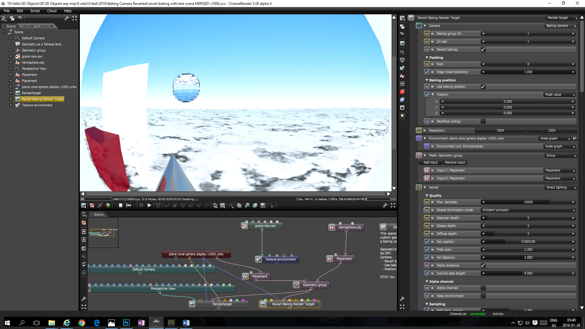

Baking Postion:
It seems by default the geometry that is intended to be used as camera needs to be located at the origin of the scene (x,y,z / 0,0,0).
This is where the hemisphere.obj is located.
We can adjust the X, Y, Z values of the baking position.

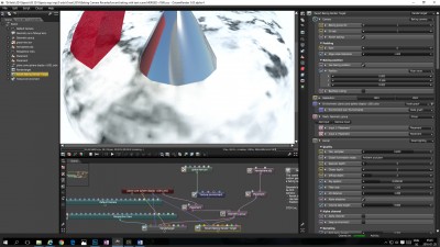

Backing Position X 0.200
Backing Position X -0.772
Backing Position Y -0.566
Backing Position Z 0.892

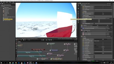

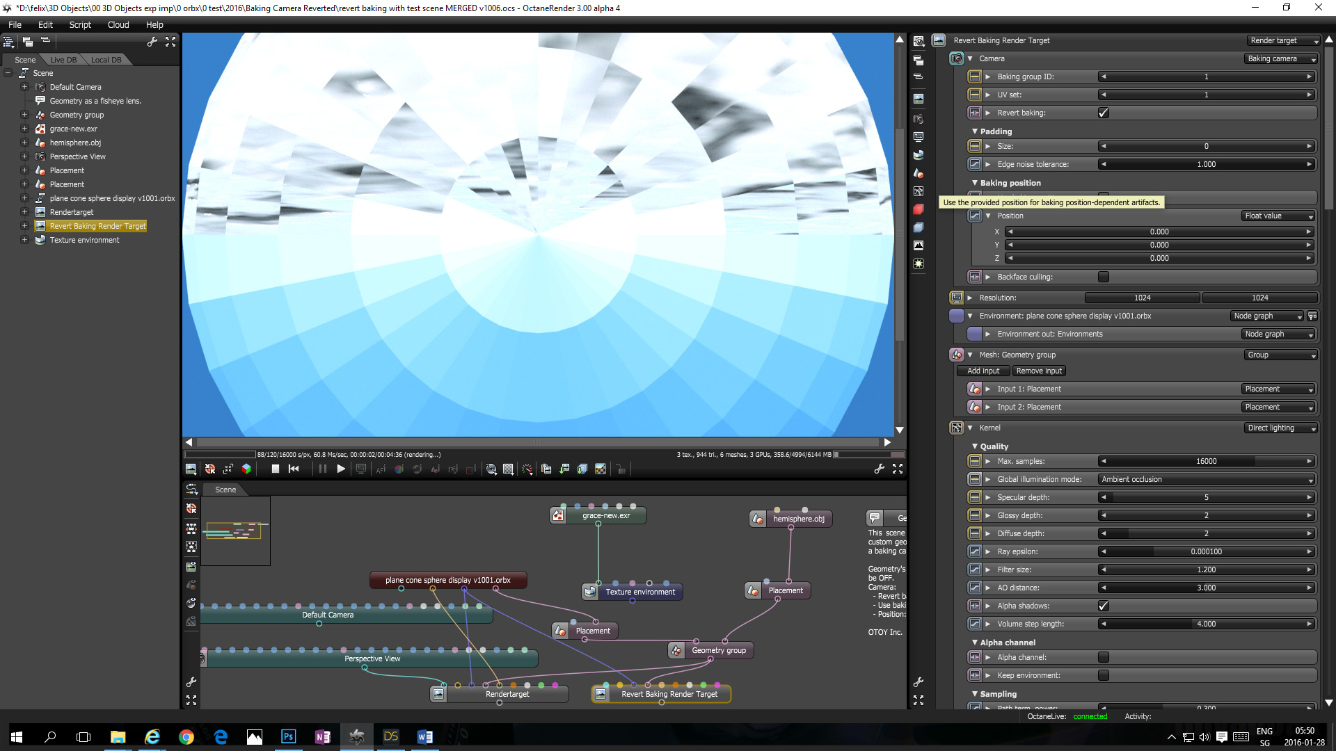

If you switch the Baking Position off you get this:
Baking position off
Baking position off

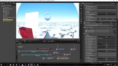

If you switch backface culling on you get this:
Backface culling on v1002

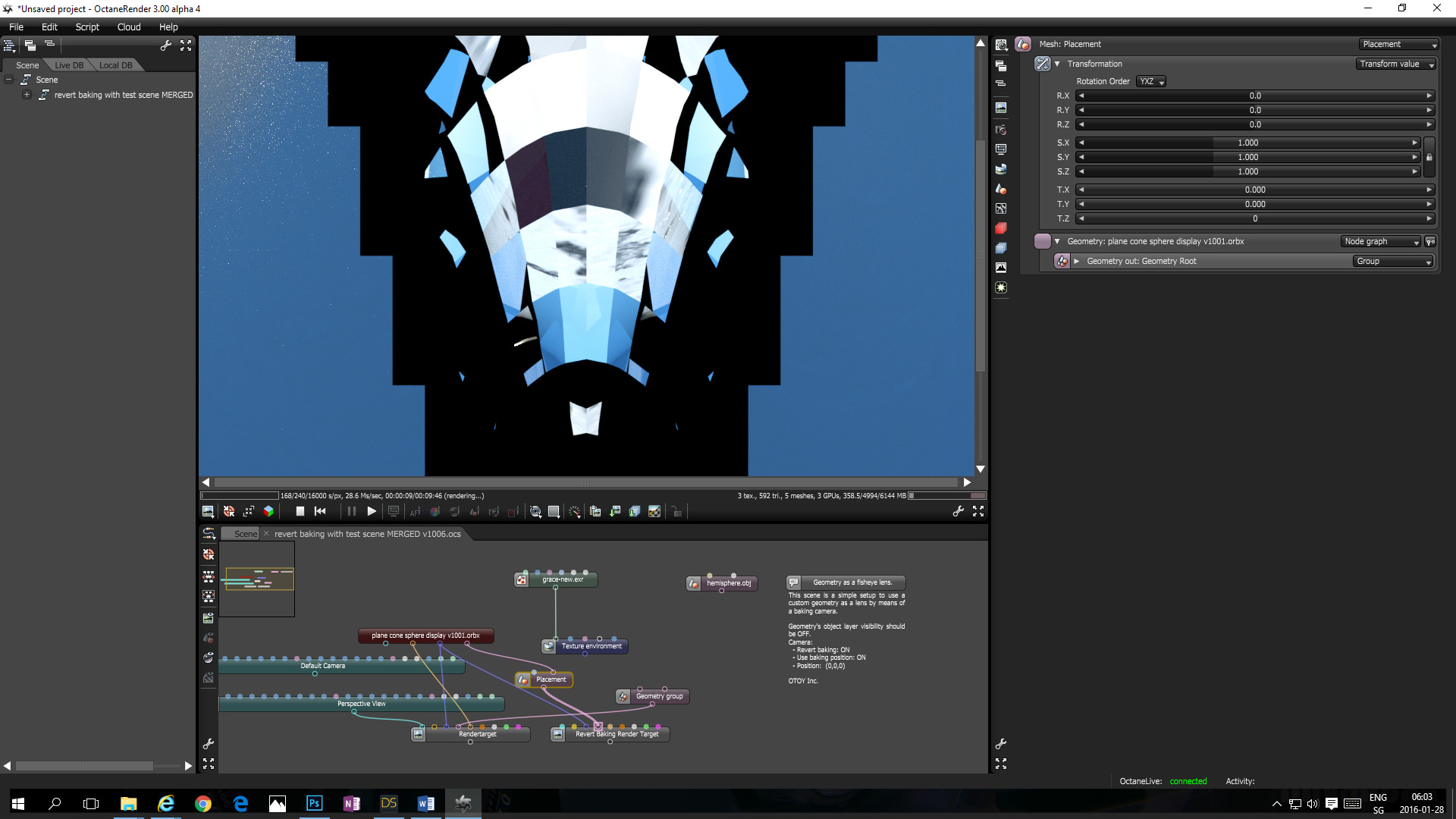

Tests with other geometry at origin
After all that I am still not sure if I understand exactly what the "reverted" baking camera does.
It seems to use the geometry at the origin (x,y,z / 0,0,0). to determine how the scene is looked at.
When I hook up my test scene directly with the baking camera the cone is in the origin postion.
Cone at origin v1002

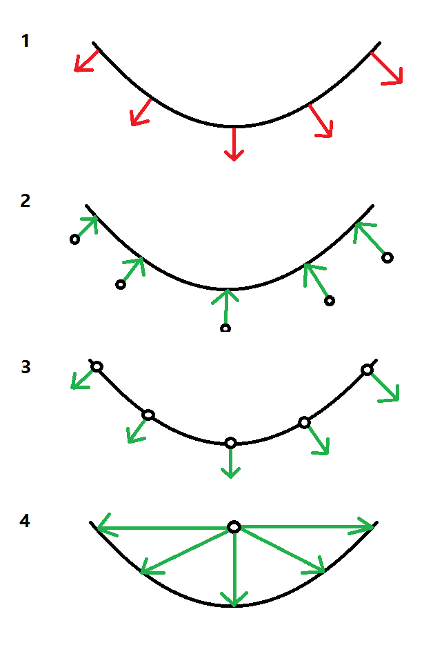

The way baking works, for each sample it finds the surface normal at that point (1).
Then camera rays are calculated pointing towards the geometry in the opposite direction, at exactly the kernel's ray epsilon, which makes sure the target surface is hit first and nothing else (2).
The revert baking feature does just what you would expect then, it reverts all rays, so they point outwards (3). This will bake the other elements of the scene, making your geometry effectively a custom lens.
Now, in order to create a fisheye camera that covers 180x90 degrees, which distortion becomes exponentially big over the edges, I decided to use a baking position. What this does, is to change the way the baking camera works so that all ray's origin is the specified point (in this case (0,0), which corresponds to the position of the geometry in the scene) pointing to the same sample point they'd do before(4)
If you change this, you will effectively modify your projection and get some fancy results ;)
