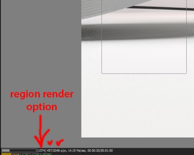

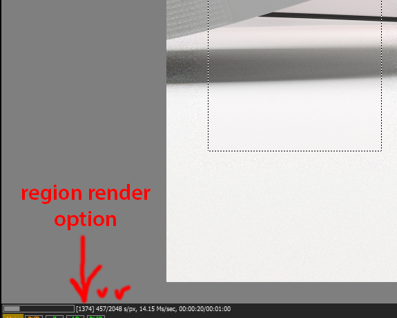

Goldisart
Posts: 780
Joined: Sat Oct 26, 2013 8:47 am
Please, bring back the alpha channel checkerboard
(there are difficulties in configuring the glass)

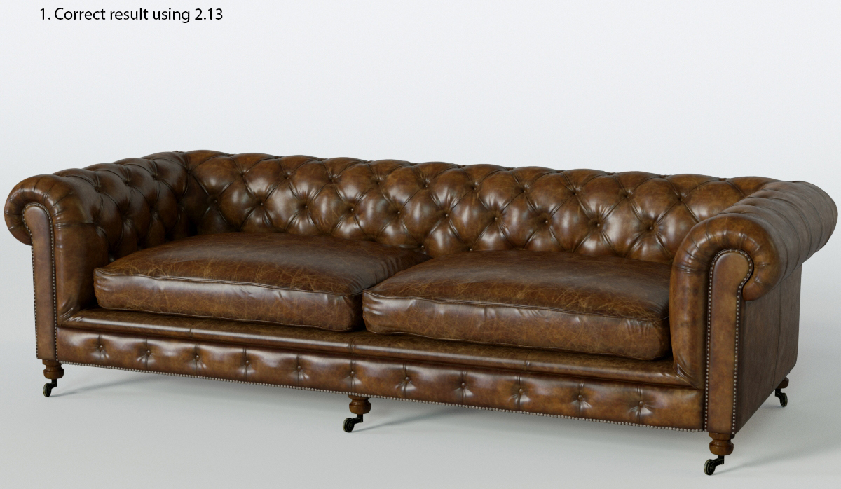

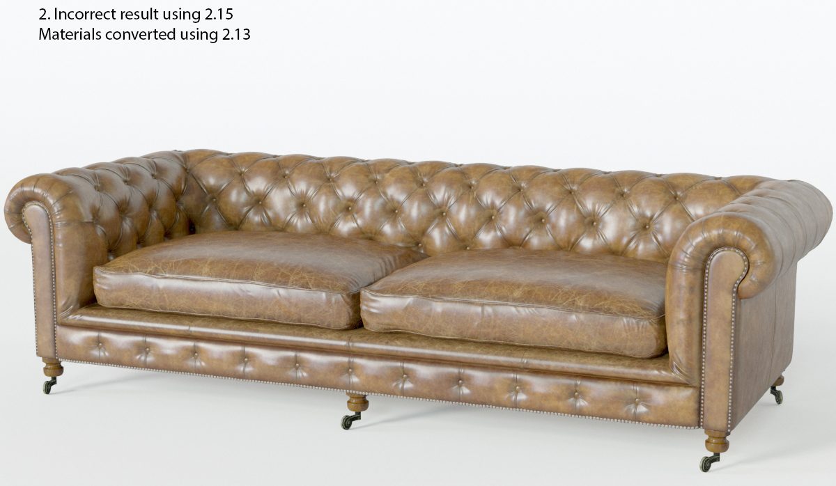

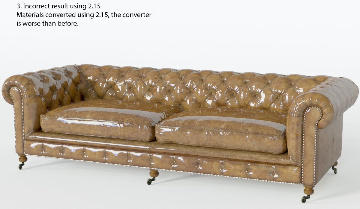

I upgraded to this version (2.15) from 2.13 and I´m a bit confused regarding the new gamma settings.
It seems like the response curves are not updated to correspond to the new gamma settings?
Before some response curves used either gamma 1,0 or 2,2, but now they doesn´t work properly?
I have a scene setup to use the default response curve (Agfacolor_Futura_100CD) and gamma 1,0 and with this version it looks like double gamma is applied (it looks the same if I would use version 2.13 with gamma 2,2).
How can I adjust the settings to correspond with the new gamma settings? If I use gamma 0,5 everything just looks wrong.
I like that I don´t have to untick "Affect Material Editor" in Gamma and LUT settings anymore to get a more correct material preview, but other than that I´m a bit confused.
Any insight in to this would be very helpful! :)
Update: I have attached 3 screenshots showing this. One screenshot also shows that the converter in 2.15 is acting weird/worse comparing to earlier versions.
/Daniel

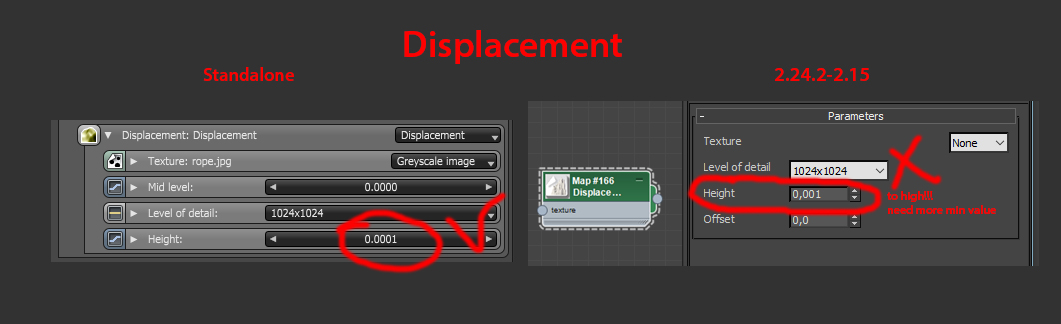

Scrudje
Posts: 31
Joined: Thu Feb 05, 2015 4:53 pm
I attached some images with options what i need for my job. Thank's in advance
Add this option to max plugin.
Pls add more minimal value of displacement height in max plugin. It's important!!!
