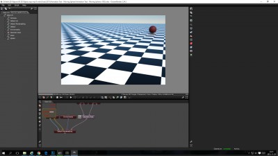

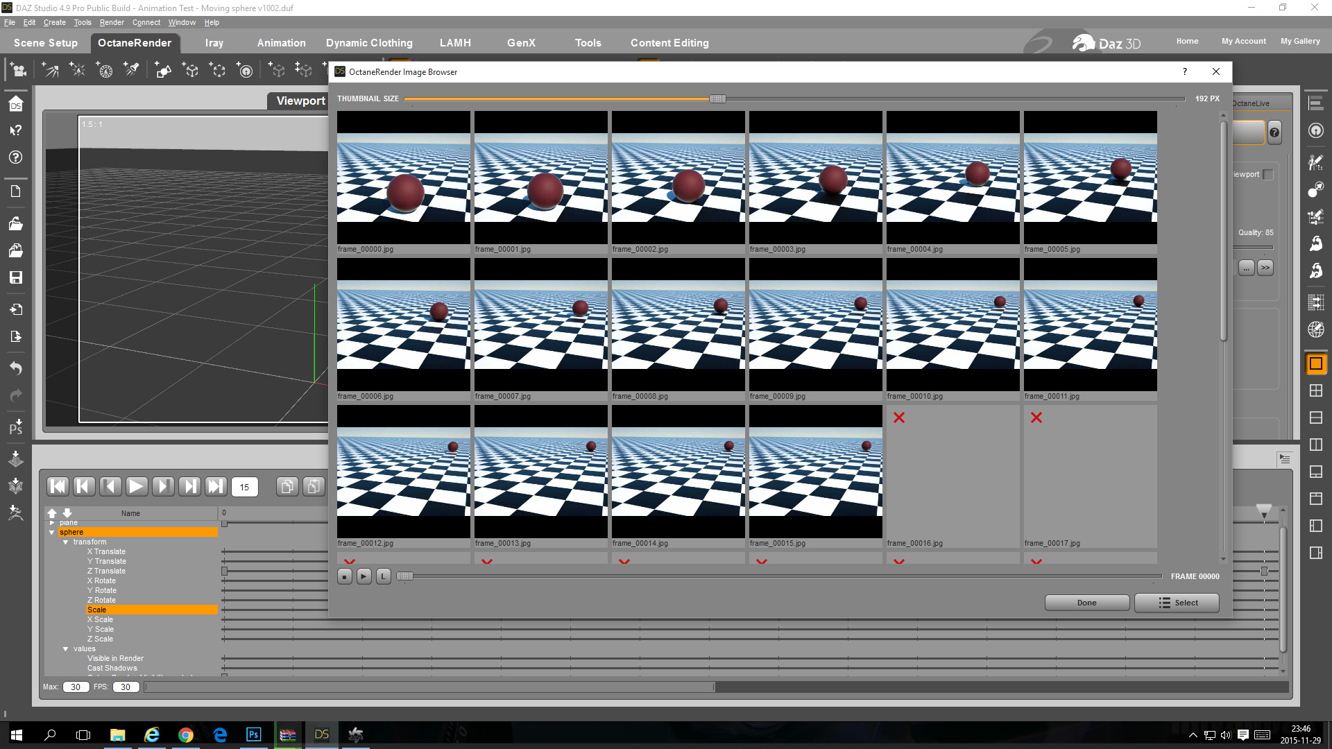

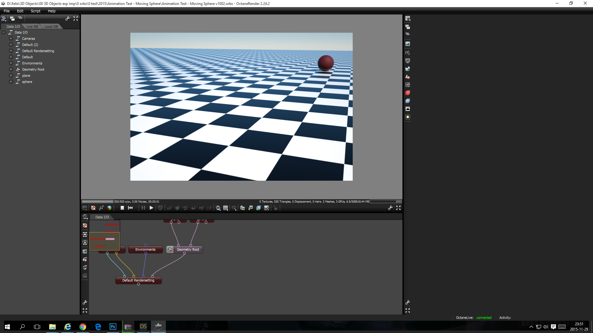

Seems the situation with ORBX animation export is worse than I was aware off. I was under the wrong impression that objects animated in the DAZ Studio timeline that are captured as keyframe in the DAZ Studio timeline and its plugins (like Keymate) are exported. This does not seem to be the case.Elele wrote:I use a static background scene and camera, and only rotate a specific mesh for the turntable. So I don't think that way will work for me. I guess I could export the specific mesh as alembic and combine it with the static scene in the standalone. Though the material names also dissappear with the alembic and I'm left guessing which material goes where.linvanchene wrote:
Jup. It is either or at the moment. (did not retest with 2.24.3 but its not mentioned in release notes so I guess that is still accurate)
BUT
Scenes exported as .ORBX do not include key frames for objects animated in the DAZ Studio time line
I just did a test scene with a sphere moving from the front to the back and when importing the .ORBX in standalone there is no time line at all.
Workflow to replicate:
- add plane to scene
- add sphere to scene
- manually place a keyframe for the translation value in the DAZ Studio Keymate plugin
- move slider to 15 frames
- translate the sphere to the background
- make a test render of the animation in OcDS
- export the scene as ORBX from the OcDS system tab
- open scene in OR standalone
If animation data would be included in the scene there would be a timeline below the viewport.
I attached the test scene in .duf and .ORBX format as a .zip file.
