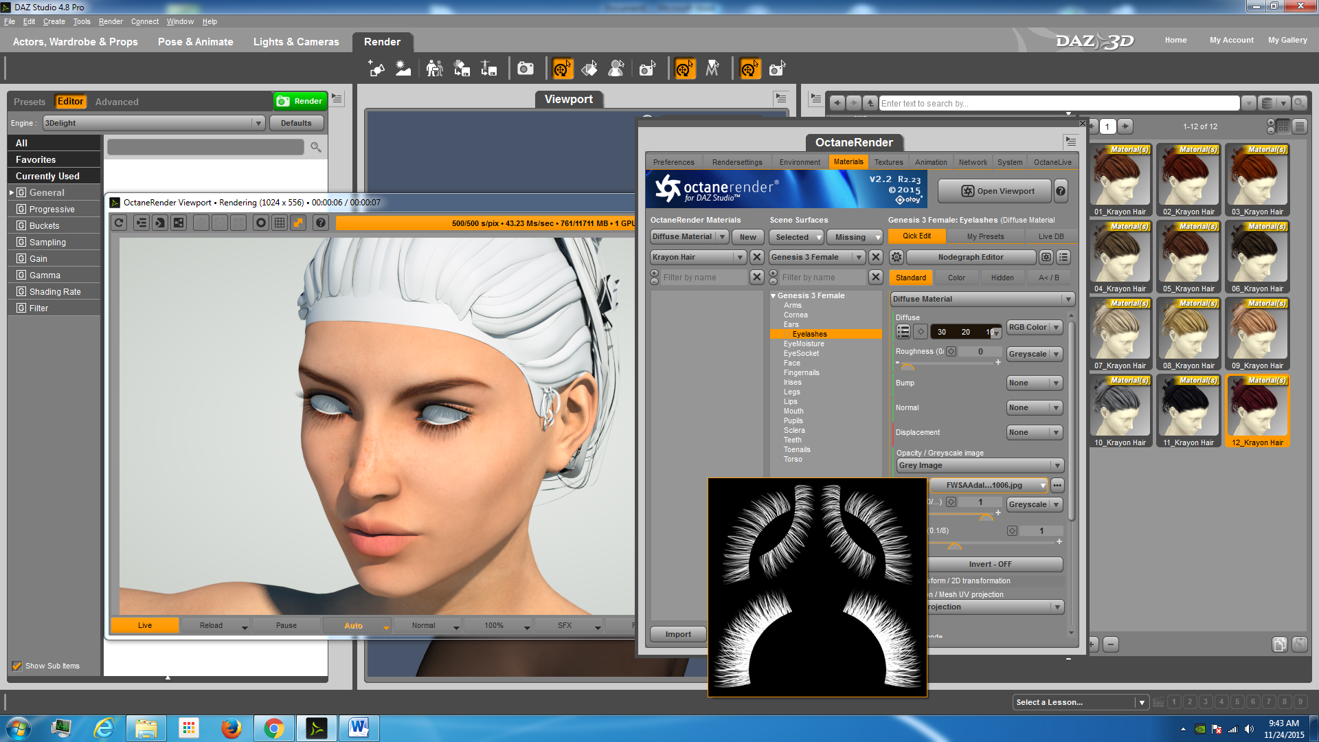

Okay, just to start, here was a workaround user 'bmosalt' had given me with a leaf texture for a background, it involved opacity maps.,,(I think I had to change Opacity from Greyscale to Grey Image, and then select an image from disk, so a mask could be applied). bmosalt's screenshot showed the fix

Yes, I just ran a Genesis 3 model with all Iray materials (not clothing), and was able to achieve correct rendering by switching the Opacity node from Greyscale to Grey image:
-eyelashes
-eye moisture
-Hair components (All, IE scalp, bun long, bun short, over, under, sideburns, etc...)
These pics just show me switching the eyelashes
OcDS takes in Iray Material as having a Greyscale for opacity.  The resulting render makes eyelashes looks like a solid object

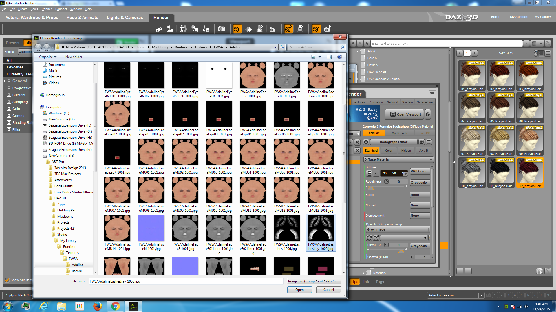

Switch Greyscale to Grey Image, and then selecting the corresponding Iray-version mask image

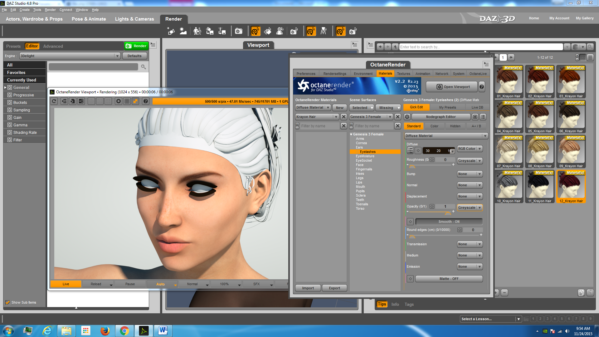

Now with the proper Iray-version mask image loaded
In short, the Iray materials do not load with the proper opacity mask images, so it all has to be done manually...If it was automated,

By the way, I don't know if this matters or not, but the mask image doesn't have to be the one that says Iray in the name. You could use the other one nextcto it as well, they both function the same.

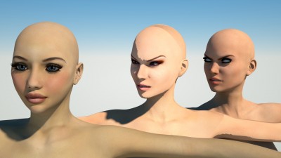

Maybe it was character dependent, in that newer iray-specialized characters are coming over differently?
In any event, try this...load a Genesis 1 and Genesis 3 character side by side. Add materials from some respective G1 and G3 character to them...
Genesis 1 comes through into OcDS with Glossy or Diffused materials, and renders properly.
Genesis 3, if SSS/3Delight mats, comes over with Mixed Materials.
Genesis 3, if Iray mats, comes over with Diffused, like we want, but has the opacity/mask issue I described in the earlier post.
I mean, it's starting to scare me...look how mad they look!
L to R - Genesis 1, Genesis 3 (SSS/3Delight), Genesis 3 (Iray)

Just to add on the SSS mats-
it is not the Mixed Material header that creates the issue, and if you select Diffuse header from the drop down it does not then automatically 'fix'. What fixes it is turning off the Normals map node, or even more specifically, setting the Normals power from 2 to 0. So, it's almost like the offender is Normals node power at 2.
You know, the Normals power at 2 actually creates an interesting Toon Effect. :idea:
If it wasn't for the pixelated shadows, it would look really cool. I would say it could be a feature later to have a toon mode, where the Normals map goes to 2, if somehow it could have the shadows rounded/blurred...
I would call it something really wild and super-innovative, like "Toon Mode"....yeah...
