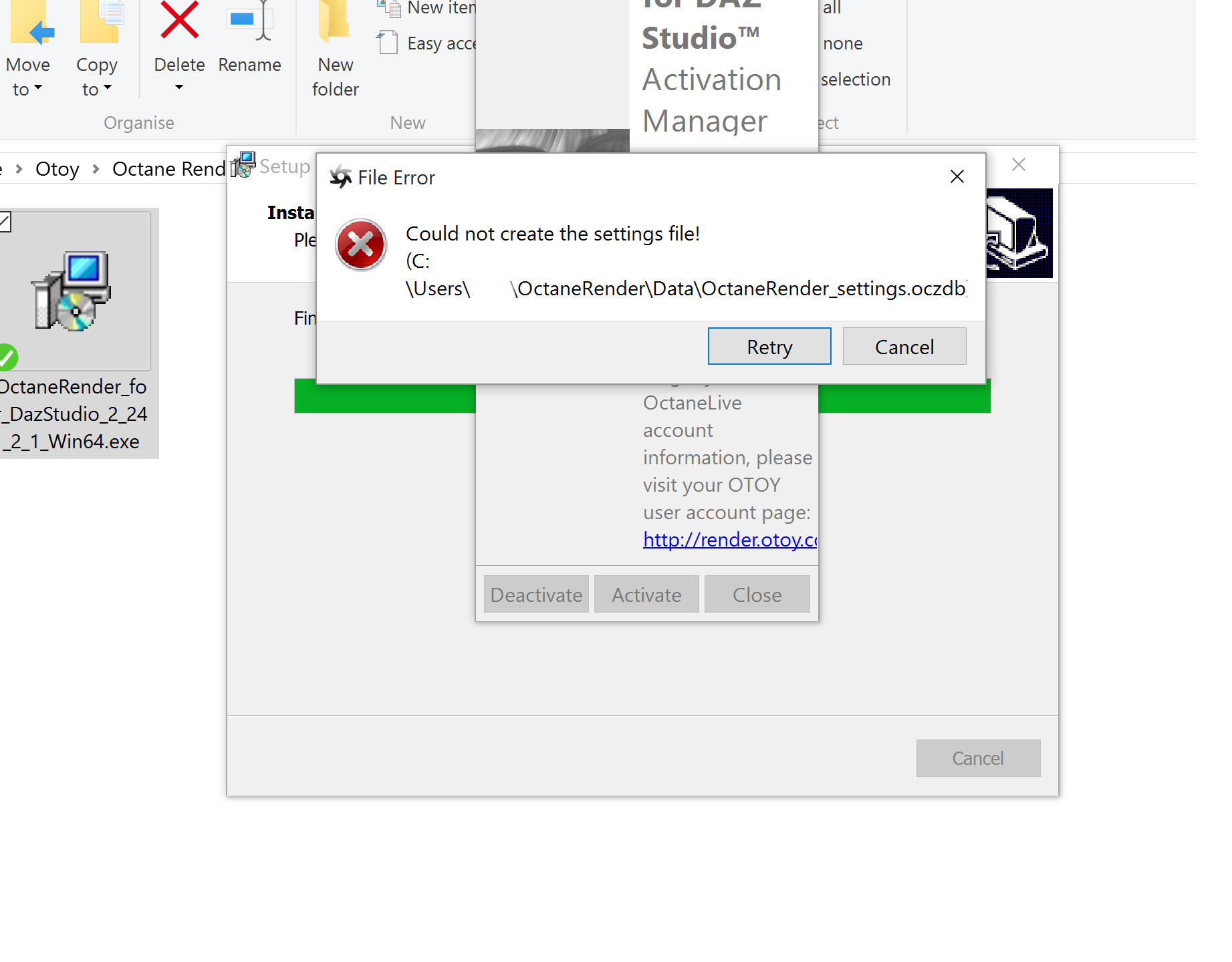

I deactivated both the standalone and OcDS license on the workstation and tried to reinstall on a windows 10 laptop.
- OctaneRender standalone installation and activation went without issues.
- When trying to run the installer OctaneRender_for_DazStudio_2_24_2_1_Win64 I encountered the same error message:
Could not create the settings file!
C:Users/USERNAME/OctaneRender/Data/OctaneRender_settings.oczdb

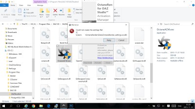

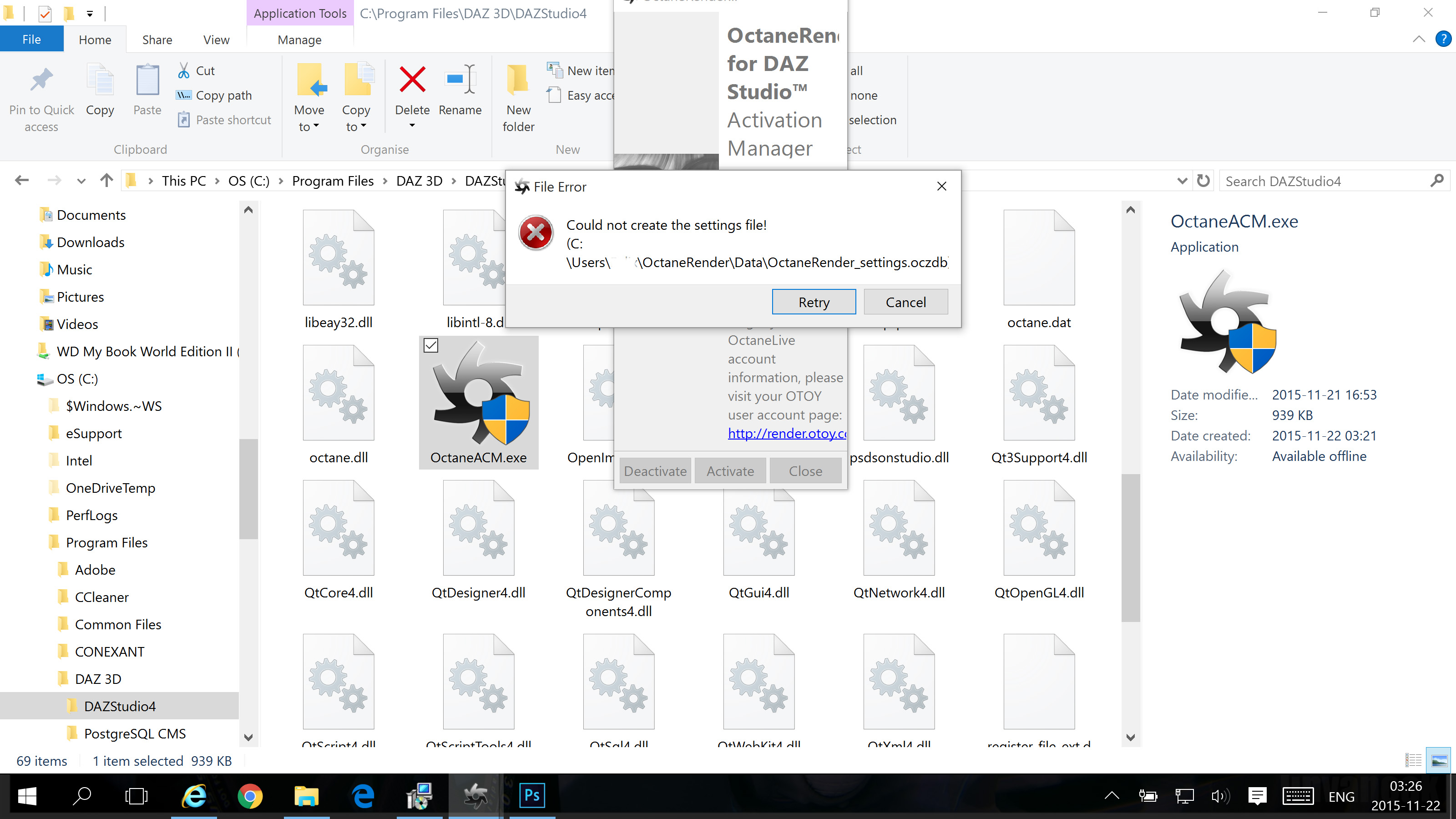

- When trying to run OctaneACM
from C:\Program Files\DAZ 3D\DAZStudio4".
I also got the same error message.
I did try several times paying attention to read the windows security check if I want to use admin rights and choose yes.
Thanks. Did you try rightclicking OctaneACM and running as Administrator?
Paul
Yes. I tried both several times.
- right click "Run as administrator"
and
- double left click
- In both cases the window : User Account Control appears:
Do you want to allow the app from an unknown publisher to make changes to your PC.
- I select Yes.
- Then the error message appears.
