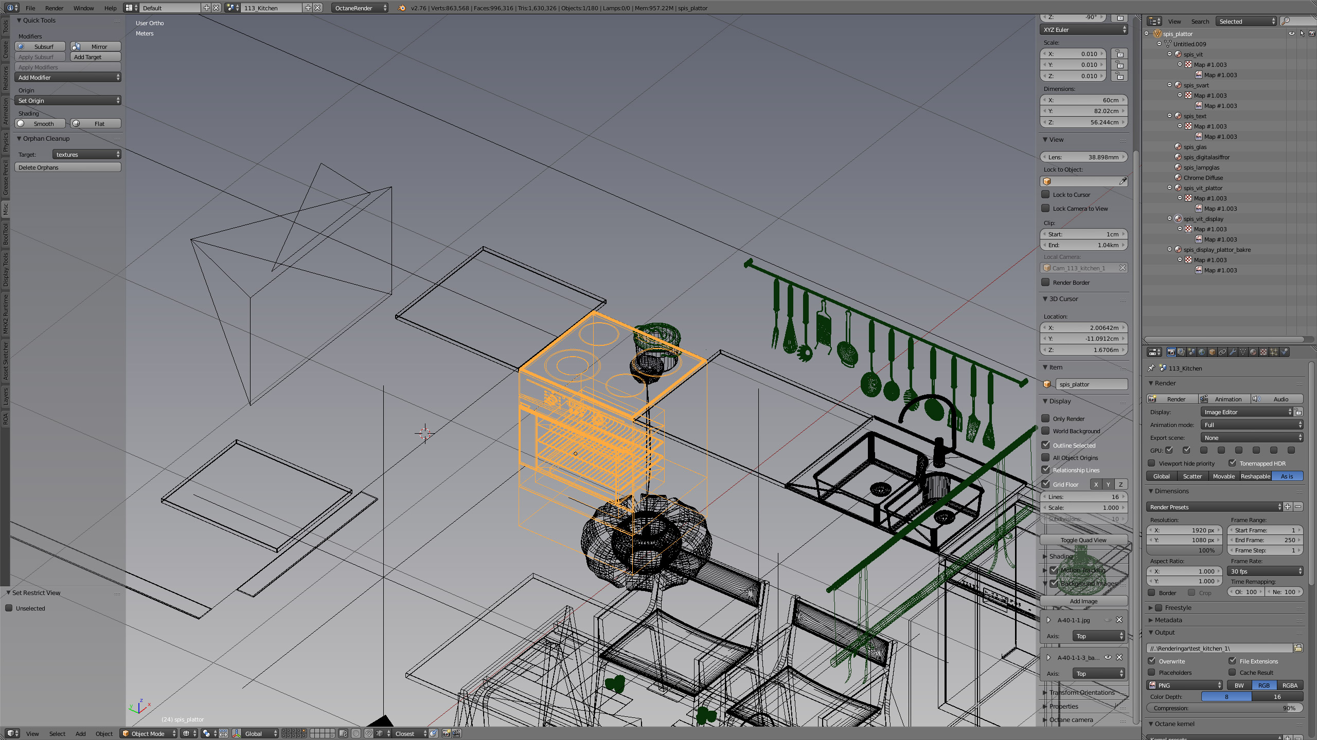

So, I´m still struggling with this, "Octane: ERROR loading image texture. Server response: Error transferring the refreshed texture file to the server.". I would love for the system console to tell me exactly what texture/textures are the issue. In some other issues that has actually been the case. I have gone through each object now, checking and updating names and search path, then hiding that object, then next object... Very time consuming and very stressful in a commercial project. I actually thought that I found a possible explanation, but it is not very logical though. I noticed in the outliner that in my imported fbx-objects were texture nodes attached to the material that had nothing to do with the Octane material (see attached image). So I thought any way after a few initial tests. I unlinked all of those maps object for object. When I was done I was super exited and hit render... Disappointment... The strange thing is that I prepare all the fbx objects in separate blenderoctane scenes with correct materials and textures, and in those scenes I have no issue rendering what so ever. So maybe not the fbx files causing this any way. If some one can give me a hint where to look, and what to look for, regarding this issue I would be ever so grateful. I´m running empty here on solutions....
