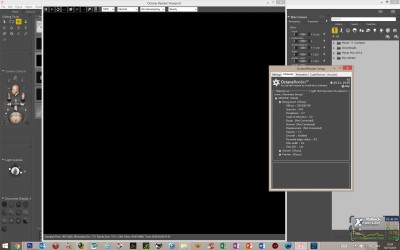

Greetings to all. I just played around with the plug-in to render Poser 11. I confirm that the version 2.24.2.62 plugin works seamlessly. As a test I used Victoria 4 and the new figure, Poser 11, Pauline. Point out the disadvantage that if I perform the render with the kernel direct lighting is okay, with the other kernel, must be set in the materials opacity = 0 to the background material poser, otherwise it will be all black. In fact, the new Poser 11, adds over to ground, also the figure basic background. As for the new materials superfly, I could test only a metal base material, type and gold, I can say that the plugin it turns more like a plastic material that metal, but this also occurred with similar materials in the old version. I hope I've been helpful.

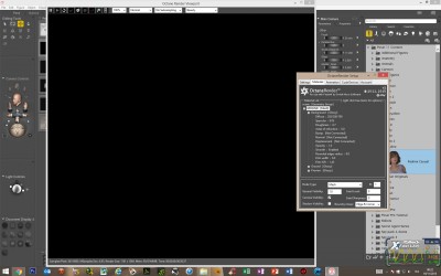

My 'Shadow Visibilty' is unchecked... Poser Pro 11

this is my situation
face_off
Posts: 15822
Location: Adelaide, Australia
Can you select the GROUND Mesh item in the Material tree and provide another screenshot pls?
hiram67
Posts: 19
Joined: Sun Feb 03, 2013 5:07 pm
I add that nothing changes if I select visibility shadow or not. I see the scene only if I put on the Background opacity = 0
face_off
Posts: 15822
Would it be possible to start with a default andy scene, confirm you are getting the problem on that scene, then save it as pz3 and send it to me pls so I can take a closer look.
