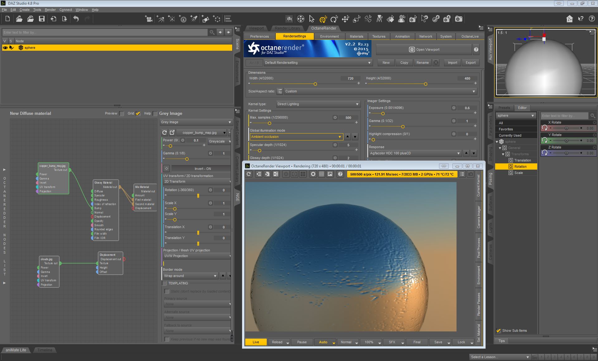

I recreated it with another scene. Just a 100cm sphere with 20 segments and 20 sides with this image as both bump and displacement.

Hi Elele,
it's possible to use displacement with bump, but it largely depends by the geometry topology, not having overlapping UVs, and by the quality of textures.
Using the same texture for both channels does not make much sense, in general we want a displace map for deforming the geometry and a bump or normal map for adding the fine details.
One way is to combine both textures in PS or similar, or you can try with the mix material method, here is some example with your texture for displacement plus another one for bump: P.S. If you see strange patterns when you use displacement, especially when used with bump, try to play with the Ray Epsilon value, it has a great impact in the final result

Since the error happens for my mesh, DAZ3Ds G3F and a basic sphere I think it is safe to assume the problem is not related to the mesh or UVs. The mix material trick doesn't work, like I showed in the previous example.
Guess I'll just photoshop it then.
