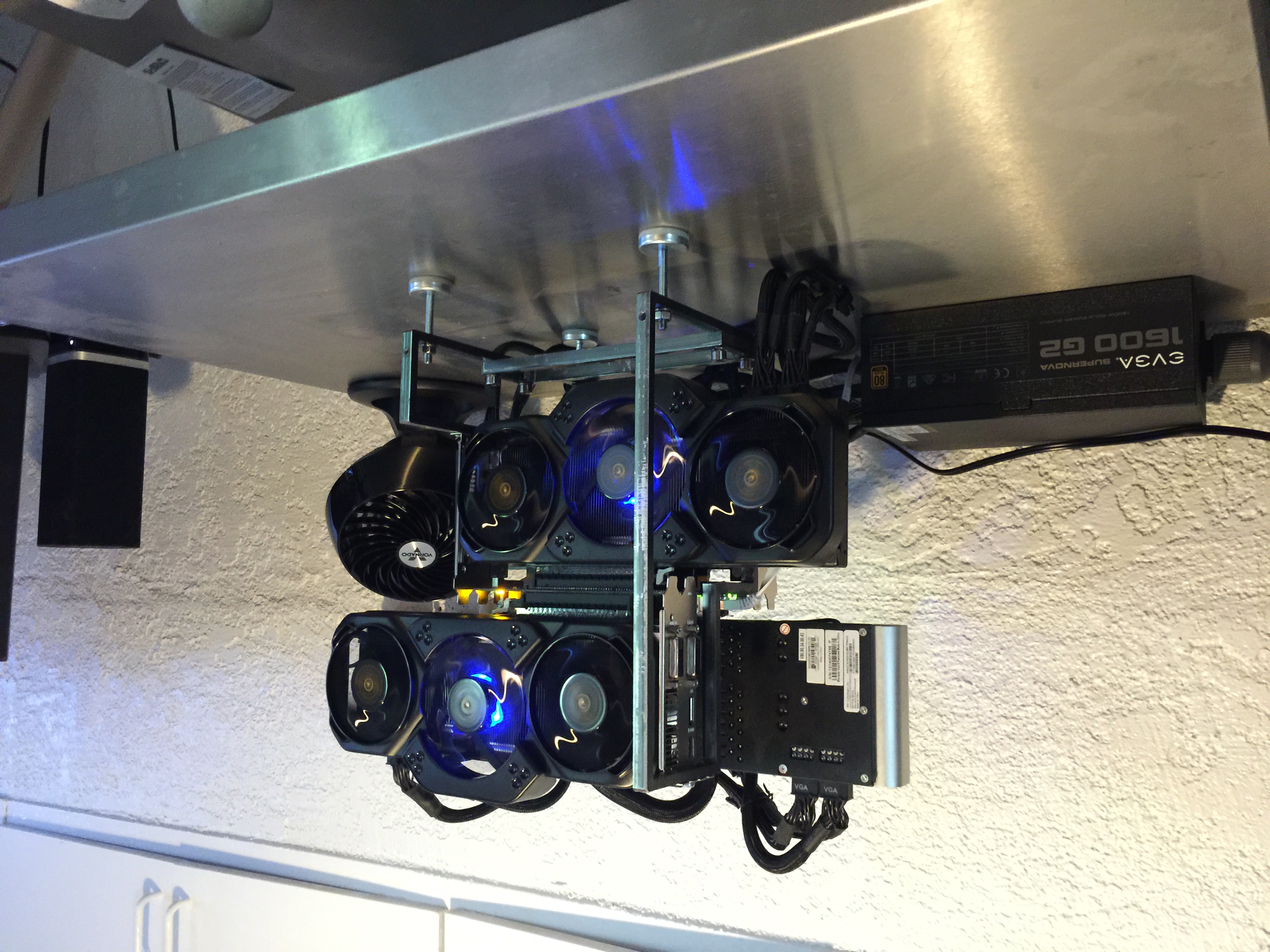

not to thread jack, but since its coming up again. I built this from http://amfeltec.com/ with 4 780ti and a 1600w Gold rated GPU. for less than the cost of the netstor enclosure.
its not the prettiest, and I did have an issue with the first one that arrived, but the current one has ran for the last 8 days without a break.

xcaseyx wrote: its not the prettiest, and I did have an issue with the first one that arrived, but the current one has ran for the last 8 days without a break.
man, it's a sick piece with those triple fan equipped cards!!! thanks for sharing =) what You get on air i terms of Octane bench with those cards? have You got any OC? tweeted fan speeds or everything runs at default speeds?

the hottest they've gotten while rendering for 9 days is about 62c. the GPU's inside my PC case go up to like 83c, so they stay super cool by comparison.

xcaseyx wrote:the hottest they've gotten while rendering for 9 days is about 62c. the GPU's inside my PC case go up to like 83c, so they stay super cool by comparison.
That's a pretty cool rig and nice how low the temperatures stay. How much his the whole rig? I didn't find this when researching different options...
