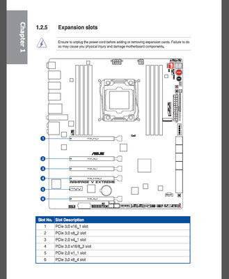

I dont know why my TitanX is having a problem with this mobo then...I can put it in any other slot and Windows refuses to see it other than a lores vga adapter with a big red question mark in device manager.
If someone knows of a fix to this, please let me know. In the mean time, I'll chat with nvidia.

After my talk with Nvidia, the problem should have been obvious at the outset...The Titan X needs a PCI X16 slot. There are only two on the Rampage-5 mobo...The very top slot (#1), and the very bottom slot (#4) shared with X8. I only tested 1, 2 and 3 (#4 was too close to the PSU). Obviously, 2 and 3 failed because they are not X16.

treddie wrote:After my talk with Nvidia, the problem should have been obvious at the outset...The Titan X needs a PCI X16 slot. There are only two on the Rampage-5 mobo...The very top slot (#1), and the very bottom slot (#4) shared with X8. I only tested 1, 2 and 3 (#4 was too close to the PSU). Obviously, 2 and 3 failed because they are not X16.
That is what I pointed out right at the beginning : first red slot and third red slot :) Before connecting any pci device always look into motherboard manual which pci slots are x16s,.... Pages 18, 19 of the manual of ramage V.
