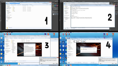

My problem on pic.
Sorry for english
Thnx Fara

I think that your houdini.env file should be something like this, with the $PATH at the end of the PATH variable:
PATH = "C:/Program Files/Side Effects Software/Octane_h14/bin;$PATH"
HOUDINI_PATH = "C:/Program Files/Side Effects Software/Octane_h14;&"
-Juanjo

strange.
im copy script from manual - its dont work.
copy from your post - work
juanjgon
Posts: 8867
Location: Spain
Great, I think that the problem could be the "$PATH" string position. If you have more problems, let me know.
-Juanjo

Also notice that Houdini seems to be sensitive to errors in the HOUDINI_PATH string in houdini.env. In my case:
HOUDINI_PATH = /opt/htoa-1.5.2;/opt/octanerender-houdini-2.23.2.4&
.. was wrong but ...
HOUDINI_PATH = /opt/htoa-1.5.2;/opt/octanerender-houdini-2.23.2.4;&
.. was right. The difference is that I forgot the last semicolon before &
