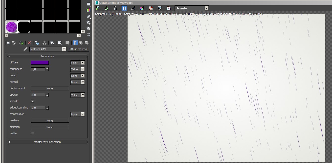

Elvissuperstar007 wrote:Particle already working?
particles work?
I can not render rain
