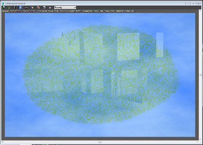

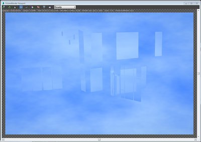

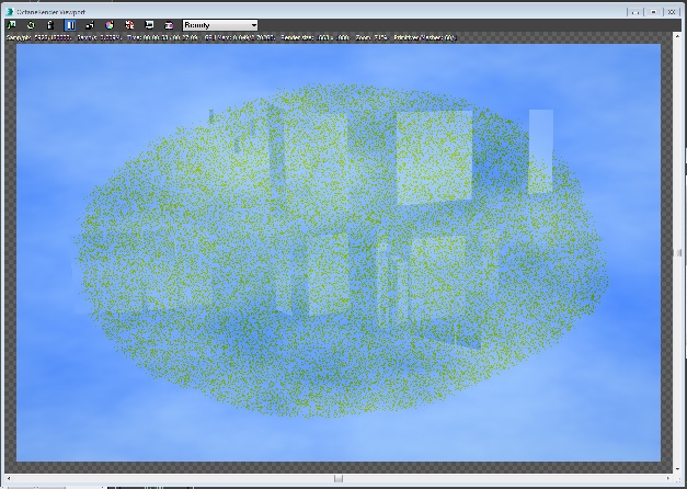

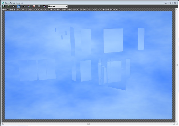

Dithering seems to be the cause, uncheck it and octane viewport turn to "normal" display.
dithering on
dithering on
dithering off
dithering off
