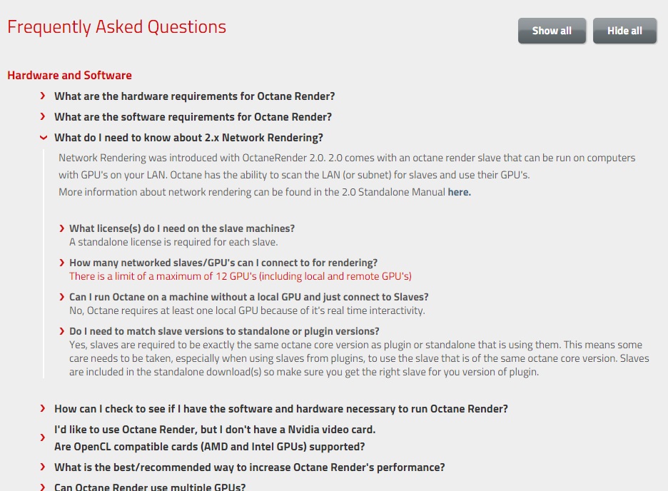

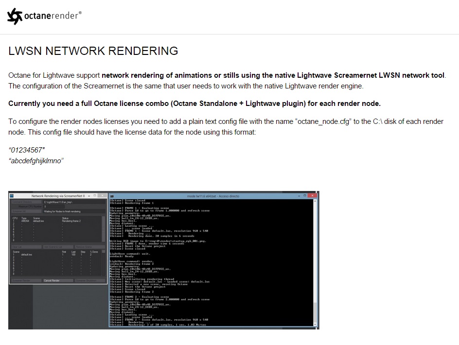

There is some public information about the Octane native network rendering, you have a detailed description in the Octane web page FAQ section. The LWSN network rendering with Octane is also covered in the LightWave plugin manual, as you can see in the attached images.

Btw it is also locked to 12 gpus per license afaik so if you go that route don't buy more than that per license.

Can you please check if you have a return after the password in the octane_node.cfg file?
If it doesn't work, can you please verify again the both Standalone and plugin licenses are deactivated in your web account. Once deactivated you should be able to use them in the render node without problems.
You could also try to install the Standalone in the render node to see if it works and can be licenses without problems ... and also perhaps you could try to launch a Layout in the render node to see if the plugin is working fine and can be licensed.
Finally, if nothing works, can you please send to me your octane_node.cfg file? ... you can use a PM or send it by email to [email protected]
