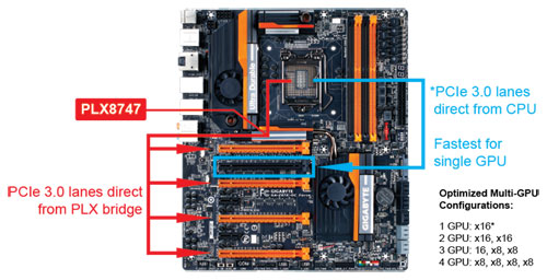

What Gigabyte done with this gen OC board (Z97) to lower the price - they don't include PLX chip - & thus You get lower lane count to PCIe slots =)
slightly older, earlier model : GA-Z87X-OC Force has PLX & it supports x8 x8 x8 x8 mode =)

"..with the help of PCIe switches it's possible to grant all devices the lanes they require (although the maximum bandwidth isn't increased, but switches allow full x16 bandwidth to the GPUs when they need it). "
so in simple words..when You have a switch it gives a possibility, but not the bandwidth.. - so if you're limited by CPU, You are..switches only hook all the devices..so in case when You need to drop all the information to one GPU it would get full lane count instead of 1/4th..
so as I look to that..as I understand..if You have the same CPU on board with PLX & without.. there would be no difference if You would use 4x cards =) but the difference would come if You would use 1 card, (but the rest would be idling) - got the point? it's switch, like a 'crosroad'.. not some sort of a 'factory' that makes more "bandwidth" =)

From what I gathered regarding PLX in general, it actually the opposite, the entire point is speed increase over multi-GPU. In systems without PLX, the lanes are limited in such a fashion that after 2 cards (usually at most) PCIe starts droppiing, so usually it'll turn out something like 2 ports at x16 with 1 port at x8, or 4 ports at x4. The PLX allows for you to have x16 on all four lanes, it just isn't increasing the bandwidth past the current speed (i.e it's not hitting PCIEx16 gen 4 or something). This is at least how they tend to present it, and information regarding it is often somewhat cryptic. No idea how much this affects speeds really, as far as Octane is concerned, but researching this was the basis of the parts I selected for my build.
