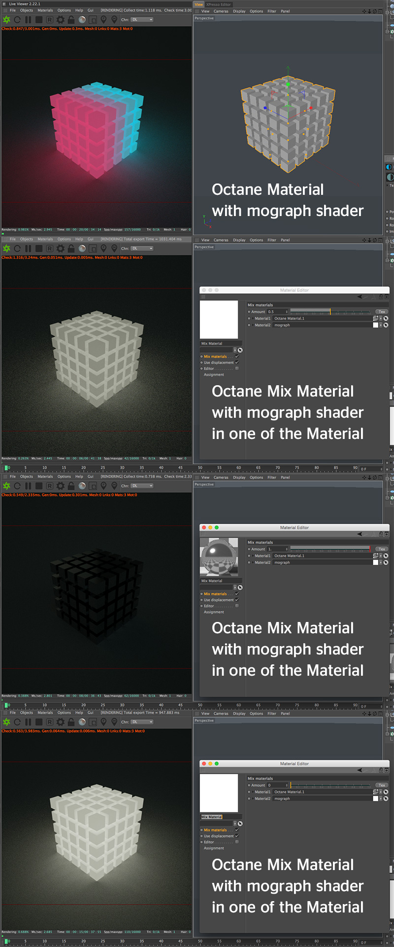

hi ahmet thank you for the hard work
the mograph shader really so cool.
i only have small problem with mograph shader and it is that he is not render with Octane Mix Material i hope i am not doing something wrong and btw the Material with mograph shader is Diffuse and the other is Glossy with out mograph shader :) but everything is good thank you

Hi Ata,
thanks for feedback. Definetely i'll check this. This mograph support can be described as a alpha phase. There is still lot of glitches and limitations which are known by me. But i liked to share this and get some feedback from people about it.
