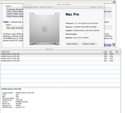

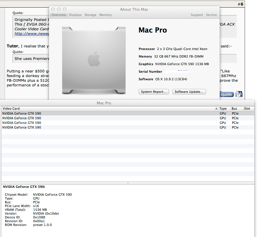

The pic below shows some info about one of my four MacPros (it's the 2007 version) that was then running 2xGTX590s (each dual GPU processor cards); I tried installing one of my GT640s, in addition to the two 590s, and the system wouldn't boot. I tried installing other cards also with the same result. So that why I used the term "GPU processors" instead of "GPU cards" because if the cards are dual GPU processor cards, then the limit is 2. But you can install up to three double wide CUDA cards (single GPU processor version) in a Pre-2013 MacPro's case along as you adequately power it [ http://forums.macrumors.com/showthread. ... st18872245 ]. The saving grace is that as future GPU processors become more powerful, the three double wide CUDA (single GPU processor) card installation limit for inside of the MacPro's case, will not matter as much.

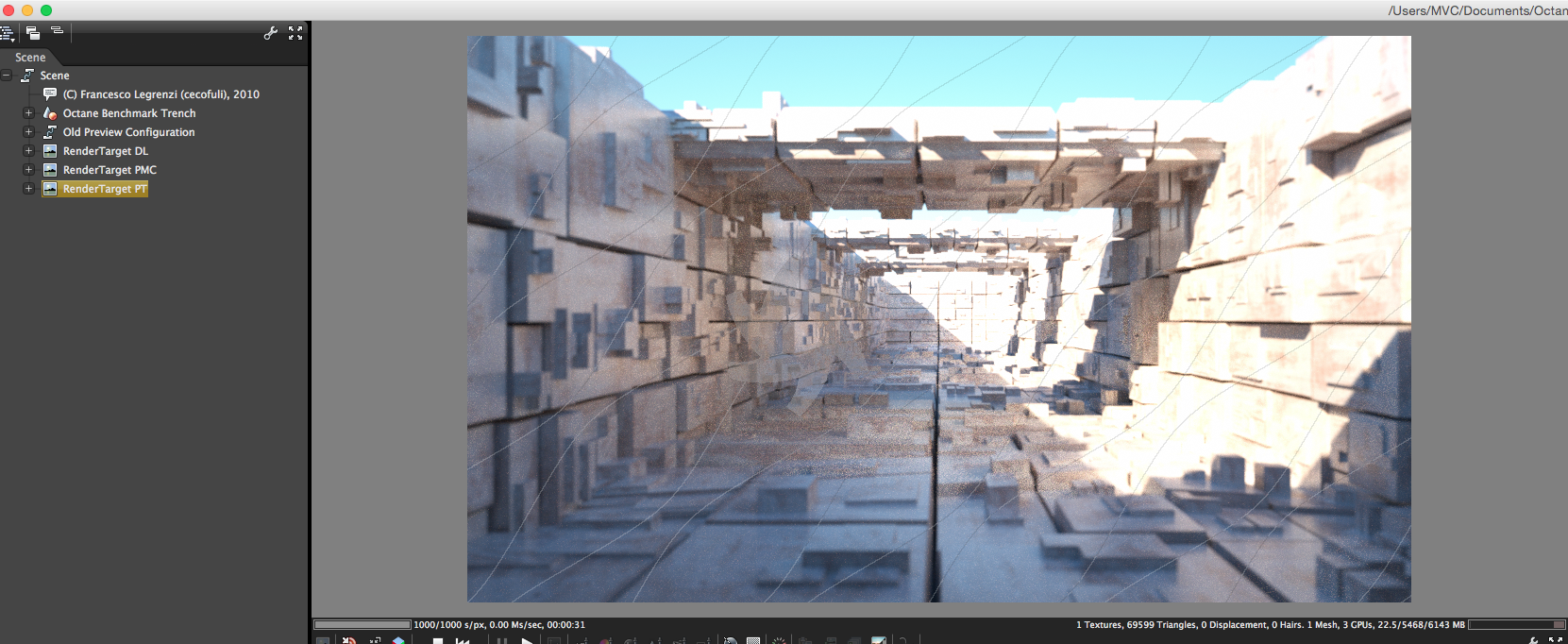

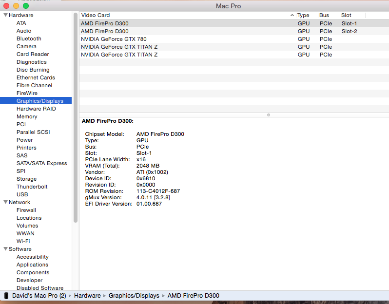

MVC's pic, shown in the thread that you've referenced, displays only 4 GPU cards (and 5 GPU processors) for his new eGPU device, because each GPU processor of the Titan Z, just like the GTX 590 in the pic that I've displayed, shows as two cards in the "About This Mac" window [ [ http://forums.macrumors.com/attachment. ... 1422527711 ] ]. So it is really running just one Titan Z (a dual processor card), a GTX 780, and with regard to the AMD processors (showing as "AMD Fire Pro D300"), there may be two additional cards, at best*/. If you look closely at MVC's pic of the Octane window [ http://forums.macrumors.com/attachment. ... 1422527711 ], you see (on the mid right side that only three GPU processors are recognized (2 for the Titan; 1 for the 780) and none for the AMD(s) (not supported).
*/ I said "at best" because those cards aren't sold as "AMD Fire Pro D300;" so I'm not sure what card(s) that/those really is/are.
