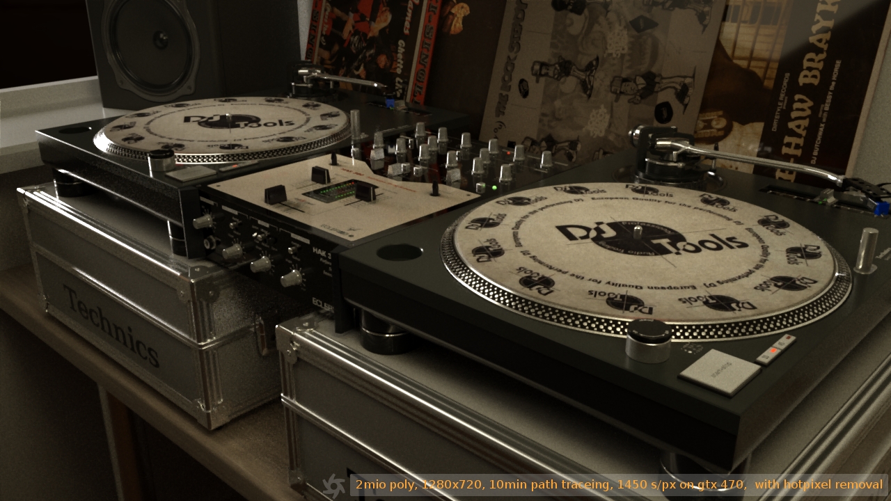

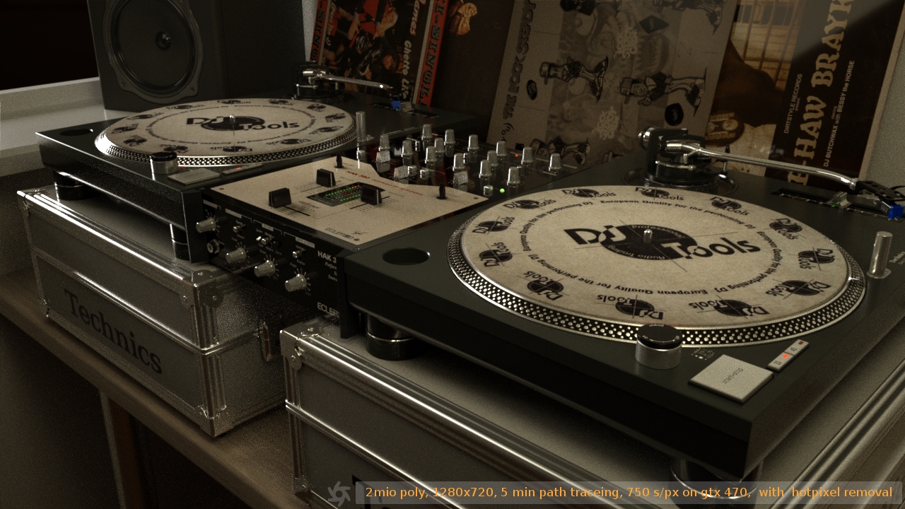

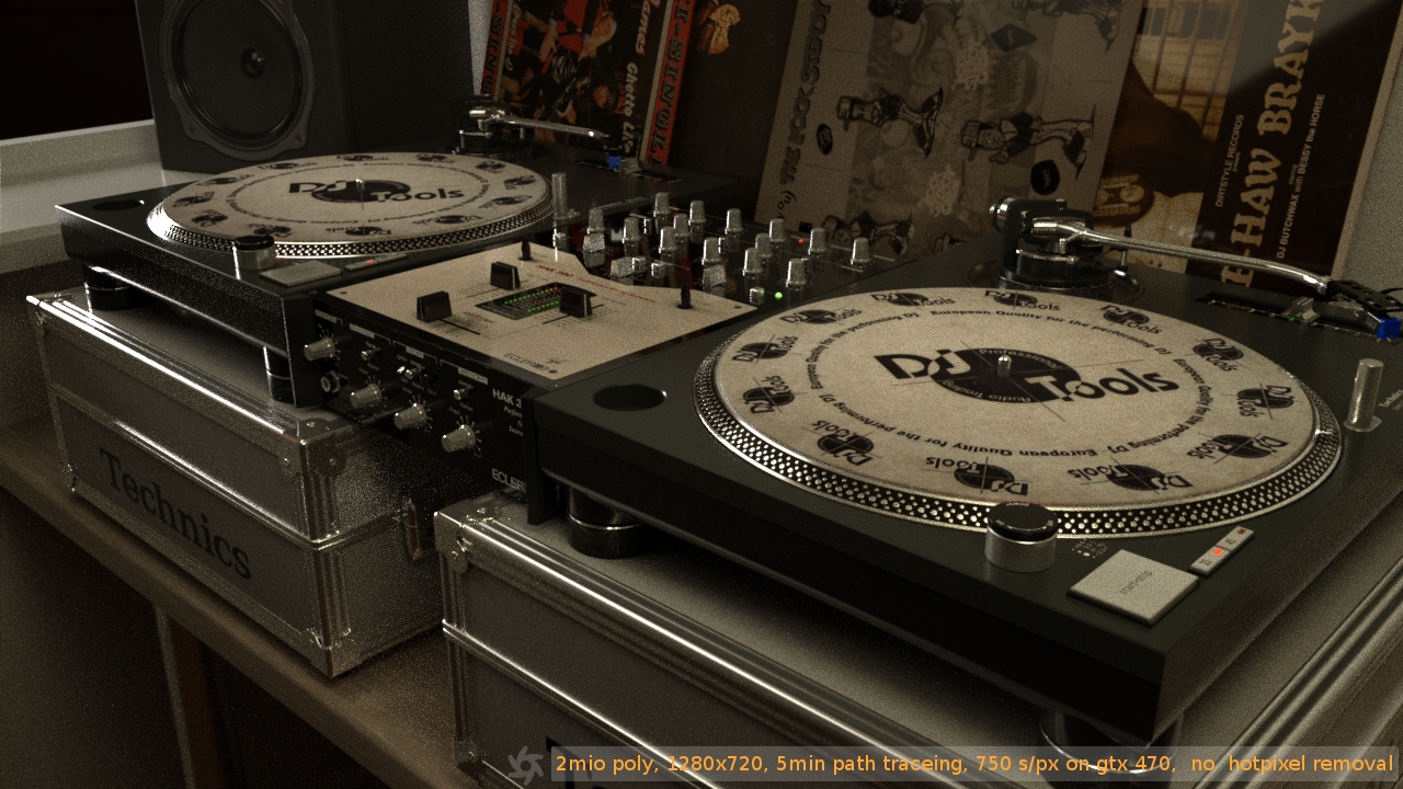

Render times of the previous images was something between 5-10 min. I dont quite remember but i guess ~1000s/Px.
here is some more detailed render info:

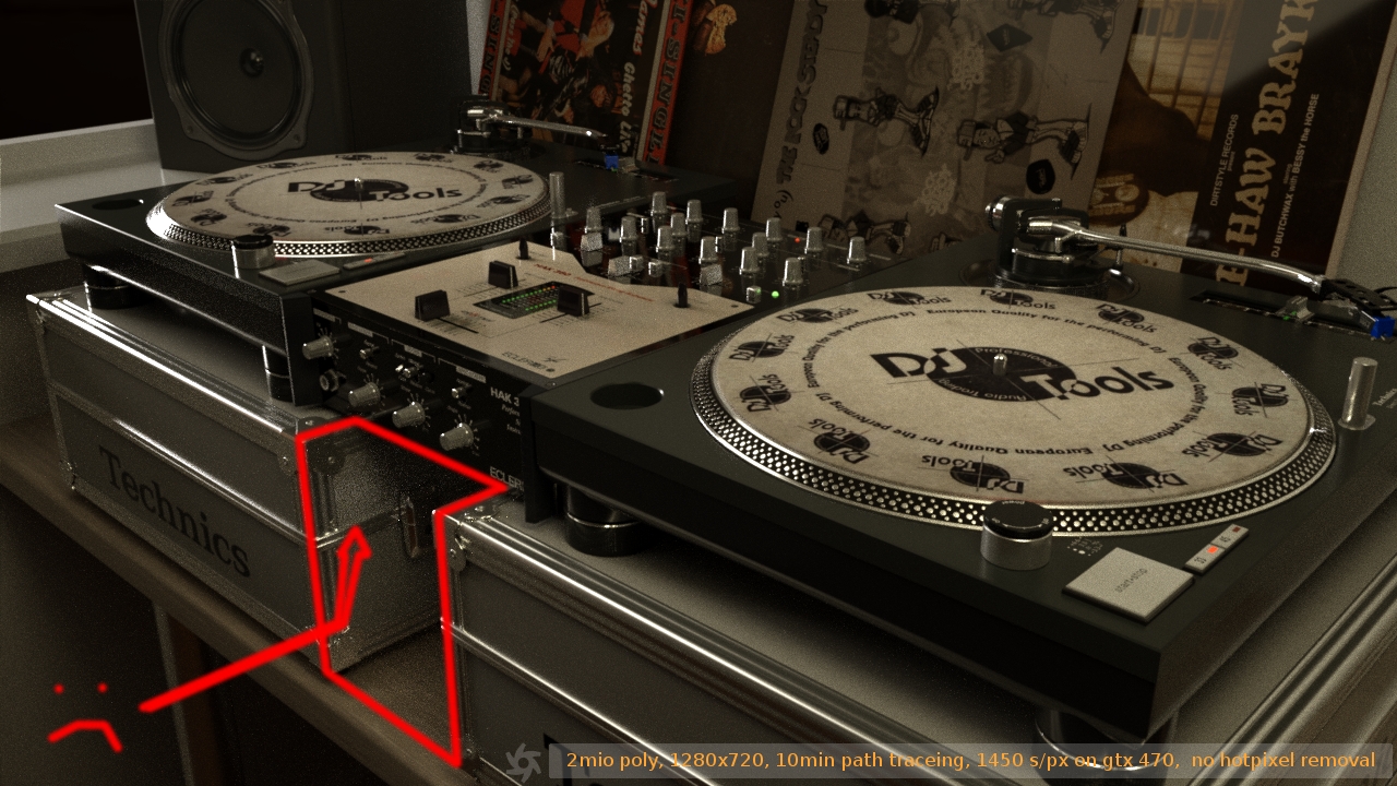

Rendering goes quite fast (2mio polys) but there is a lot of noise under the mixer on the case surface!? Even after 10 min pt.
Any idea what it could depend on?
@joss

More samples
or lesser bump map power if any is used
or lesser maxdepth in the pathtracing kernel.
face
face

What Face says worked for me. Octane defaults with Maxdepth 16 if you try 8 you will render faster and with much less fireflies, the only problem is if you have glass in the scene that it might eventually reflect black if it hasn't got enough bounces. It was a life-saver for me because my scenes were rendering with a lot of noise and fireflies and i had to photoshop a lot before
. I hope it works for you.
