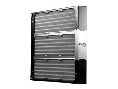

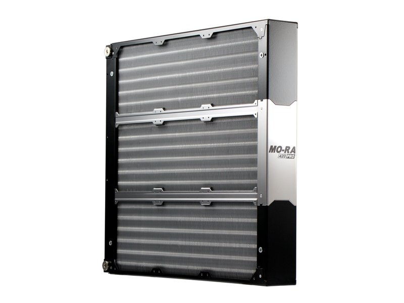

as mentioned by Smicha - case is too small if You'd go watercooling & would like to have rads inside. However, I'd go for external rads, something like MoRa or bigger pieces from Aquacomputer - that would allow You not to change case =)
Oh... the external rad is perfect for this.

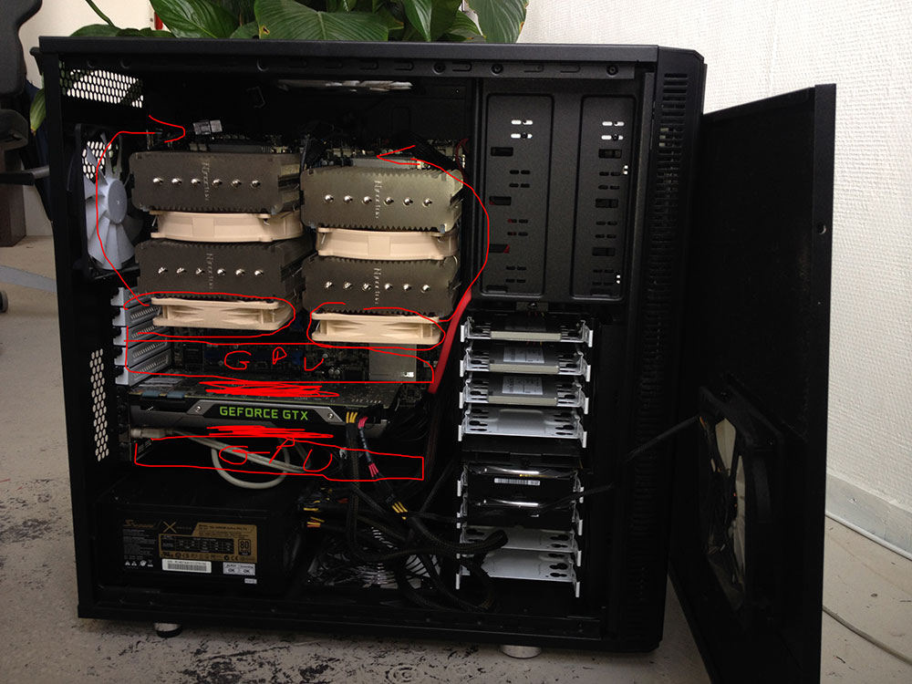

Each of two nocta radiators has two fans - place the lower one on top of the radiator, not bottom. That's it.
Then you can insert 2 more graphics cards, keeping 1 slot distance between them. And it's all about air cooling, no extra costs.

See the photo.
Aaaaah ok! like that
Ok cool, that would be great

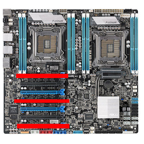

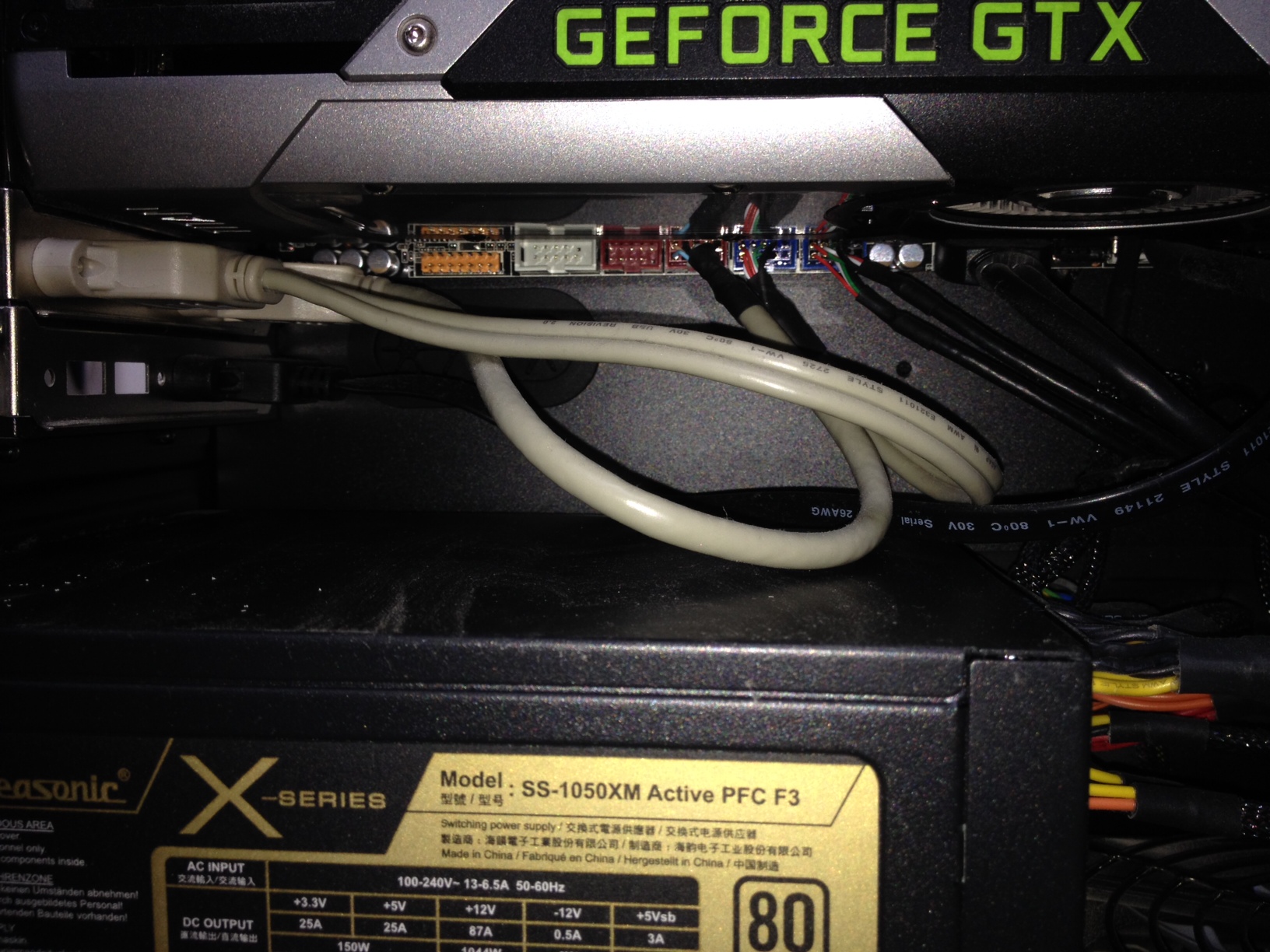

In your drawing I see you drew something underneath the titan black. I dont know if you meant that purely illustrative explaining it would have room for three cards, or that you mean it literal?
Because there is no slot underneath it. See photo.

Red slots shall be taken by gpus
Perfect, got it
Thanks smicha!
