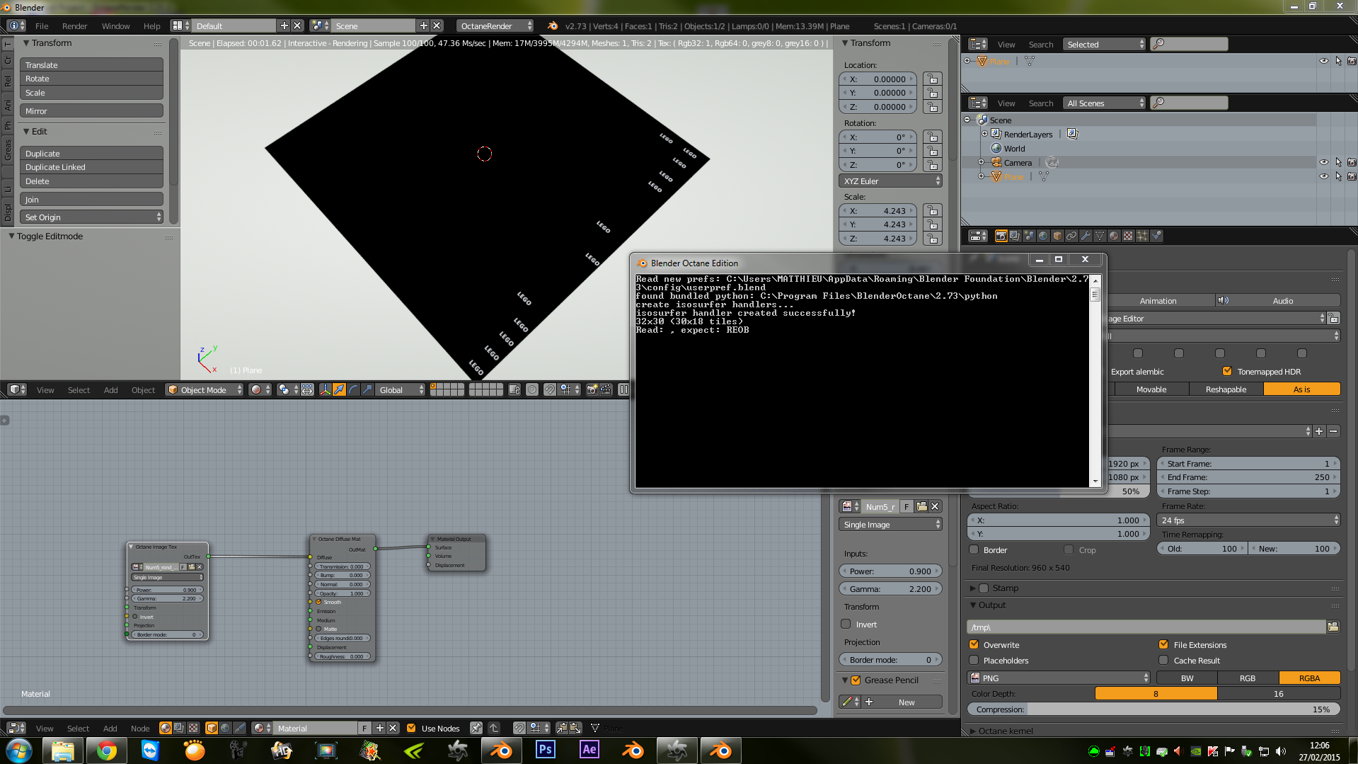

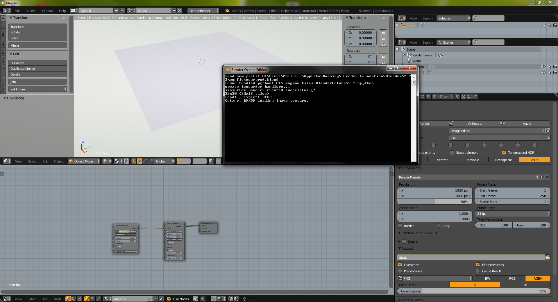

Hi JimStar,
I still have a strange behaviour with building textures with the plugins. I had it before but no error message. Now got error messages with the new version.
At first, all working good with Octane Standalone 2.21.1. One of my work around that not working every time is using the standalone in parallel.
Here a video showing the problem, and after some screenshots of the errors messages. The files textures I tried to build are at the same place for the standalone / Blender plugins. The same problem appeared after a save as of the textures files. Sometime I spend 15-45 min to build the texture for Blender plugins.
Don't know why but quite boring ;)
Hope with this informations below, you'll help you to fix this.
https://vimeo.com/120791076
Hope can help for a fix. As I said, no problem with the standalone.
Best Regards,
Matt
EDIT : THE PROBLEM CAN BE AVOID USING "Automatically PACK into *.blend". But can't be a solution, cause the file become big, really big. So only the mode packed textures + reload texture works fine. It's like the relative/absolute path make errors.

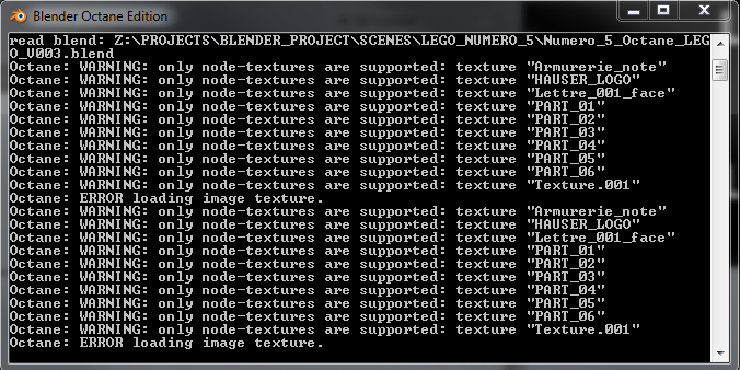

Hi again,
Also, if you know why I got this type of warning :
Octane: WARNING: only node-textures are supported: texture "Armurerie_note"

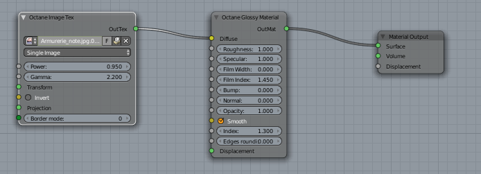

The shader for this texture is like this, very simple :
Thanks,
Matt
JimStar
Posts: 3849

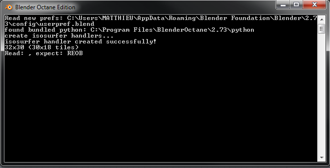

Can you give me the scene where this error is reproduceable on your side (with textures packed in)?
The "Read: , expect: REOB" error is not from Octane plugin. Check your other Blender plugins installed.
MattRM wrote:Also, if you know why I got this type of warning :
The explanation is in the warning itself, it even has the exact name of texture having this issue.
MattRM wrote:The shader for this texture is like this, very simple :
This is not Texture. This is the Material with the name "Material". And you get the warning about TEXTURE with name "Armurerie_note".
You will get these Octane warnings as long as you have non-nodes textures or materials in your scene.

I'll pack the scene and send you in private message. For the REOB, will check from where it's happened in plugins list from blender (will erase all other 2.73 version and app datas, but not have this message in other blender version).

Hello all, Jimstar,
So, I send you the scene link in private message.
Here two videos showing the behaviour with texture nodes :
https://vimeo.com/120876445
https://vimeo.com/120876447
I found two things. The first one, after reset my blender 2.73 (de-install and clear folders for Blender Octane and Octane server and re-install), the problem still here but found it's due to network drive. The problem appear only in the Octane Blender with network drive. If mixed, as in video, network drive and local drive, bugs appeared too.
I use a Qnap system mounted under windows 7 pro x64 as network drive :
Z: == //Nasc6da9f/matt/
This network drive works with standalone without errors, so it's only with the plugins. Also, when pack texture into blender file, no problem cause loaded during file opening in main memory. The blender file is on the network drive, and no problem with it to open it trought network. I use a french version of windows 7 pro x64, maybe a problem with paths conversions.
the second one is the read error. As in video, the REOB only appeared in Octane Blender, not in other builds. It's in the Octane render build, and affect also the texture read cycles'nodes, in this build (the octane render build only, the standard build, no problem).
Hope can help you to found the problem. As saw in video, local paths done no problem, including in refresh texture (automatic).
For the textures warning, found, it was blender render datablock from the plugins "import image as (...plane)"
Best Regards,
Matt
EDIT : After copying images from nas, some images can't be opened by octane server, including if in local drive, but the rigth for this file are all the sames, no different owners / rights.The weird thing, works in cycles render / Octane standalone. Can't found others things that can produce that, only network datas or come from networks (for Blender Octane only)
