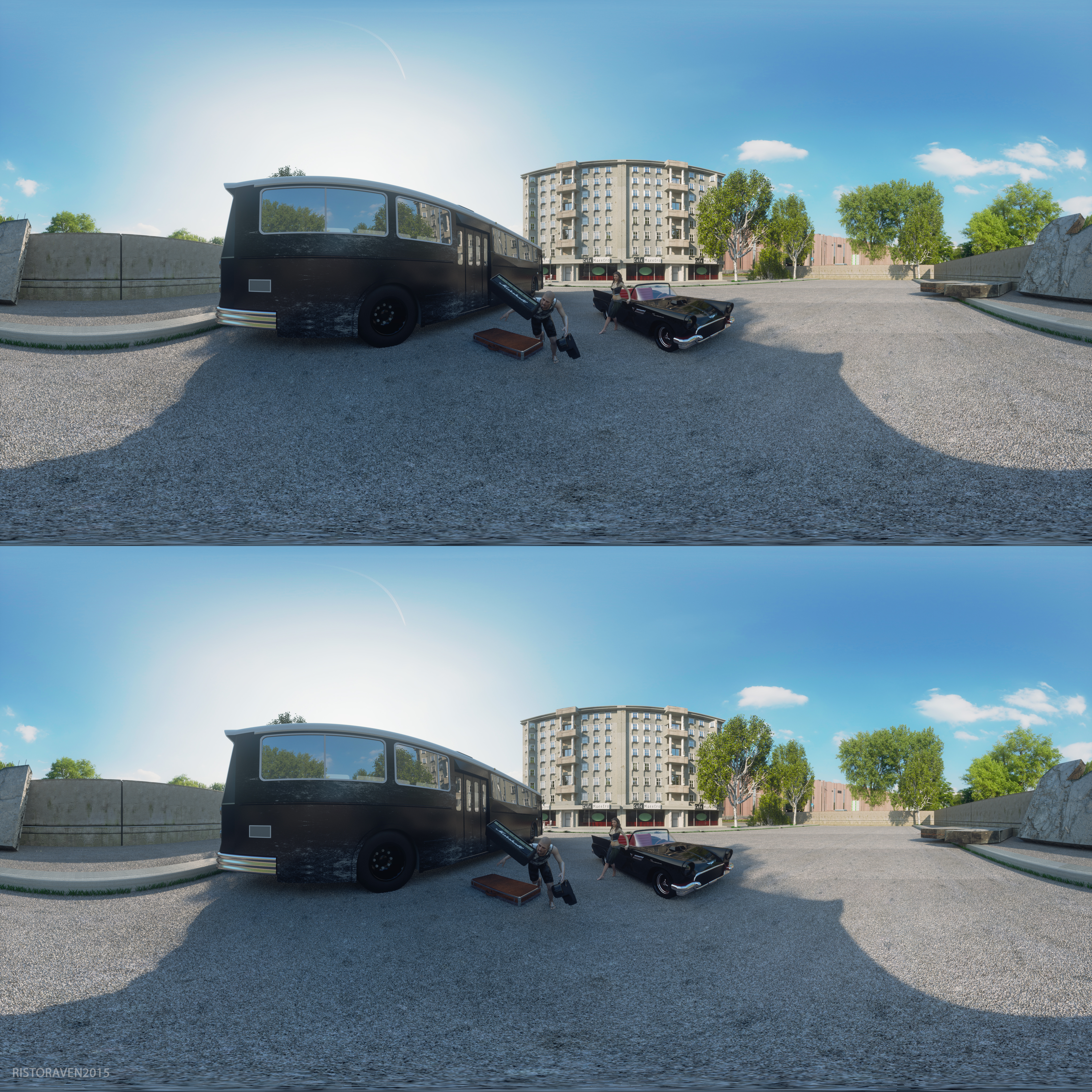

Here´s one test render from one of my little test projects for DK2.
To me this works as a proof of consept.

That above method what I used: rendering two panoramic images (2048 x 4096), cameras 65 mm apart, placing them manually in photoshop on top of each other (left on top) so that the result is 4096 x 4096 image, then viewing them with Kolor player (over/under from menu) ..works pretty okay. Ofcourse it is not full 360, it gets bent and warped when looking back, but, you can render different angles.. Then drag all the (4096 x 4096) images to the player and change the image with arrow keys. It is very demoable. Works especialy to those who haven´t tried oculus before. They are nearly pissing honey with these OR renders.
So, I would recommend this approach.
