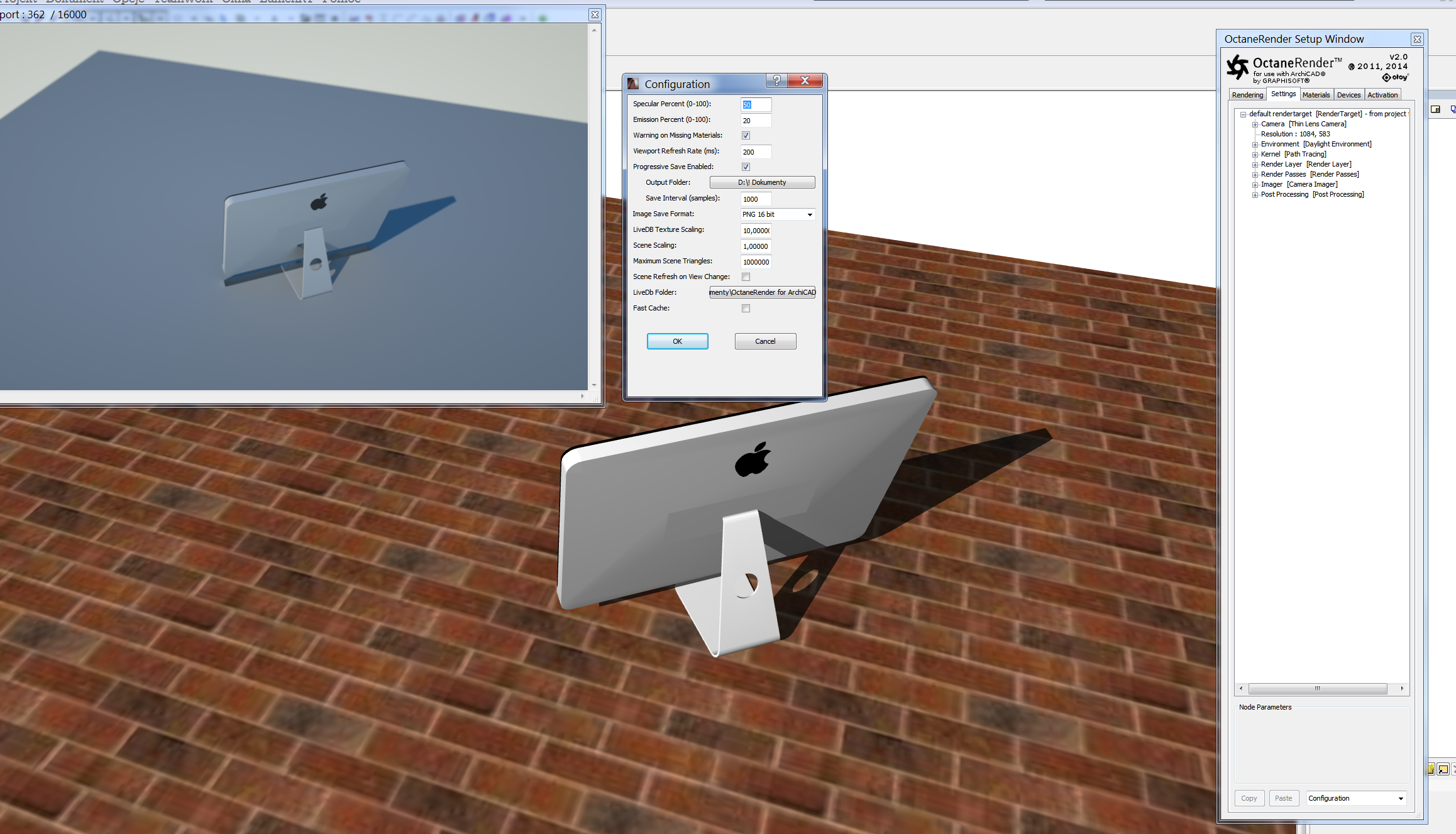

One thing, though - all the materials coming from LiveDB need to be scaled up, say about ten times, what is a little troublesome. There are at least two parameters to be changed (scaled: Diffuse and Bump) and I'm not sure that's all.
Adjust the "LiveDB Texture Scaling" amount in the Configuration.

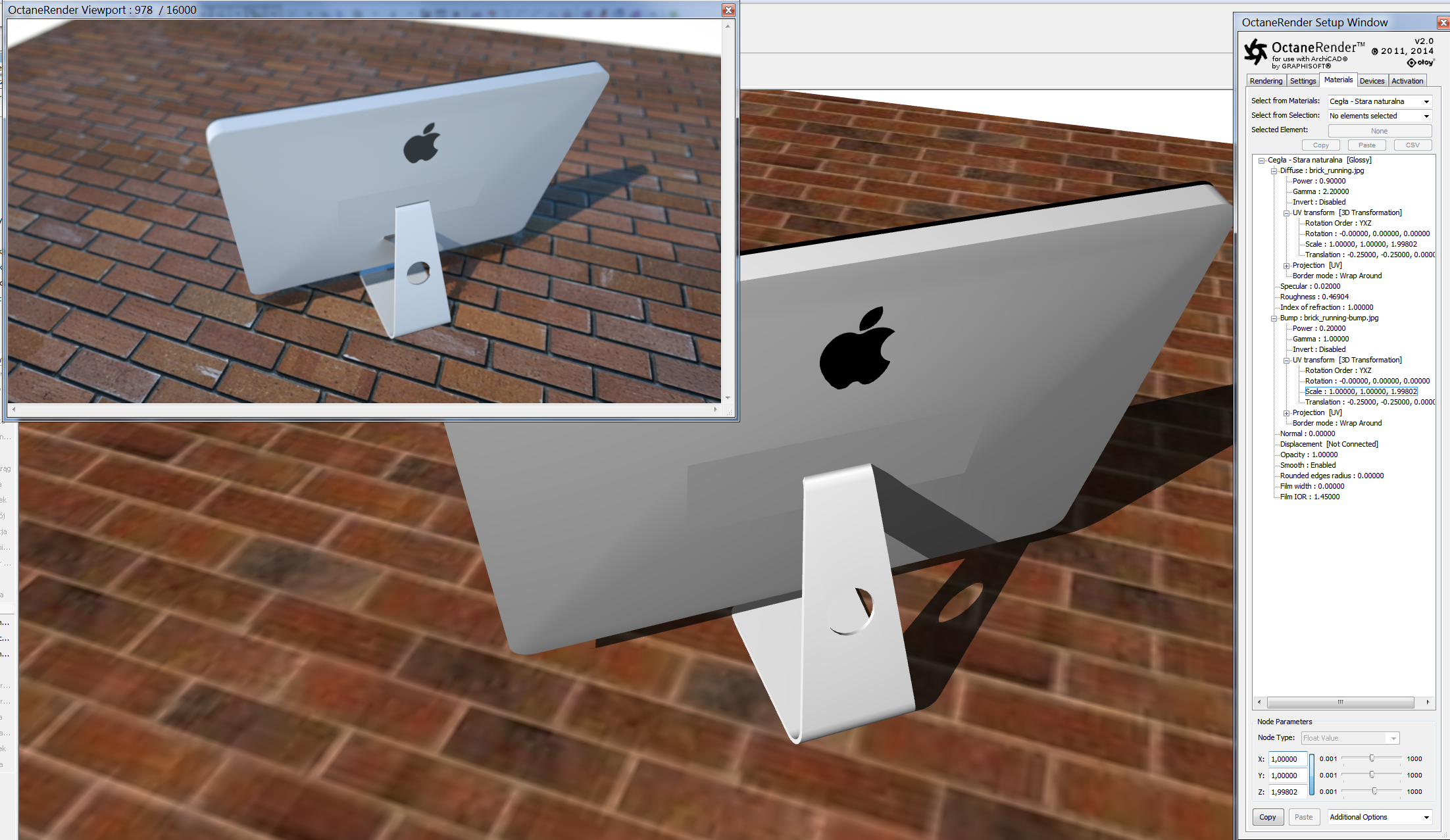

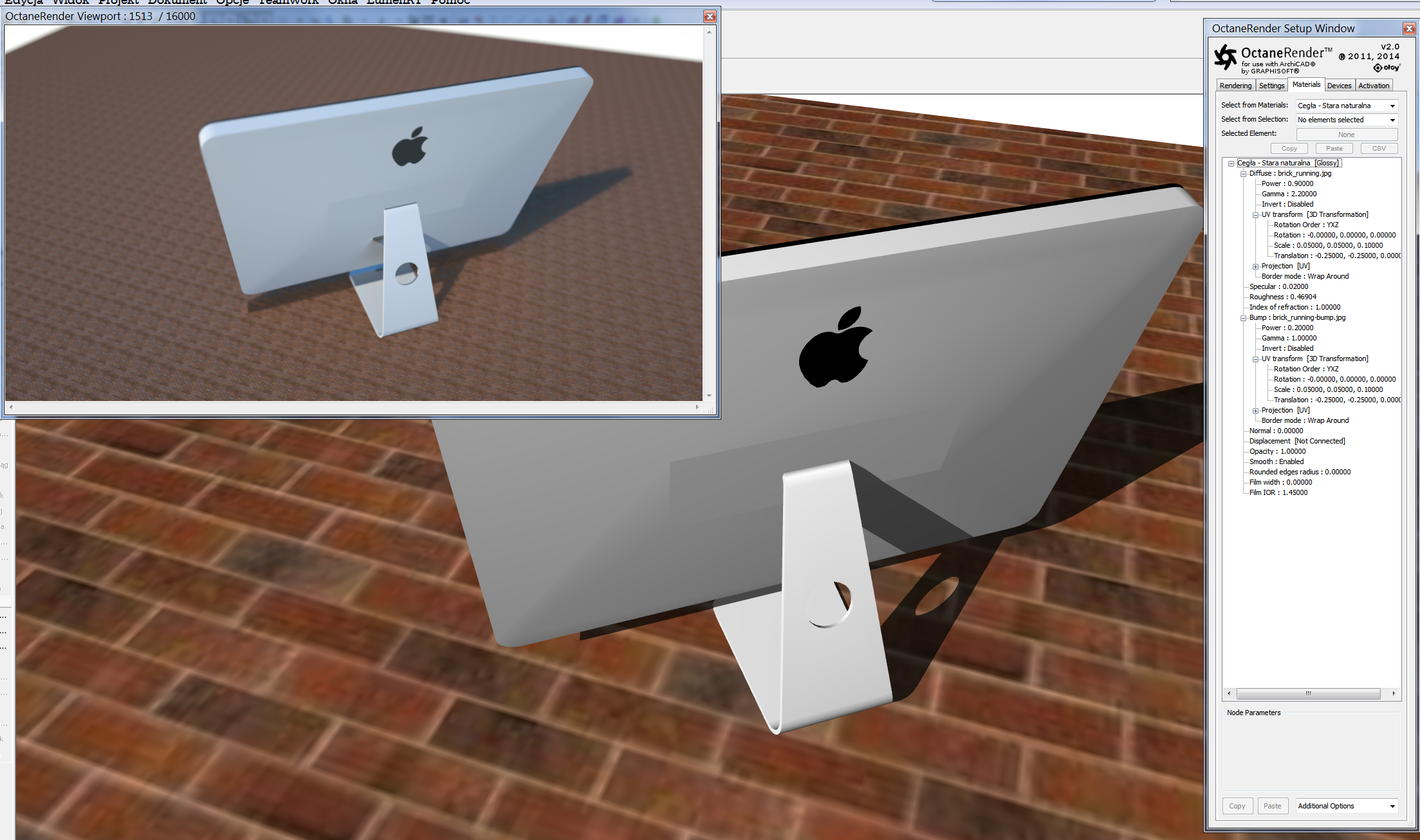

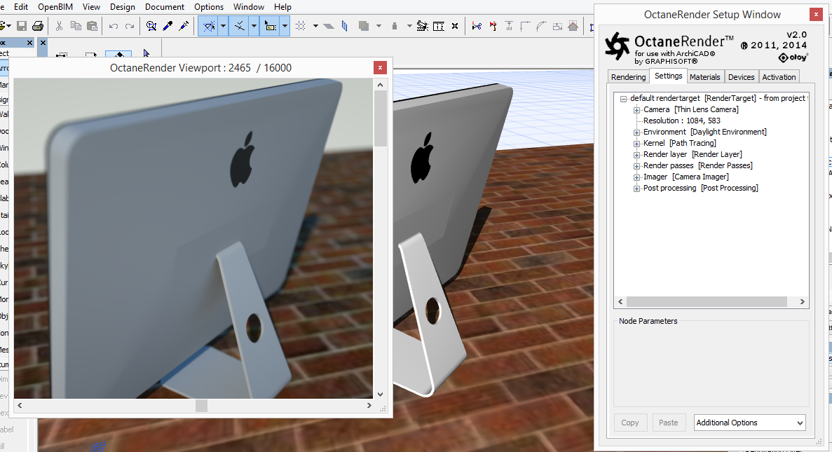

face_off wrote:Adjust the "LiveDB Texture Scaling" amount in the Configuration.
Paul,
It's not working.
LiveDB Texture scaling adjusted to the max e.g. 10 (no more allowed):
(BTW, why you can't see Archicad textures in OR rendering window?)
After attaching LiveDB texture to the surface:
Texture not scaled, obviously. Diffuse and Bump parameters need that (0,05 - first value).
After manually changing above:
Brick looks OK now, first parameters changed to 1,0 - 20 times.
There some textures for instance 'Concrete polished' requiring change of SEVEN parameters (30 times, from 0,1 to 3,0)!
Hopefully it's easy to fix, because OR textures and materials are so real! ;)
Marek

Hi Marek
I am unclear what process you are following to get the images you posted. Are the second and third images from the LiveDb - they seem to have the material name from the ArchiCAD material - indicating not.
The LiveDb Scaling factor does not apply to textures converted from ArchiCAD materials. It's only when you import a material from the LiveDb.
Would it be possible to send me the scene from the first image? I suspect none of the textures are working because they are in the AC library - you need to extract them as per http://render.otoy.com/manuals/ArchiCAD/?page_id=169.

I'm using Material Pipette to pick any Archicad texture.
Archicad texture name stays but after importing LiveDB material has a LiveDB texture parameters.
I think the problem might involve decimal divider, in the parameters window it is dot (US, UK, NZ and Australia, I think), in EU and Poland and my system it's comma.
There is no texture conversion just exchange of them.
Second and third image show imported LiveDB material, second imported as it is, third with the increased values of Diffuse and Bump parameters (20 times).

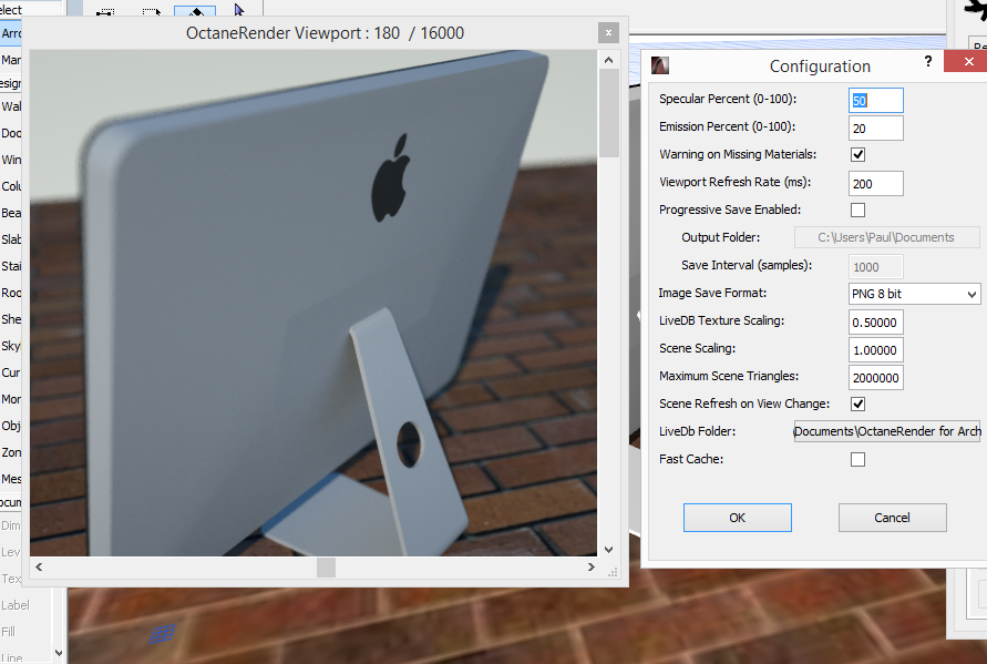

Hi Marek - I downloaded that pla, and it seems to render fine for me (pls see below). It is definitely converting the AC materials to Octane materials for me. I have Scene Scaling set to 1, and LiveDb Texture Scaling at 3. That scene appears to not use any LiveDb texturemaps. If I import "Bricks running" I needed to set the LiveDb Texture Scaling to 0.5 to get the right brick size.
If you think the plugin is having a problem with the 'comma', change your Windows settings to 'decimal point' and see if that fixes the issue. The plugin uses the AC API to do all the number conversion - so I doubt this is an issue - but worth checking.
