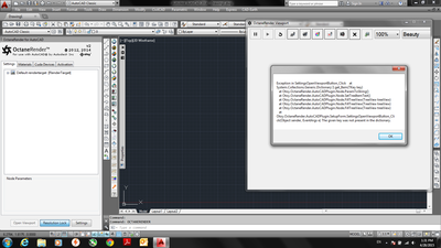

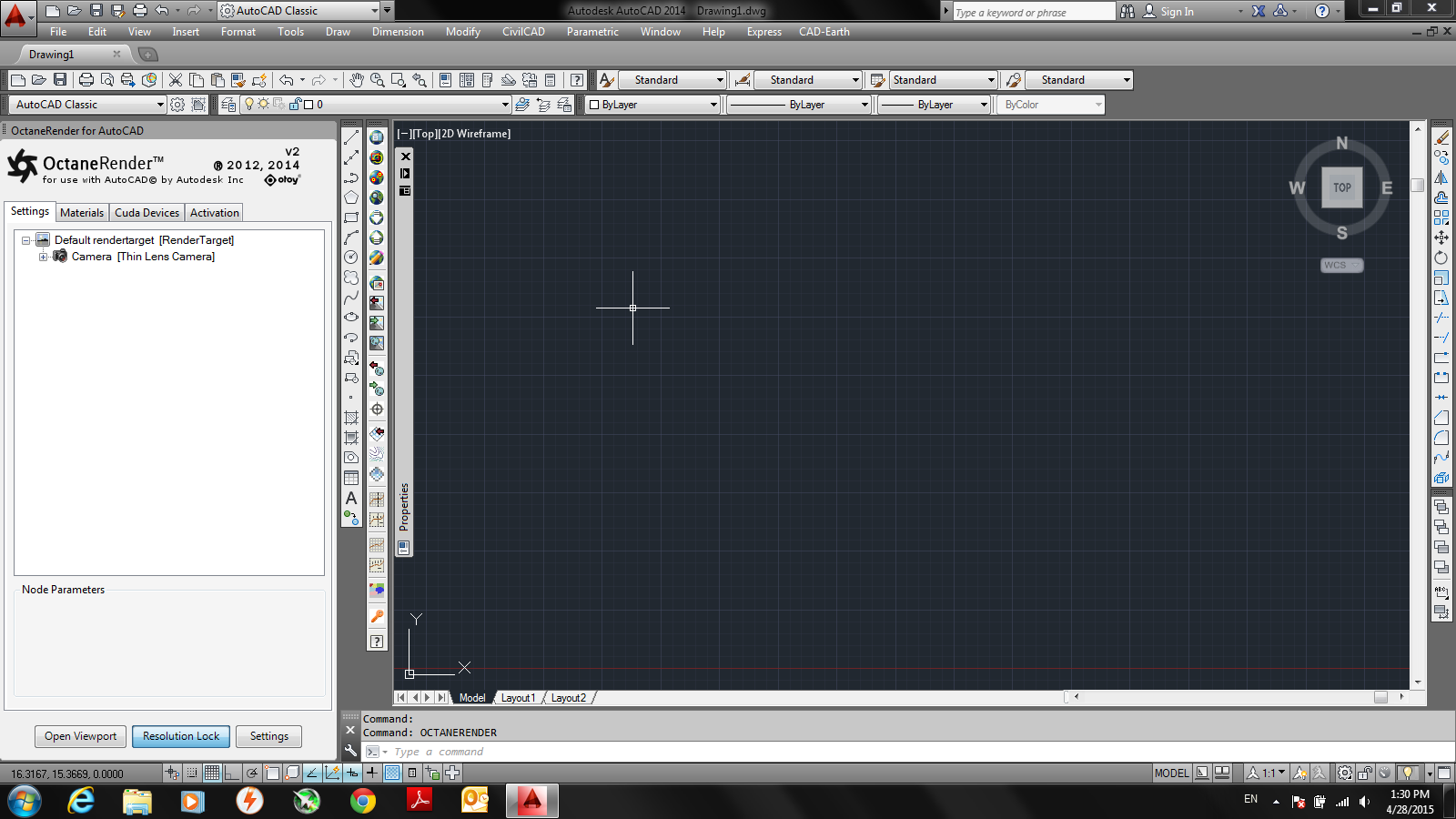

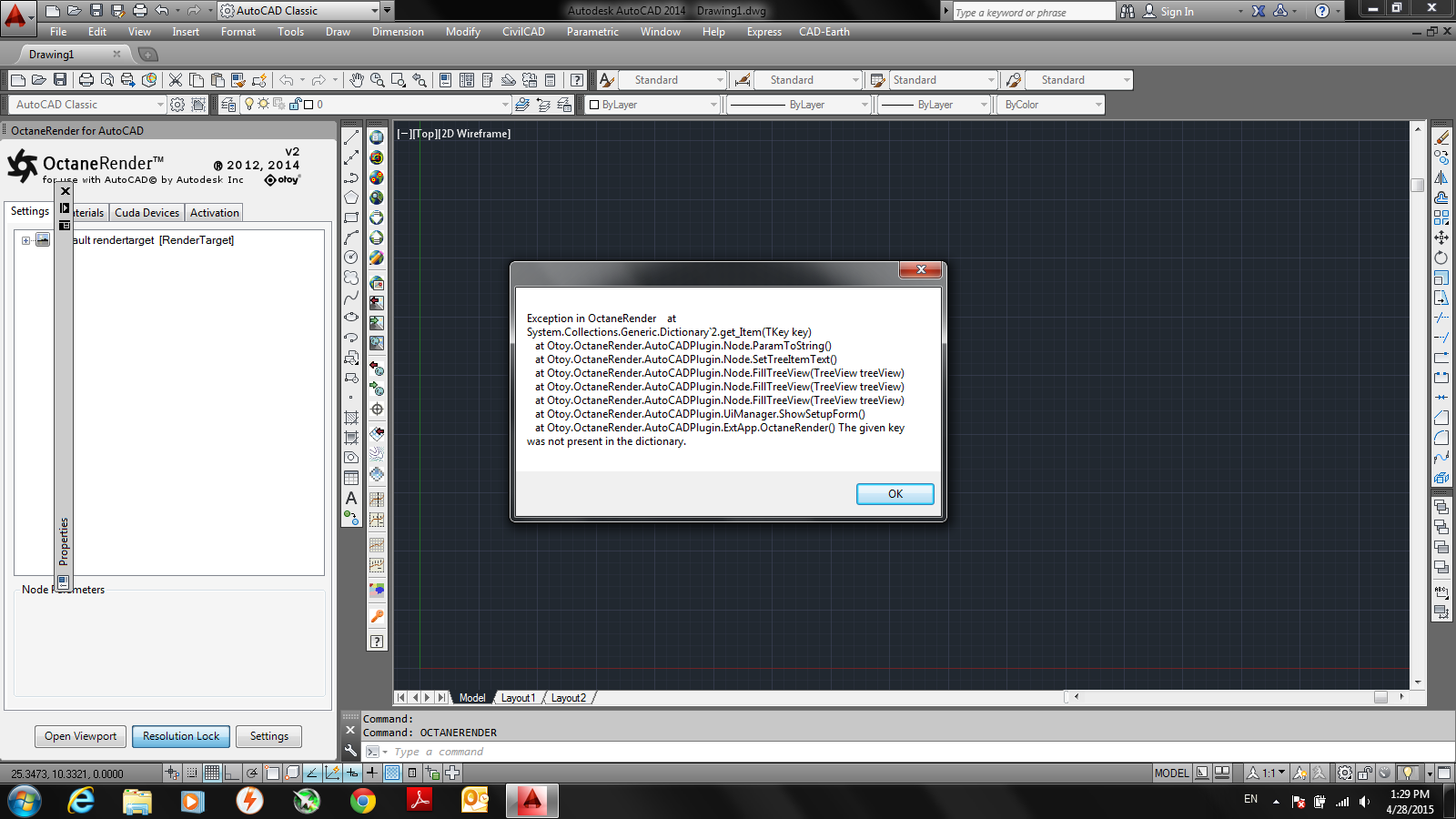

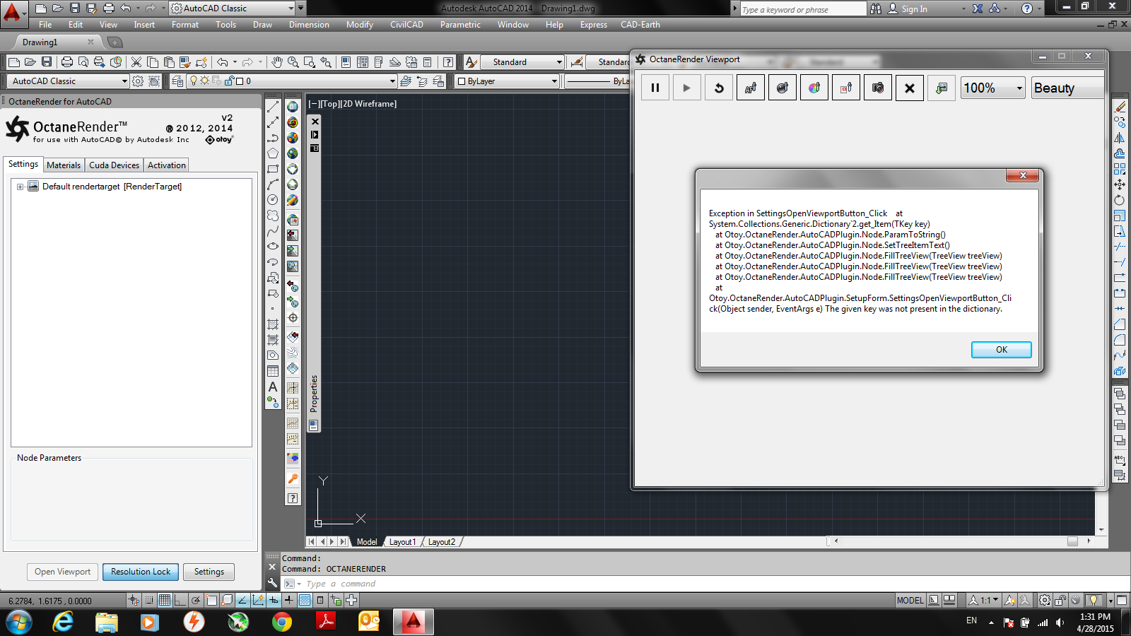

The plugin does not load well with Autocad 2014. Whem autocad start no problem, but when you type the plugin command and start to load it. It only load the camera config in the palette window. Anyway I sent you some pics showing the problem.
Regards
Guillermo
This when you hit render
This is what the plugin load
This is after you type the OCTANERENDER command

Hi Guillermo - I have refreshed the installers at the top of this thread to resolve the issue you were having.
2.22.2.10
- Fixed exception when reading camera pins from a saved scene.
Paul
