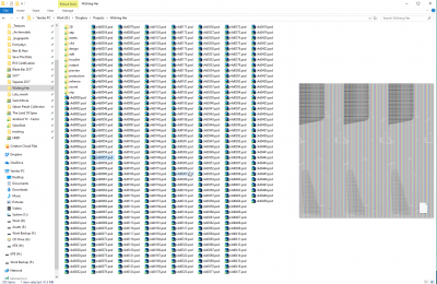

Talking about deadline, Something cause Deadline to render those extra unnecessary files.
Any idea how to stop deadline generating those?
