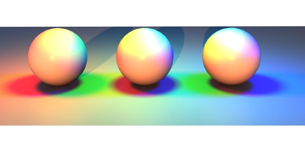

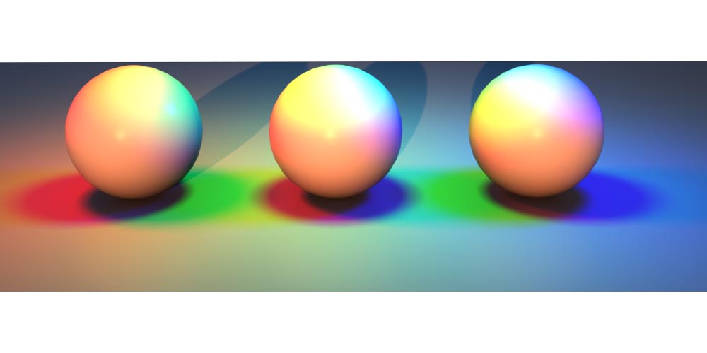

Hi Stratified,
thanks very much for that feature.
Shoudn't all Layers combined be exactly the same as the beauty pass?
I get different results. I'm using Photoshop CS4. Am I doing something wrong?

aufwind wrote:Hi Stratified,
I tried one of my own scenes where the difference is even greater.
Demo Scene, Composite Layers
Demo Scene, Beauty Pass
Yes, the addition of the light passes should look exactly the same as the original beauty pass (that is, before you start tweaking the lights).
Make sure everything is done in linear color space. Ideally, export the images from Octane as untonemapped exr (be careful, PS doesn't support multi-layer exr without the exr pro plugin so you have to export them as discrete files in that case). I think you can configure the color space in PS as well but I don't know how to do that.

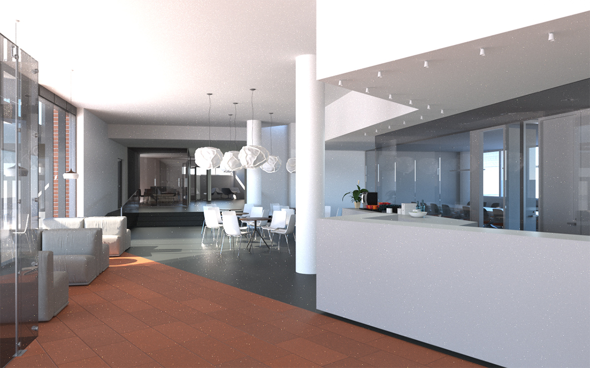

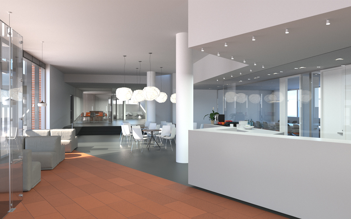

I'm having a rather large problem with the Sunlight pass though. Beauty looks OK, all the other light passes look fine, but the Sunlight pass has loads of fireflies all over the place. What gives? Example render attached. I used GI clamp = 3.0 for this scene and it makes the fireflies disappear from the Beauty render. Sunlight is basically unusable though, and that means I can't use any of the other light passes either.
Does anyone know a solution to this problem?

Posts: 10637
hi,
it's a bit hard to say what is the cause of so much noise without the scene for testing.
Have you only the physical sky or you have also added an environment HDRI in the Physical Sun properties?
What happen if you switch to Clay render mode?
The noise is still present?
ciao beppe

Thanks for your reply bepeg4d!
The scene is lit with the Daylight environment, no custom HDRI is present. As mentioned, the fireflies are only apparent in the Sunlight pass, the main render looks absolutely fine. Clay rendering doesn't look much different since there is glass on the exterior windows which blocks all sunlight if Clay mode is enabled... :P Now that I think of it, it's probably worth testing to hide the window glass from the scene since there's really no visible reflection on the glass surface, and having glass on the windows only serves to slow down the rendering. It's a likely culprit for the fireflies, since the sunlight is pouring in through the glass.
For testing, I disabled the interior lights which makes the fireflies more apparent in the Beauty render as well. Likely the artifacts are just less visible when the composited render adds the contribution of the other light sources on top of the sunlight.
I'll update this thread after removing the glass from the windows, to see if that gets rid of the fireflies!

ParviainenArk wrote:Thanks for your reply bepeg4d!
Removing the glass will get rid of the fireflies but it changes the lighting in your scene. You can try to make the glass a bit a rougher or set the caustic blur in the kernel node a bit higher.

ParviainenArk
Posts: 11
Joined: Fri Oct 31, 2014 10:40 am
Will try to adjust caustic blur, thanks Thomas!
Removing the glass did indeed reduce the fireflies, but as you said the lighting changes a bit.
