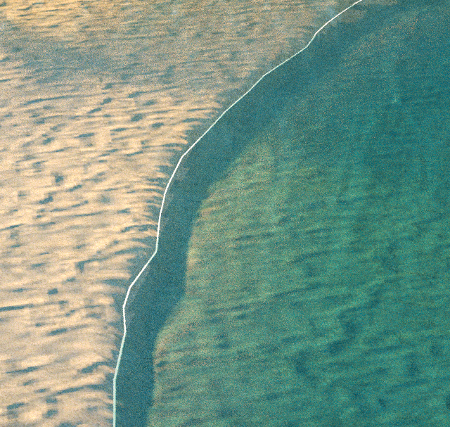

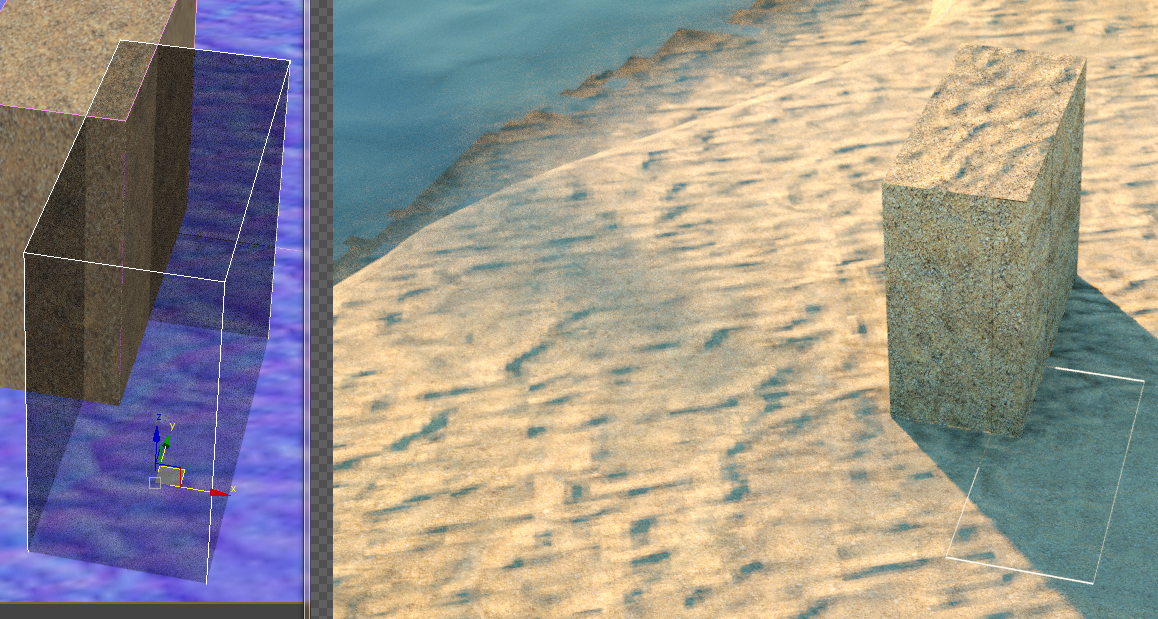

white line between the intersection of two objets with opacity, not matter if its diffuse, glossy or specular material, no matter kernel or gi mode, always appears.
there its a way to avoid?
octane for max 2.15

noelnoel wrote:white line between the intersection of two objets with opacity, not matter if its diffuse, glossy or specular material, no matter kernel or gi mode, always appears.
octane for max 2.15
Try to enable Alphashadows I think i had this problem when I used dirt material and no alpha shadows enabled http://render.otoy.com/forum/viewtopic. ... ne#p211354
i think it is a dirt bug in my case
