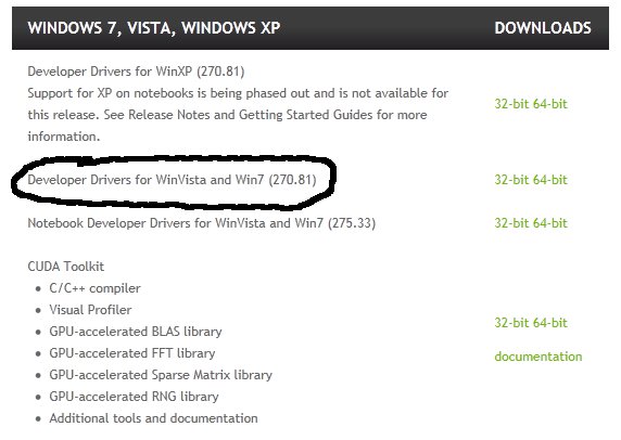

There is talk of "Developer's" drivers, but I don't know what they are or where you would get one.

On the same nvidia site where you get the latest cuda toolkit you can get the latest developer driver too...
