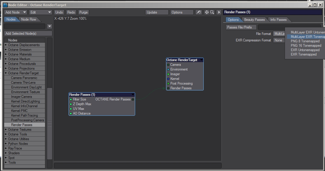

i'm in trouble actualy with multi-channel exr output ( or multiple PNG saving for each channel selected simultaneously ), because it would be handy actualy on the project i'm working on.
Can anyone can share a screen capture of a nodegraph showing this, because the only solution i see actualy is to render sparately the channels wanted with the infochannel node plugged on the render target one...
thanks

that is what i gathered: i don't have this render passes node on my version : the reason should be that i've just replaced the Dll/*.p files for installing the new 2.1.2 version: it happenned already one time, monthes (years ?
) ago: so i have to reinstall properly it...
anyway thanks again for your permanent help for the community

You need to add the plugin again to the Layout if you don't have this node. Remember to remove the octane master plugin before update the plugin.vipvip wrote:thanks a lot, Juan,
that is what i gathered: i don't have this render passes node on my version : the reason should be that i've just replaced the Dll/*.p files for installing the new 2.1.2 version: it happenned already one time, monthes (years ?) ago: so i have to reinstall properly it...
-Juanjo
