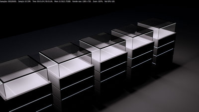

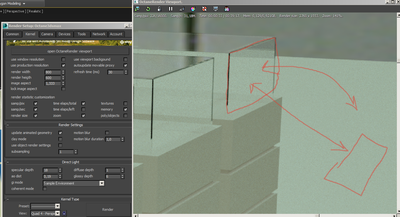

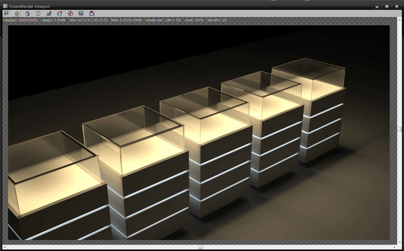

Thank you that you started talking to me!!!!! I broken the translator --- will try in some way to Express my opinion. I understand how this is funny to read but I don't know English. 1. I have great respect for your team. The team who created this project. Octan render!!!! 2. I always love the render and make it a decent well-paid commercial projects!!!! THANK you !!! I raised this question on noise only because I want to see octane as a universal render and not to jump from one renderer to another. If there is a problem with the glass and my commercial project begins to rotate due to the fact that I have to wait 20-30 minutes to 1 picture and I was planning on 3-6 I get into the knockout. The client says I want that would showcase glowed = all I in knockout I have options: 1. to reduce IOR - but it is not glass 2. falloff opacity - but the noise does not disappear 3. falloff reflection is not bad but it's not glass 4. PMC - Yes but the knock-on time .... if this question is not to decide and write I'm just going to warn customers and to make adjustments at the time of my commercial projects
Goldisart
Posts: 780
Joined: Sat Oct 26, 2013 8:47 am
GTX 780 - 6GB + GTX 780 - 6GB + GTX 590 = three video cards must be replaced at least 9 CPU - I only have 4 cpu 4*8 = 24 cores easy to skip through the glass light - and it turns out that there are a bunch of fireflies due to the reflection..... Yes and the client wants to see pure gloss - this is a problem.. I don't know whether it is possible to make a fake octane - such as it is implemented in CPU rendering). If not, PMC or more render time me time - time is money ! Octan render animation allows me to do very quickly!!!! it quickly loads the large scene - when the render farm still think. In octane is very much a plus for it and love it

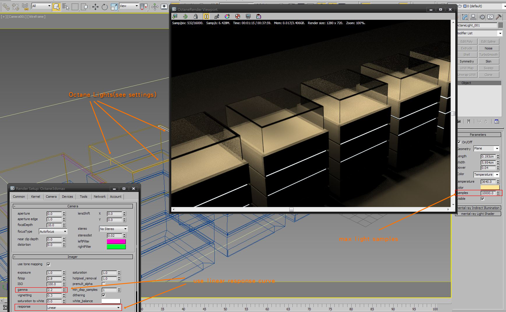

I replaced one of the mesh emitter with 3 octane lights, and set the lights' samples to 10000(max number)
And use linear response curve for the imager setting.
The result is obviously better than before.
p.s. the unit setting of your file seems wrong, the "Display Unit Scale" of unit setup panel is not the "real" unit settings.
The "System Unit Setup" button is where we set the unit of the scene, it's millimeter in your file. It should be centermeter in this scene.
That's why you had to lower the power of lights in this scene, because everything is 1/10 to their real size.

akira wrote:I replaced one of the mesh emitter with 3 octane lights, and set the lights' samples to 10000(max number)
light samples don't make any sense here. You reduces noise for one light source but increase the noise for other light because they get less samples.

Karba wrote: light samples don't make any sense here. You reduces noise for one light source but increase the noise for other light because they get less samples.
Ouch, you're right.
Well at 16k samples/pix(path tracing) i can get rid of the noise, it looks more like film grain than noise.
p.s. Mr. Goldisart about the shell modifier, you need to check the "Straighten Corners" option at the bottom of the modifier panel to keep corners straight.

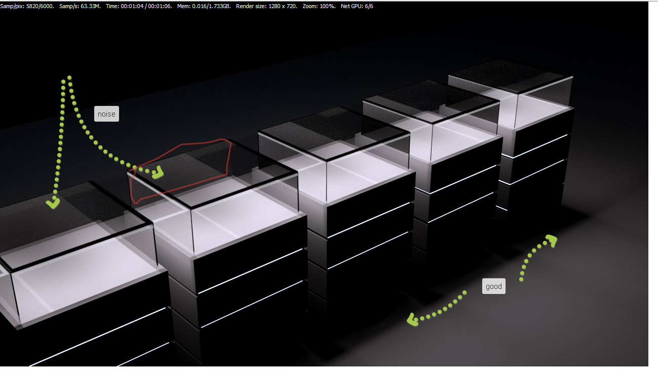

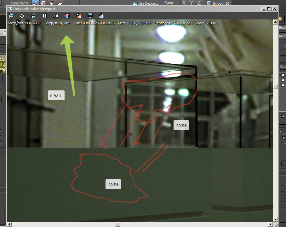

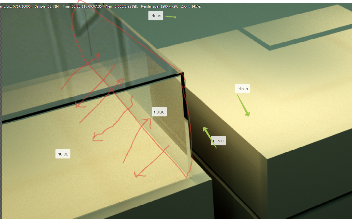

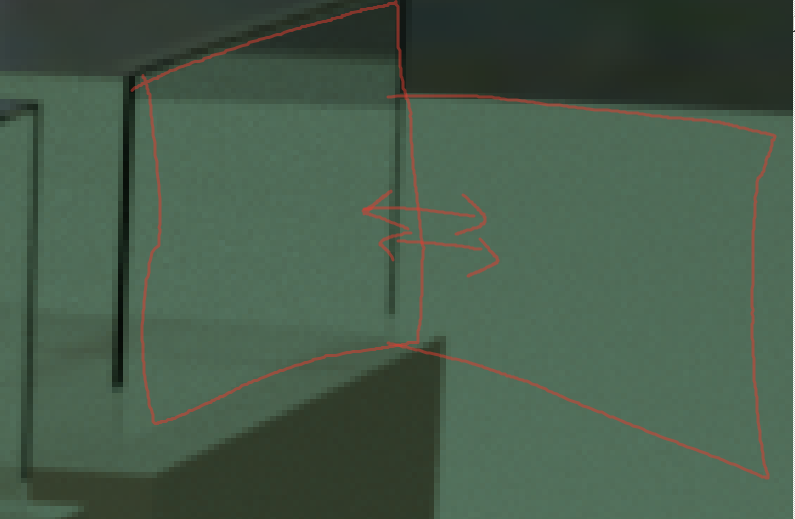

I think that this is not a problem of light .... more it seems that this is the "problem of reflection" (a distinctive feature of the photographic grain). the reflection in the glass synchronously with the reflection of the floor which is usually for the GPU. When the lights are turned on it starts to produce noise === reinforcing it several times and begins to intensify film noise. in this situation it is necessary to wait until the environment becomes clean
