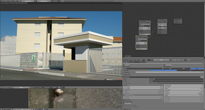

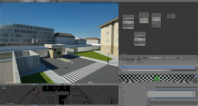

First, I allready rendered a video on Octane, this is one image of it: Image, so I´m not a new user to it.
Second, lie is intentional, by law ignorance about a fact is not lie, its just ignorance, I tought that I had this version because I have more than one computer, and i think that I downloaded this version for the other, and my mistake was to get confused, and if you are ablle to determinate which version of the plugin I use, why ask me for this information, since you allready had it? ;)

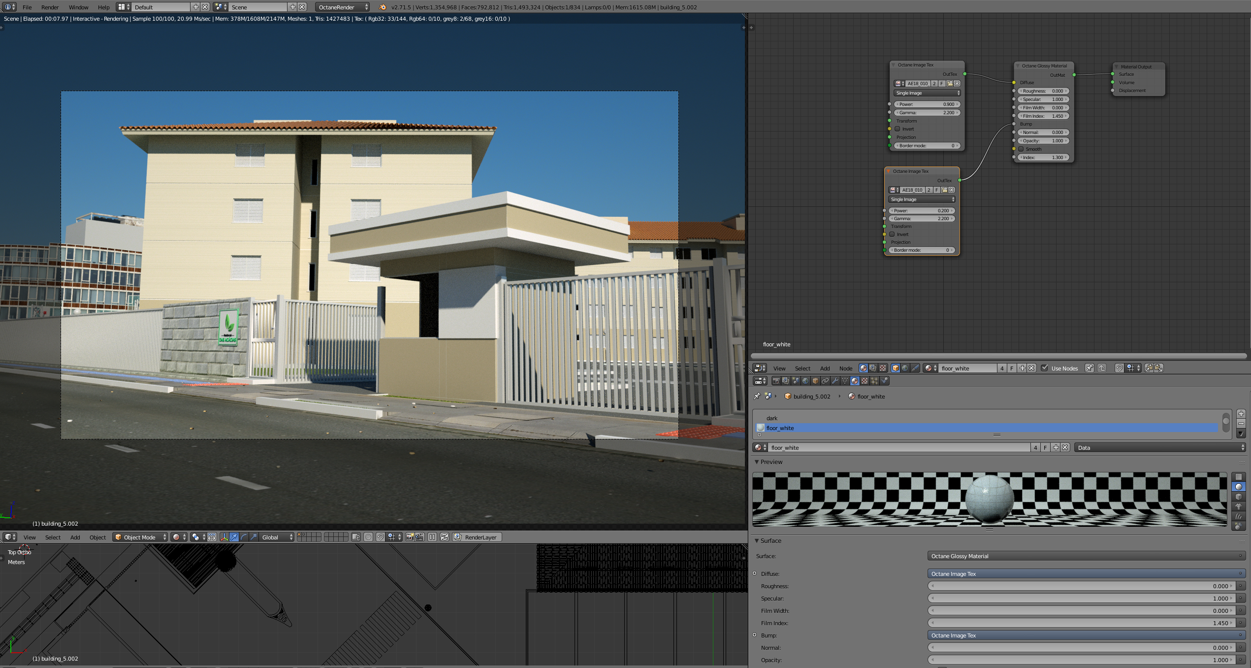

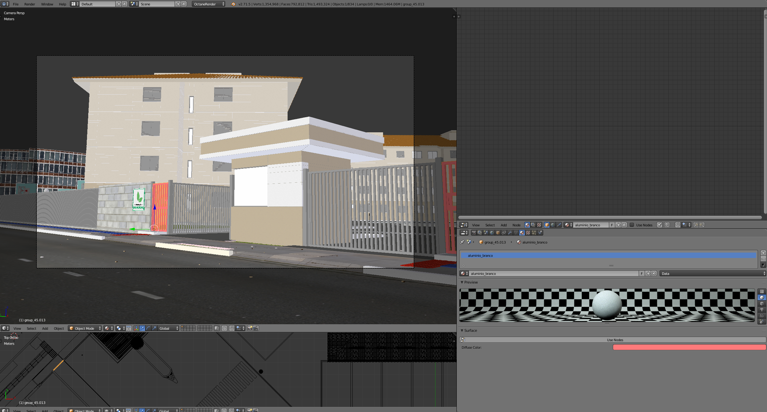

leonnn1 wrote:Here you can access the file, I deleted the more heavy stuff to send it to you, otherwise you would have to download 300 mg file, but the problem persists on this too.
If you open it and check the material shading, you will see that it shows the materials as they should be, but if you see the rendered shading it will not work properly.
OK, I've downloaded your scene. Opened it in the plugin 1.55 - 5.2. Unpacked texture files. Tried to reproduce what you are reporting still happens in 5.2. It works absolutely OK.
And I remember exactly that the similar issue (materials swapped in some cases on the server after render refresh on the client) was found in some pre-5.0 beta versions and it was fixed starting from 5.X.
So, I asked my wife (she is experienced Blender artist: http://3d-look.com) to play with your scene back and forth inside 1.55 - 5.2 - she spent half an hour trying to achieve the wrong materials inside the render view with absolutely no luck. It works without any issues. It always gets the same materials on all objects of the scene after every live-view refresh or viewport mode switch. Material preview always shows correct materials of chosen object.

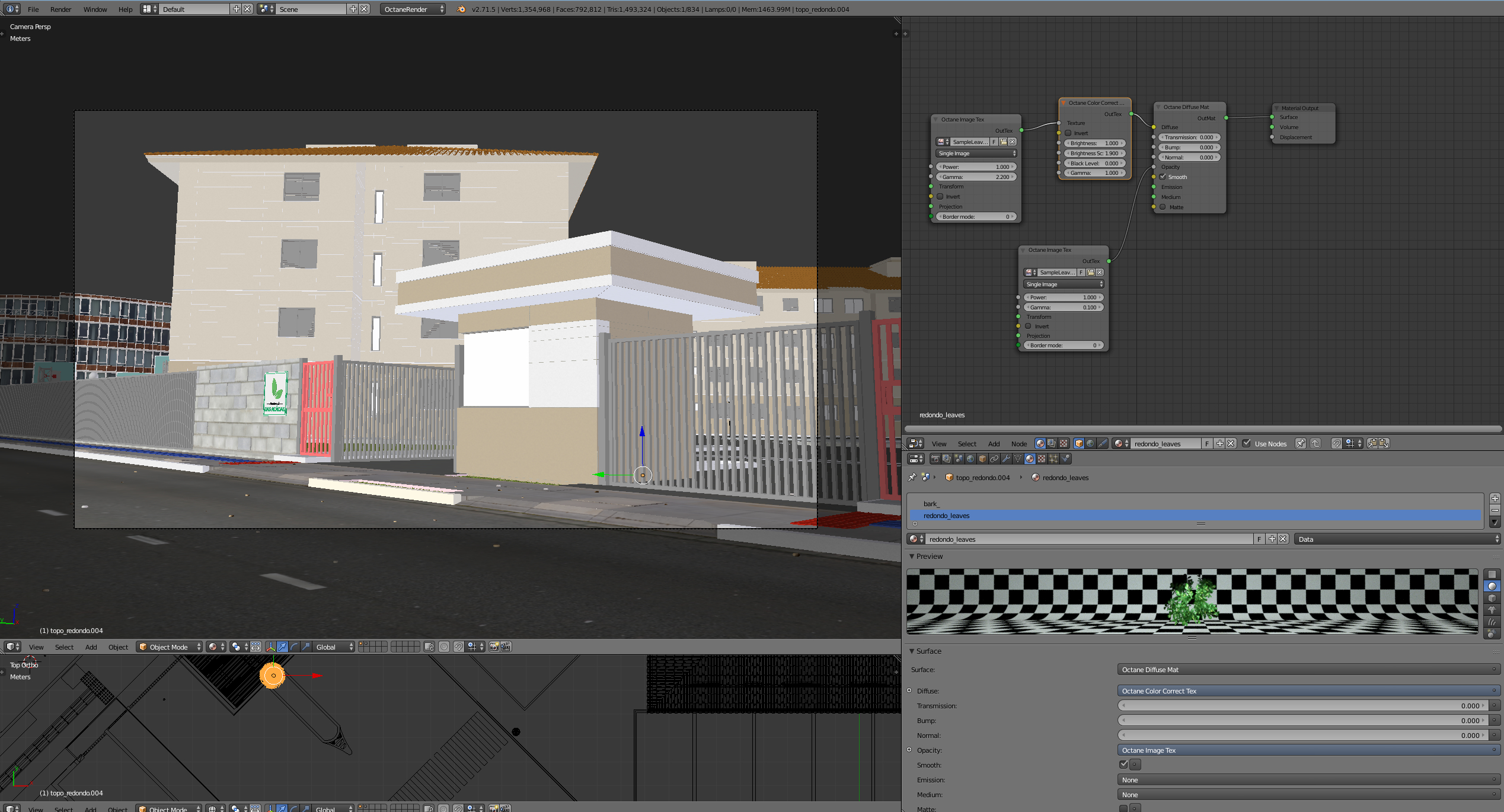

What is always shown in material view:

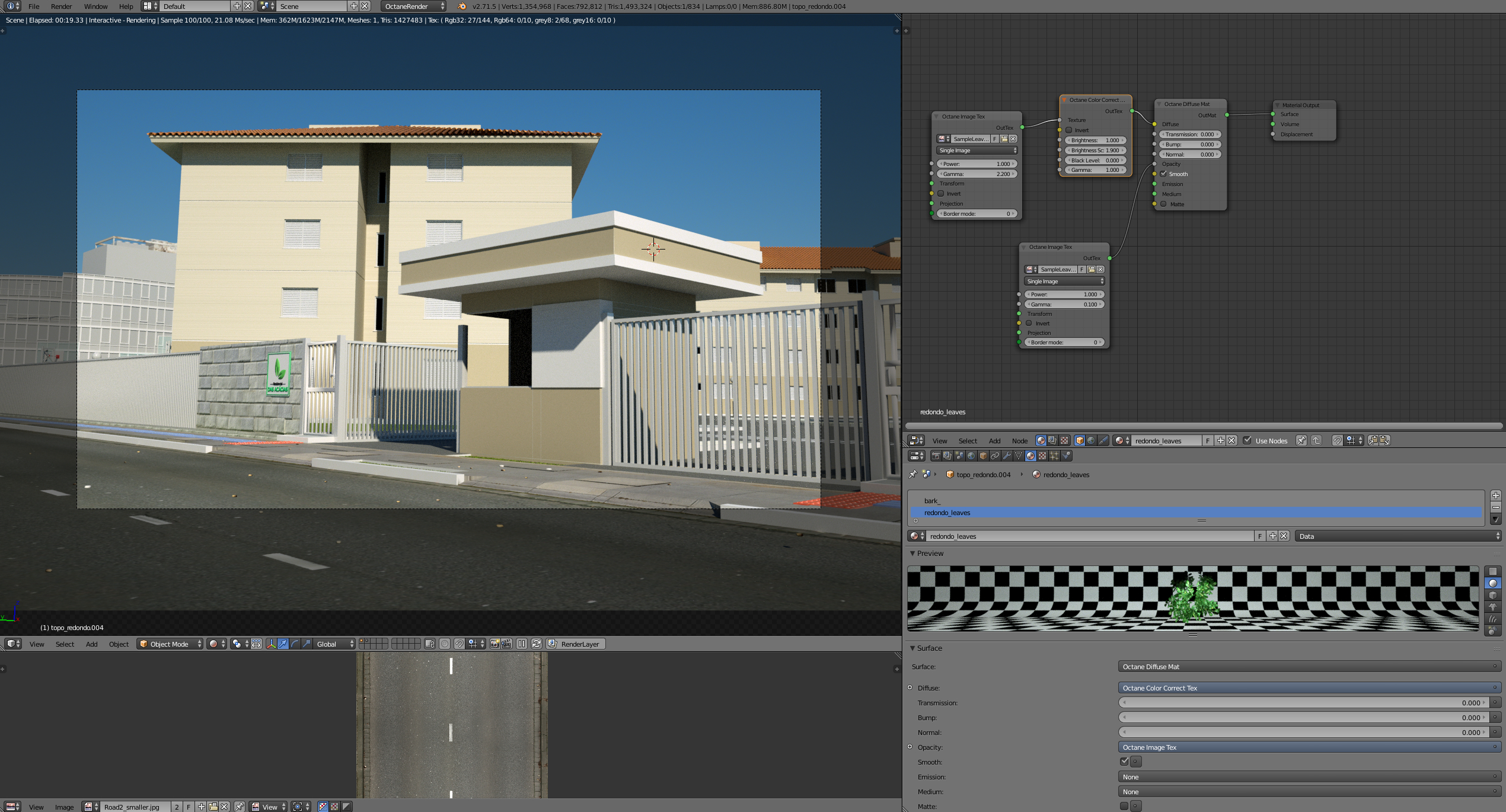

What is always shown after going to Octane Live-view:
On these first images, you can see the background building on the left, which has texture visible in material-view, but default Octane material in render-view. The reason of that is simple: I just by intention did not spend the time unpacking all the textures of background objects, as the amount of foreground objects is enough to see that all works OK. So, this background object just has textures not unpacked.
As soon as I unpack the textures - this object always shows absolutely OK too, in both material view and render-view, no matter how many times you switch back and forth.
The material of the fence (where you can see is "red" in material view) as seen is not set at all, it is not even the "node-material" - this is why it is always shown differently in material view and in Octane live-view where just default Octane material is shown. There are a lot of such not set materials in this scene.
This is the F12 render result:
