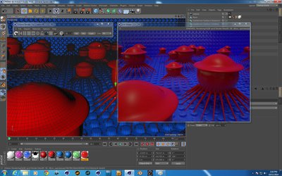

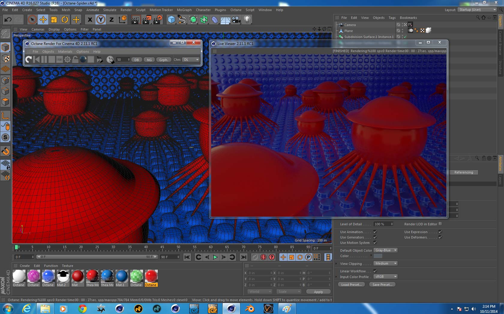

I'm seeing a strange gama-shading behavior. Using R16. Have not tested in R15 yet.
When I first open a scene and it renders in the Live Viewer, I get one result (see Octane-Spiders_1).
Then if I navigate the scene or just select some object in the scene, the Live Viewer renders
the image different (see Octane-Spiders_2). I get the same result with Direct Lighting and Path Tracing.
Am I doing something wrong with my scene set-up or is this some other issue?
