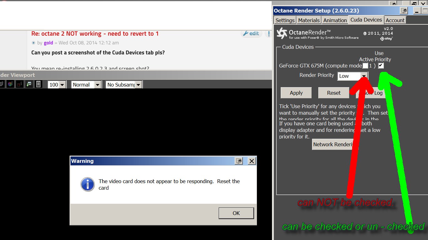

Can you post a screenshot of the Cuda Devices tab pls?
You mean re-installing 2.6.0.2.3 and screen shot?
Or try installing 2.10 ? { test version? } and screen shot?
Either will be fine.

Here you go:

Is it possible you have your Windows font scale set to 125%? If so, return it to 100%, tick the box, then you can return it to 125%.

wow, that was weird. Can we possibly get you a job to work on windows 10? lol
Yep, working now. Do we need a font setting button in Octane 2.15?

Good that you are up and running. The font issue is to do with PoserPythons use of wx.python. I will dd the specific situation you had to the FAQ.
