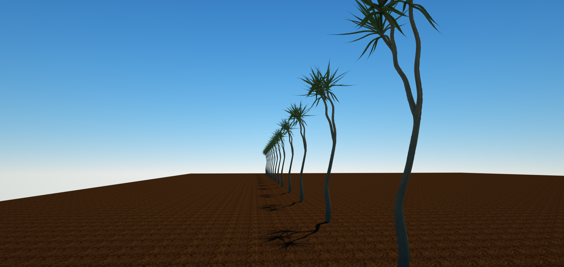

Hi Paul,
The problem with "all you need to do is randomly rotate the proxy host objects" as you suggest is that it is a very time-intensive exercise. We would have to change both scale and rotation parameters for EACH instance - that is a lot of work for trees or other foliage.
Yes, the Revit host object could be adjusted after the rotation in the proxy settings (retaining this functionality and being able to change the Revit host properties after the fact to tweak things will still be beneficial for individual objects). So here's the request:
Have an option adjacent to each of the size and rotation parameters to set a 'random variation' value - if it's zero, the proxy object respects only the entered field data (which solves the Xfrog X=270deg anomaly issue). If a value is entered (say a percentage) then that placement value is adjusted for the relevant factor.
This would help a lot!
Here is a screen-shot of what we get currently without manual rotation:
Tree soldiers
Tree soldiers
Best,
Seeker

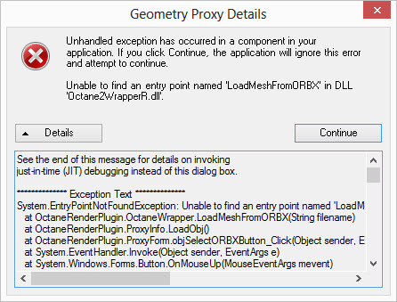

ORBX proxy issue.
Revit 2014, Win 8.0, Plugin version: 2.12.1.18
Hi Paul,
I tried importing an ORBX file for the fist time and got the error below (dump file also included). I note your requirement:
face_off wrote:The ORBX file must have one single unconnected Mesh node in order for the inport to work.
Does that mean it can not be attached even to a render target node? I guess this would make sense. Will try it without the render target node.
Best,
Seeker
PS: It would be useful if you update the manual when you get a chance - between the 517 other manuals you have to keep abreast of...
UPDATE: Removing the render target node did not help.
Also, please note that the mesh file is an alembic / .abc file, not an OBJ file - could this be a current limitation of the plugin? If so, could you remove the limitation to include alembic files?
UPDATE 2: It seems like it might be unrelated to the alembic file issue as I also now tried an ORBX file containing only a singe OBJ mesh file with no nodes.
orbx import dump.txt
(18.44 KiB) Downloaded 535 times
