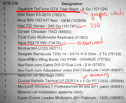

I have make a PC on last june speficially to use Octane render
This is my config :

i think last one is PSU(power suply unit). 1200w is well.

1. GPU Have Some Limitation....
GPU Voltage.... GPU Temperature.... etc
You will Need Much Powerful PSU (Titan TDP is 250w each)
Two titan=500w + Cpu 90w~130w + M.B HDD etc etc.... Think...
You can use GPU monitoring tool...( GPU Shark )
2. Need Hardware Speed Optimazation
Force Enable PCIe 3.0
Most Powerful CPU....
3. Need Scene Optimazation.
Large Size Texture to Optimal Size Texture (inc Optimal Size Hdri Map)
Few Light & Small Light Sample
C4D Generater to Mesh (or Bake Animation - Mograph & Simulation... etc)
Ocatne Can Handle Large complex Scene. If you can optimization.
Good Luck

aoktar wrote:i think last one is PSU(power suply unit). 1200w is well.
I have 650 watts. This is also enough completely for 2 titan. ;)

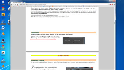

hey aoktar,
you can't tell me that in first ????
It's on your website man :D
That's why it's crashing, i need an 3rd additional graphics card if i want using my two TITAN in max powerful.
No ??
