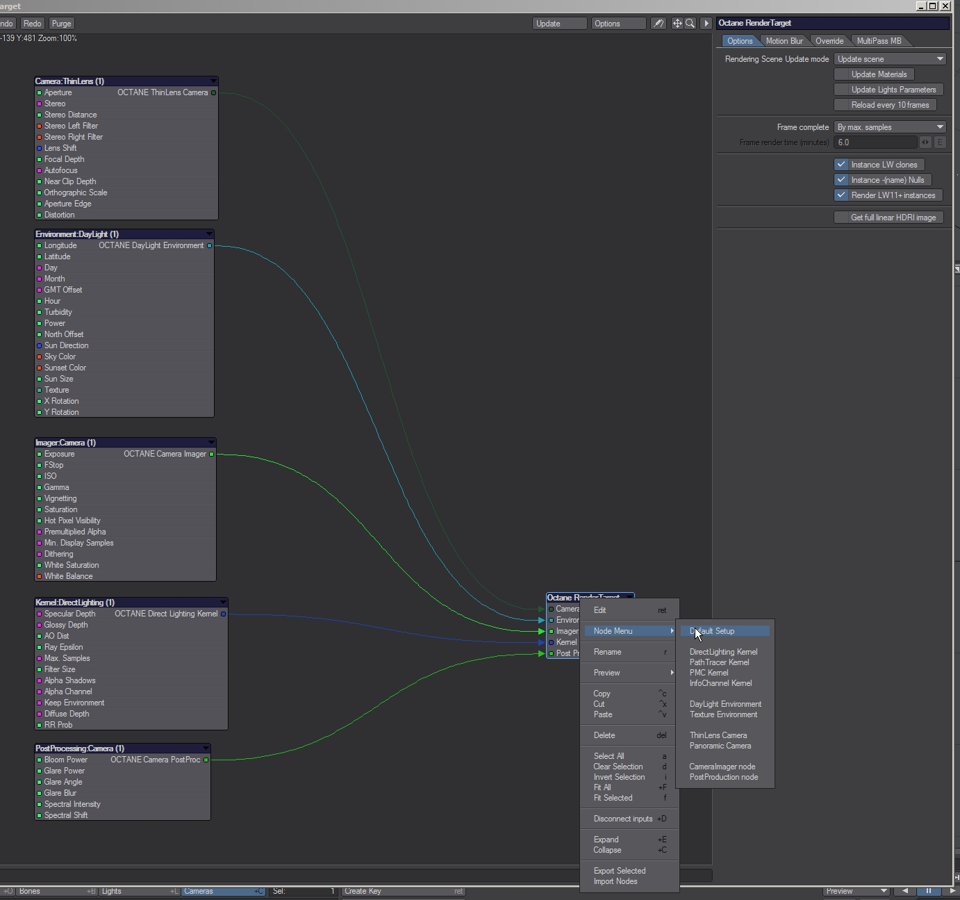

But to work in a real production scene you are going to need a full setup of the render target, with all the render target nodes ... without an imager node how do you configure your tone mapper, the exposure, the gamma and so on?
You should begin your projects with a default render target nodes configuration, like the one you get with the feature "default setup" that you can find in the root node tools menu. Without this setup a lot of rendering features are not available, or you can't adjust them.

You need to install the last daily build (version 2.6.1):Builtdown wrote:Thanks for the tips, Juanjgon!
How can I get the Default Setup in Render Target (as shown in your previous post)? When I right click on the Render Target Node, the Node Menu is greyed...
http://render.otoy.com/forum/viewtopic.php?f=36&t=40793
